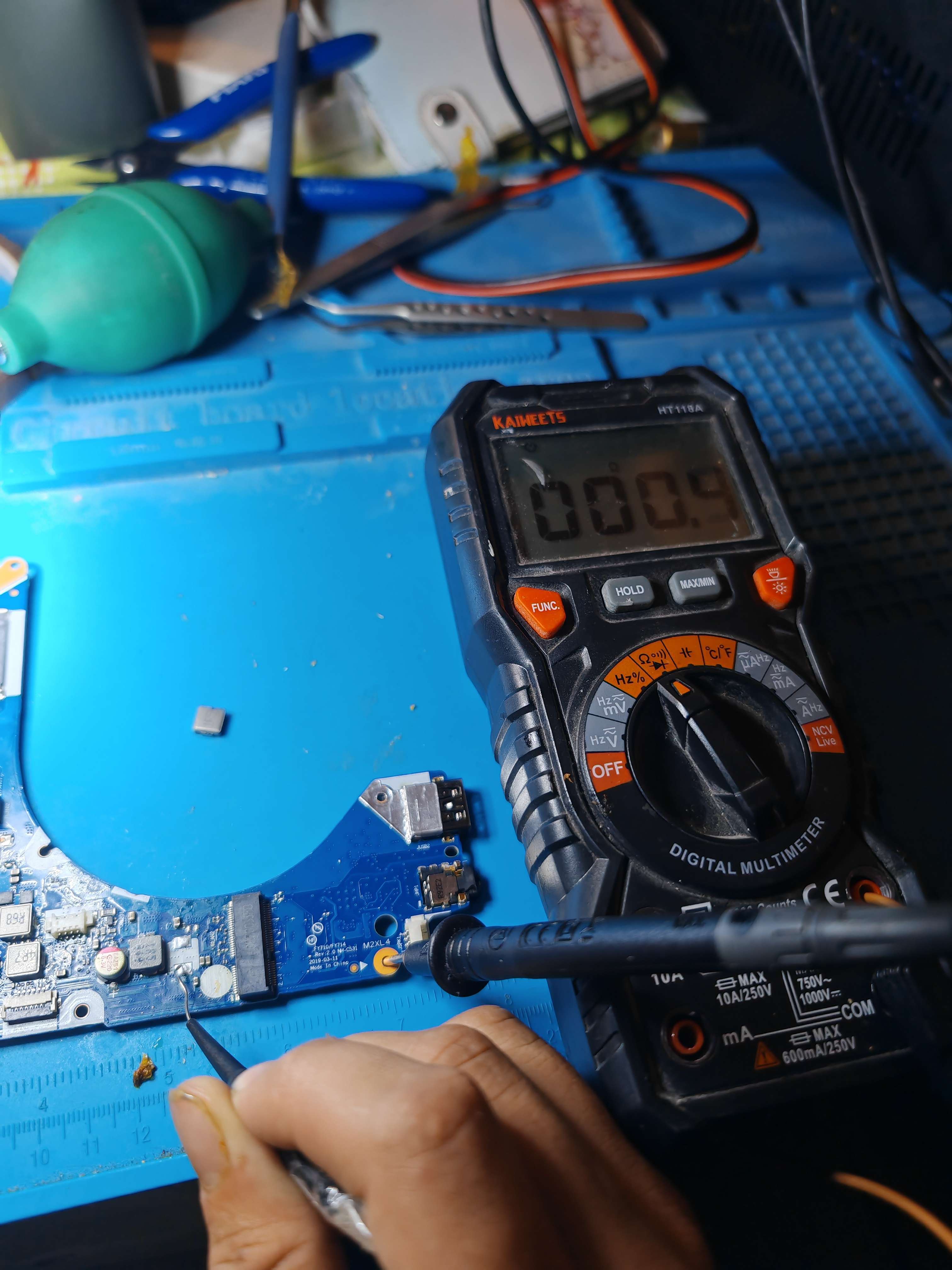

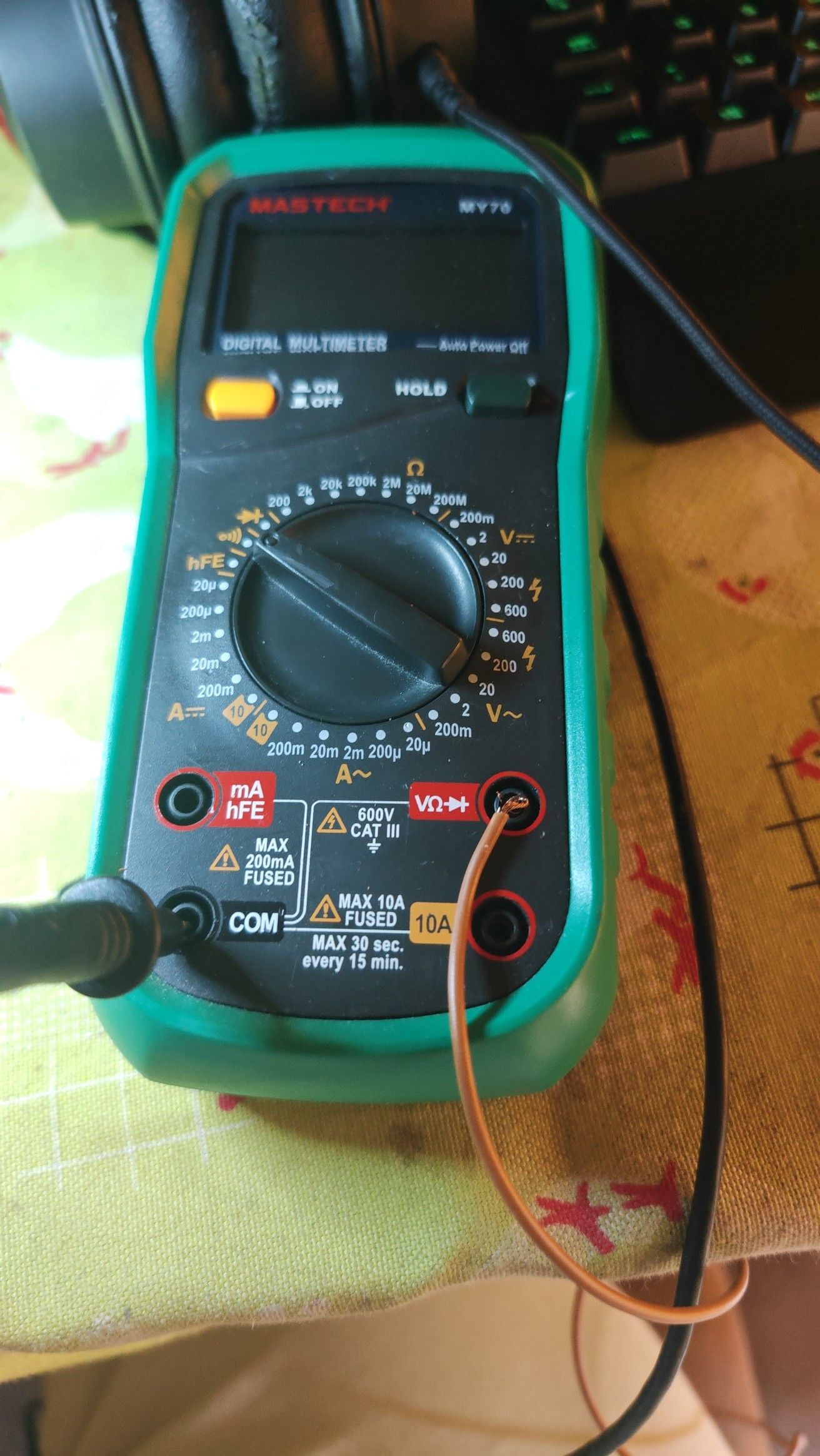

    Put the meter 2 clicks to the right onto the 200 scale to measure exact resistance .The buzzer on your meter will buzz at everything under 50 Ohms https://www.mastech-group.com/global/en/my70.html ,it doesn`t mean there`s a short.
    oh ok thanks ou very much, the brown wire is the red test lead ( i have a good pair of test lead but i forgot them i my dad's car and always forgot to take it back🤣 .So if i understand, i have to measure them with the ohms and give the number dispalyed ? if its correct, there is the results :

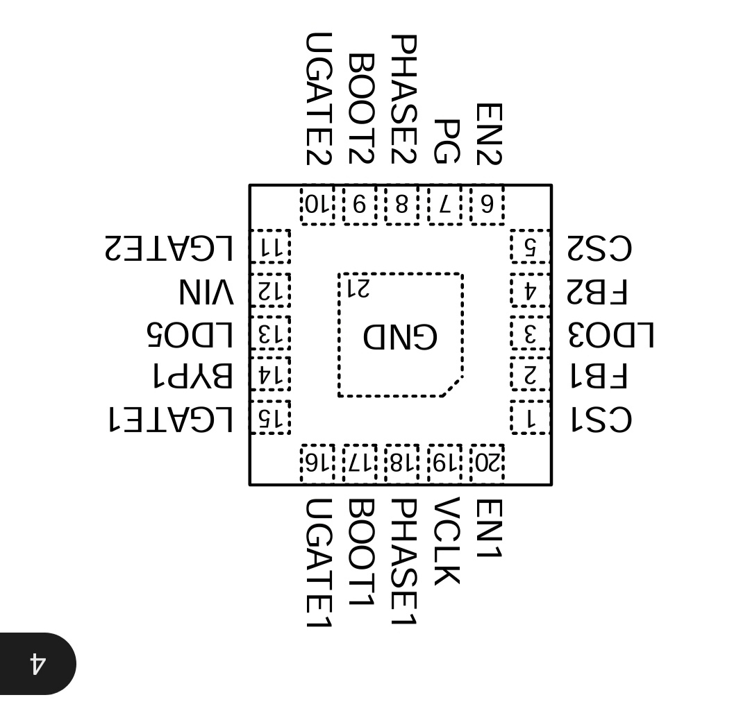

    Pin 3 = 03.0
    Pin 13 = 1 (OL ?)
    Pin 8 = 00.6
    Pin 14 = 1 (OL ?)​

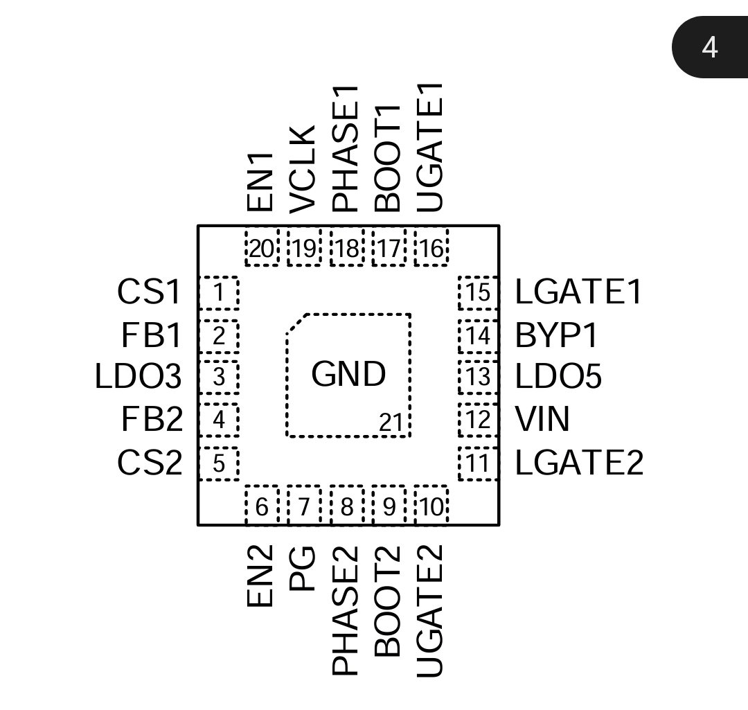

        Are you sure that you have counted the pins right right?
        However, if the measurements correct then we have definitely problems found. Voltage injection into LDO3 and LDO5 is the way to go from here.

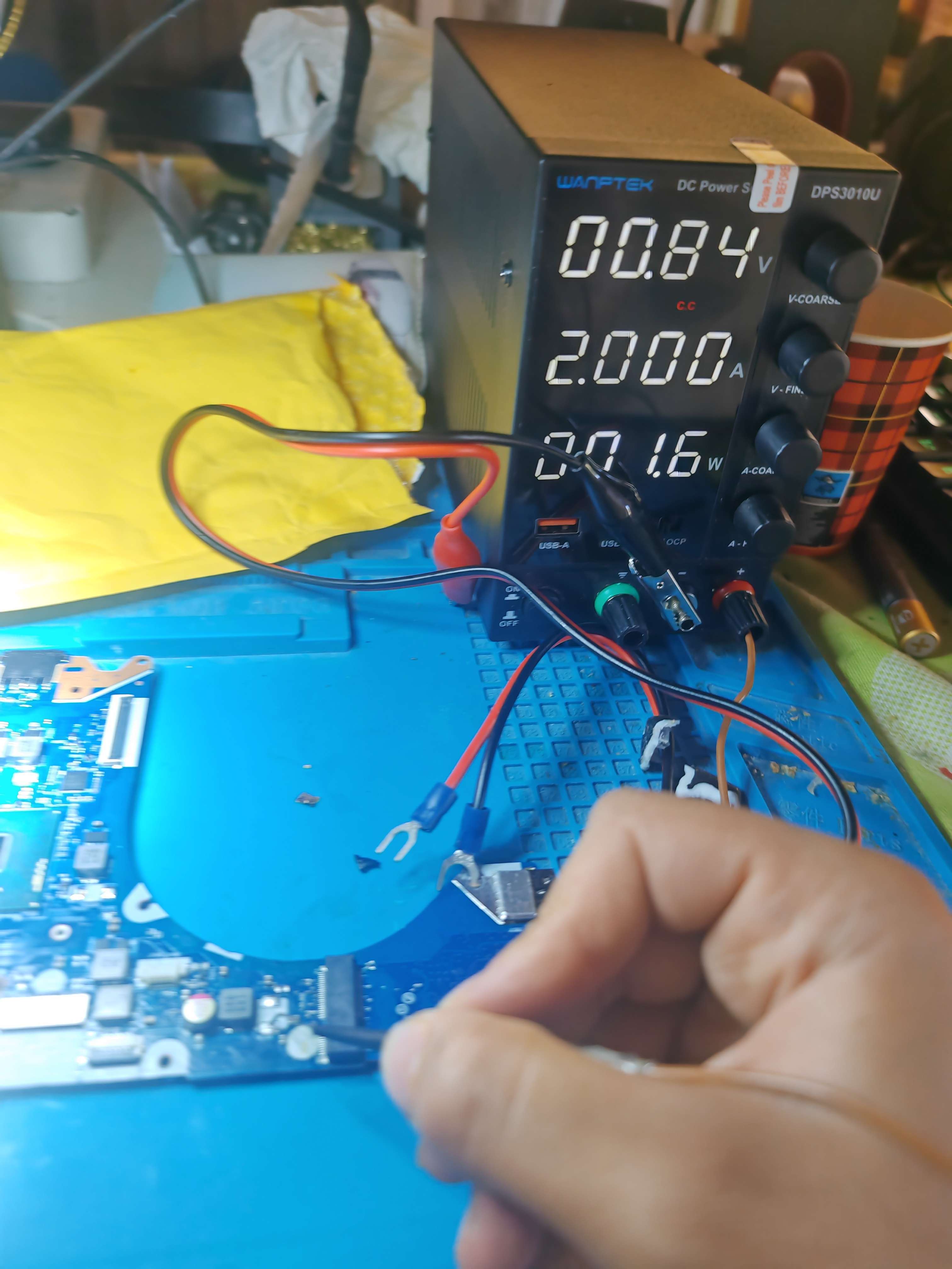

            Voltage injection, set your bench PSU to 1V 2A, connect the + on the point of interest, on the 3VL the solder blob PJ603 is a suitable spot to solder a wire, on 5VL is PC601, the GND you can use an alligator clip on a suitable spot like a screw hole

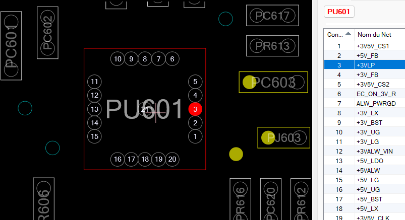

              No, i have this... its seems that i dont have the right shématics, with yours i have those values :
              Pin 3 = 1
              Pin 13 = 2.7
              Pin 8 = 1​
              Pin 14 = 1

                So, i have to inject 1v 2a here and here ? ( waiting in response to do anything )

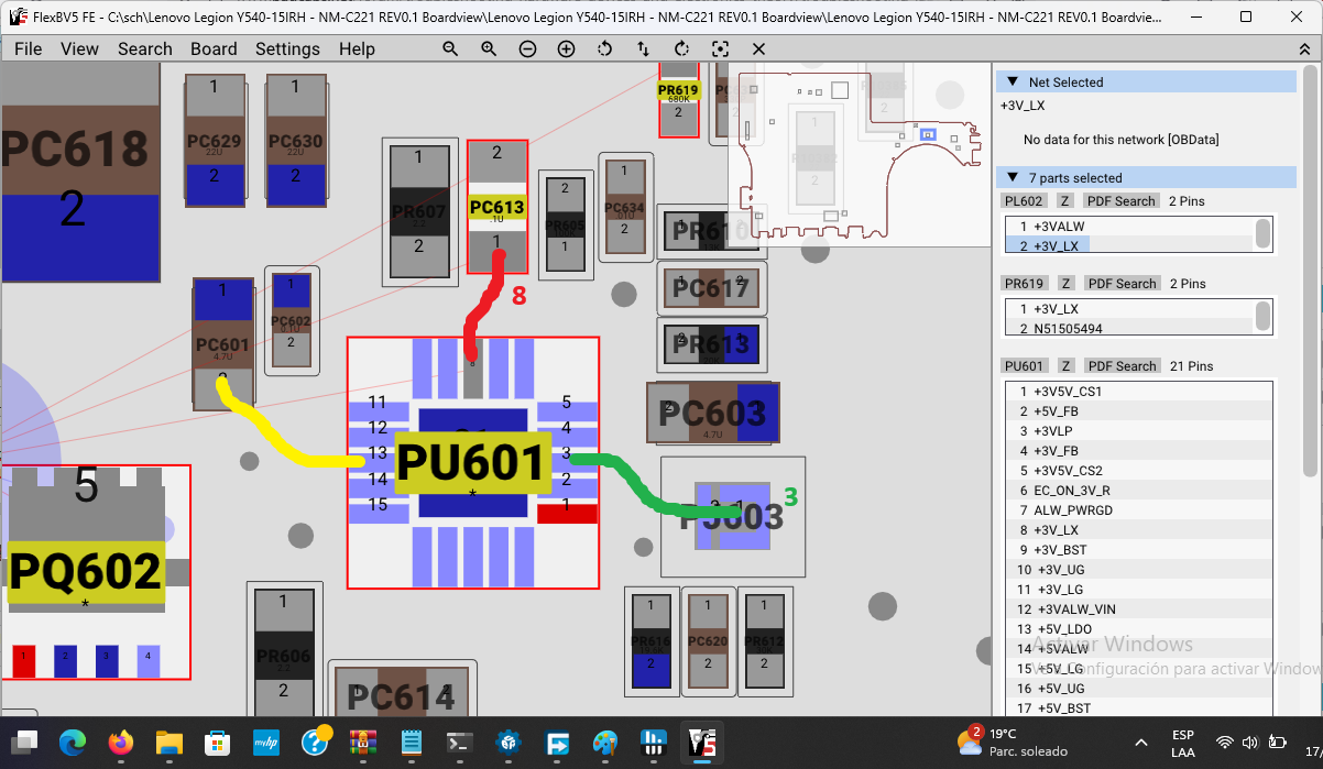

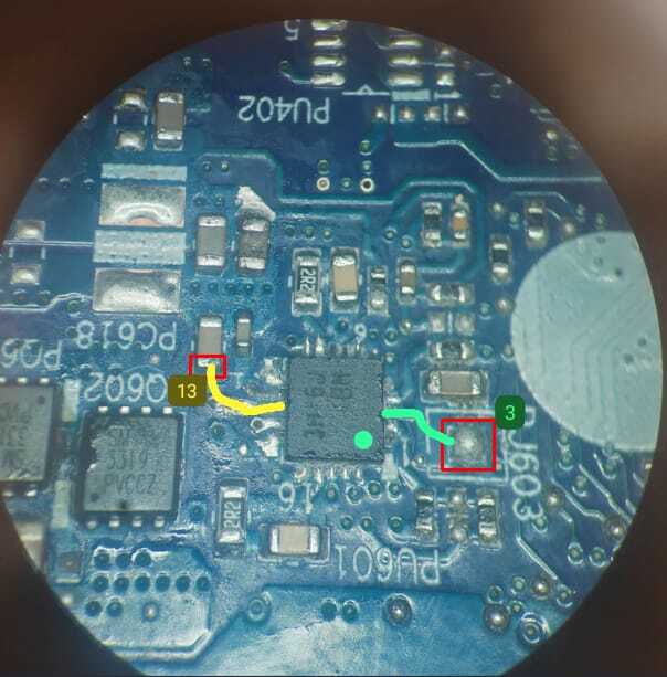

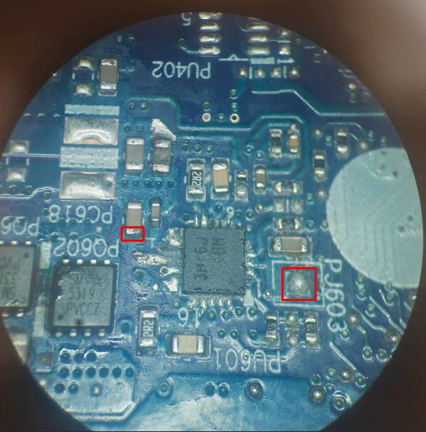

                  Just to make sure you're looking at the correct pins, pin 1 is marked with a dot (I placed a green dot there), then count counterclockwise, it's also marked on the board with a 1 and an arrow...
                  The picture posted by Sephir0th is correct and matches the boardview, you have to rotate it 180 degrees if you look at the chip orientation
                  Easier to measure at the points I marked on your picture, on the cap and the solder blob
Name:	pins 3 and 13.jpg
                  Once you confirm if it's just pin 13, or both pins 3 and 13 you can proceed to inject voltage on the shorted line

                    Oh thanks you very much, it make sense now so in this order its :
                    Pin 3 = 03.0
                    Pin 13 = 1
                    Pin 8 = 00.7
                    Pin 14 = 1
                    so i inject voltage on the green dot and also the yellow cap ? (3 and 13 ? ) (and between the gnd and the dot in question) and what i'm supposed to see ? what i have to do ? spay some isopropylic alchool ? see if it vape ? can something explode 😨?

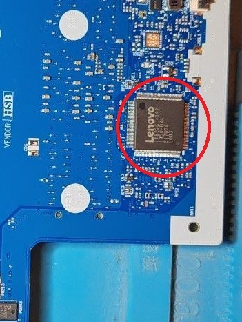

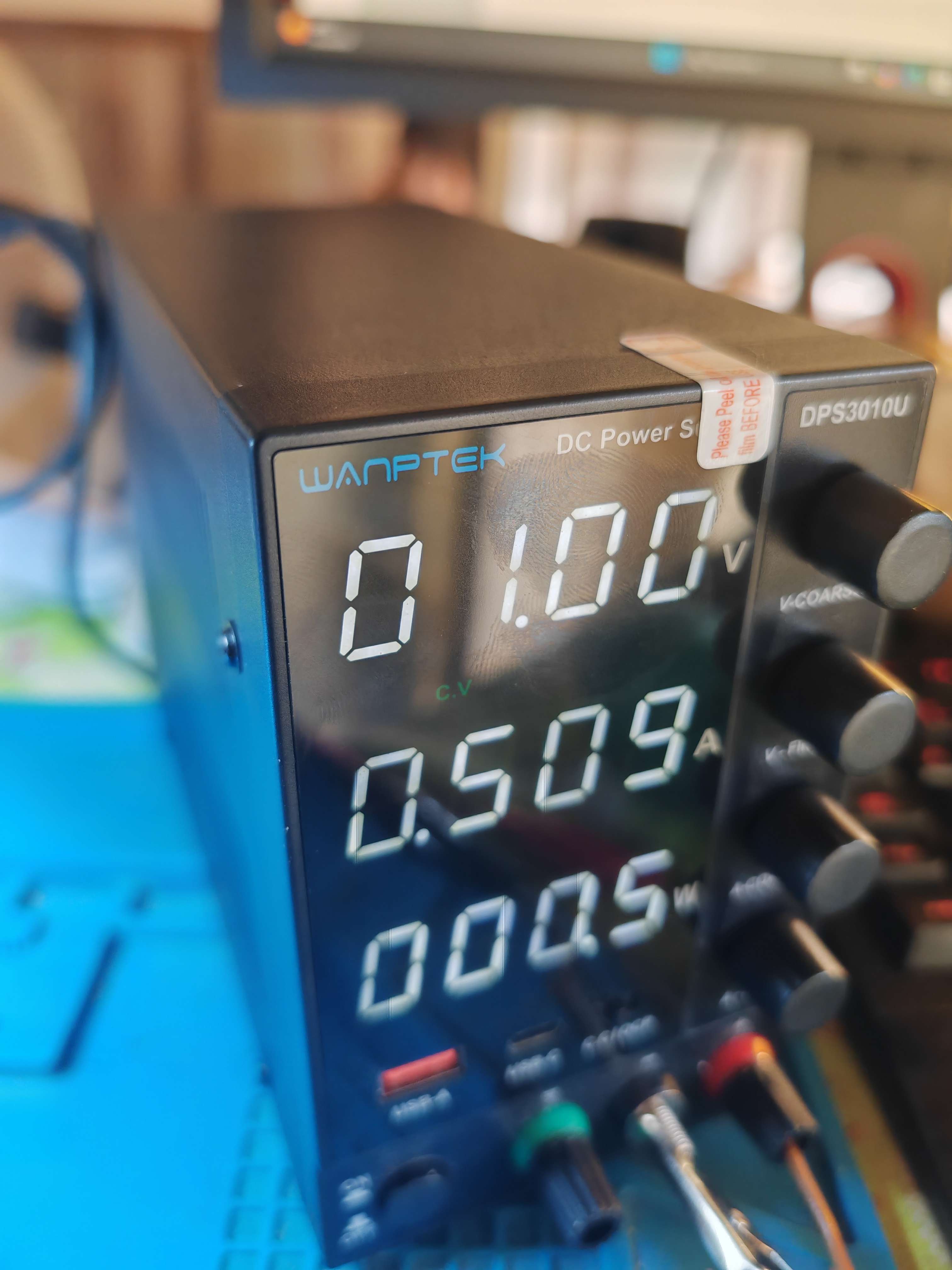

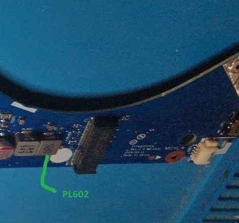

                      Now pin 13 is not shorted but the short is on pin 8
                      Start with 1v at PJ603, the only IC connected to it is the EC IT8226, add a drop of alcohol to it and see if it evaporates
                      If pin 8 is shorted, measure resistance to GND at PL602

                        i test it like this or between the pin 8 and pl602 ?
                        • Docus
                          • Jun 2025
                          • 32
                          • Lyon
                          #32
                          i cannot say if the alchool evaporate with the room temp or with the chip temp but i'll say that i don't see the difference bewteen the time i put the voltage and the time i put nothing so i thinks nothing happen
                          • m1ch43lzm
                            • Mar 2019
                            • 746
                            • Peru
                            #33
                            It's correct, as long as the probe is touching properly the GND, but now you don't have a short there (and there's no way you have a short on pin 8, since it goes to the other side of that inductor)
                            Also replace the battery on your multimeter, as it may give wrong readings

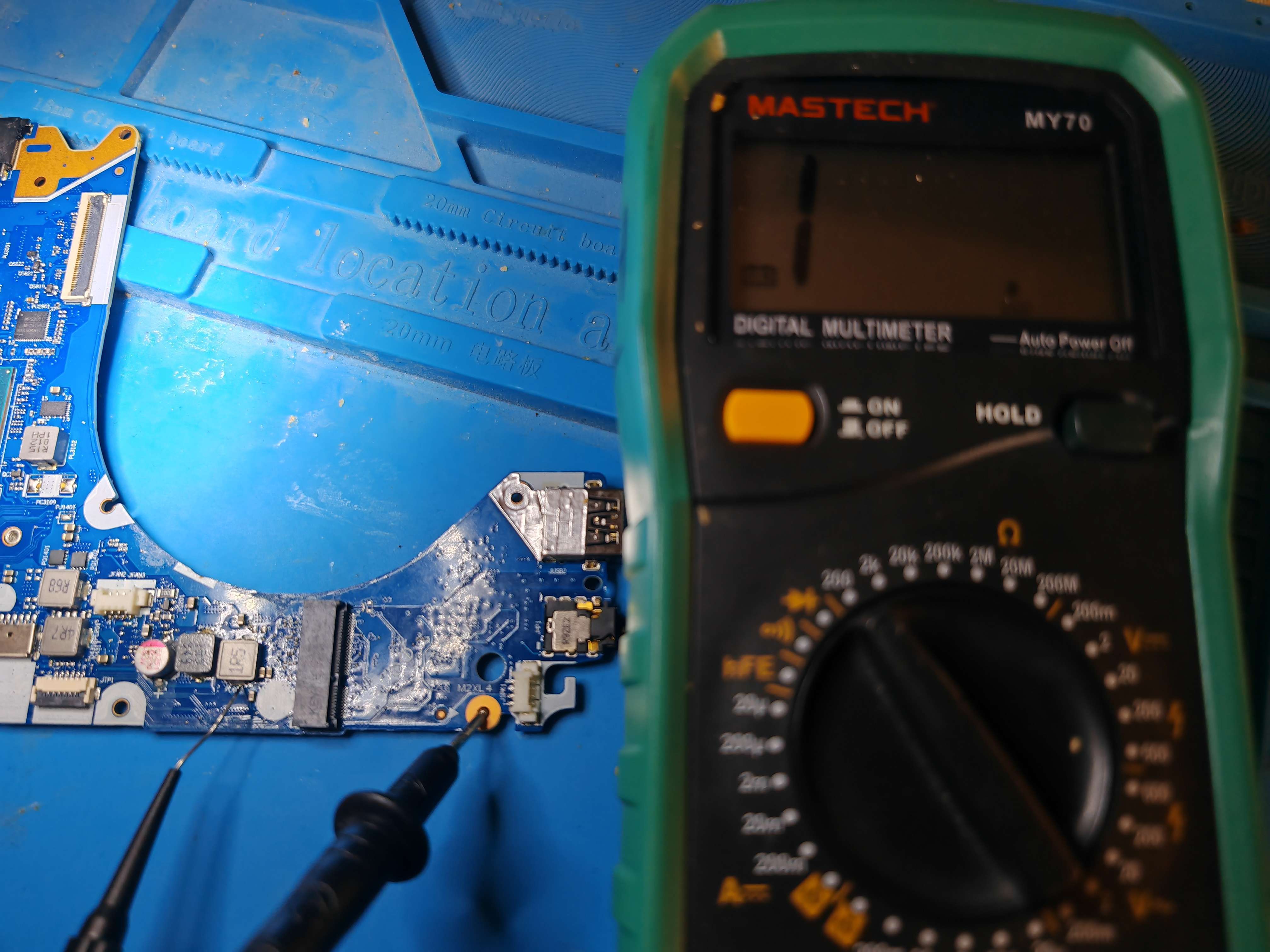

                              i don't have another battery bt i have another multimeter and it shows that :
                              pin 3 : 003.4
                              pin 8: 000.7
                              Pin 13: the value keeps rising
                              Pin 14: the value keeps dropping​
                              • m1ch43lzm
                                • Mar 2019
                                • 746
                                • Peru
                                #35
                                Have you checked if the alcohol evaporates here? Try increasing the voltage to 1.5v
                                Click image for larger version  Name:	it8226.jpg Views:	0 Size:	70.0 KB ID:	3661447

                                  i checked the lenovo chip and nothing happen , a also tried with 1.5v but also nothing.
                                  I remember that before i try to solder anything ,the rt658 was the only component that evaporate when i plug the charger and the last time i test it he doesn't do anything...

                                    #37
                                    I guess you could try removing PL602, or at least lifting one side of it, be careful not to melt the plastic connectors, then check if the short to GND on pin 8 of the RT6585 disappears
                                    If that's the case, measure resistance to GND on either side of PL602, then inject voltage on the side it shows the short

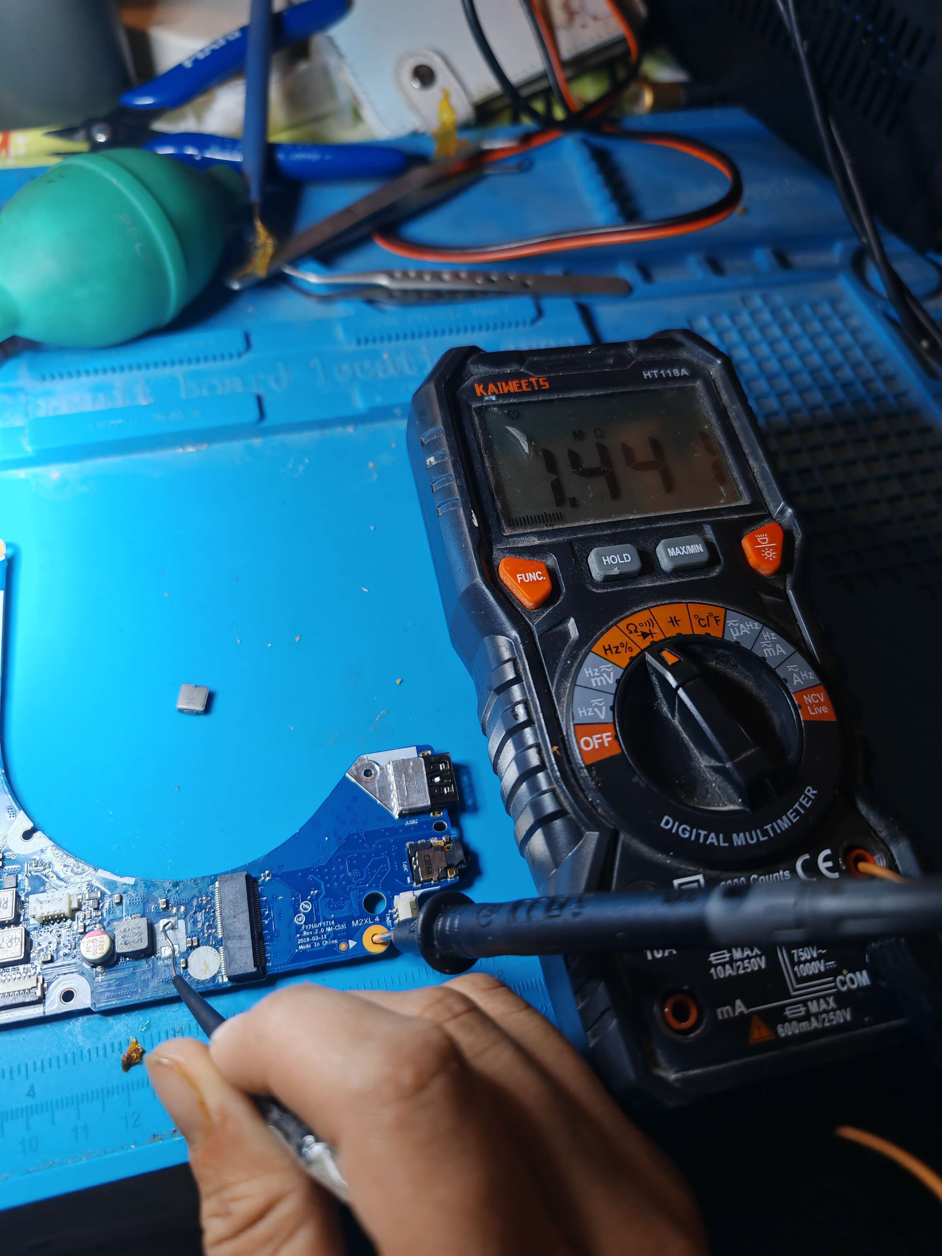

                                      so, i remove the pl602 and on one side i see 1.441 and on another side i see 000.4 so i think the short is in the RT6585 side
                                        That side with the 0.4 is the output after the inductor, not on the RT6585 side, solder a wire on the shorted side from.your bench PSU and do the voltage injection, start with 1V 2A
                                        Check what gets hot, hopefully not the PCH as it would mean the end, replacing a PCH requires an expensive BGA rework station
                                        May be also the IT8226 this time, I don't know if it has to be programmed first by an external programmer (expensive), or if the motherboard can program an empty/new EC, some boards do, some don't
