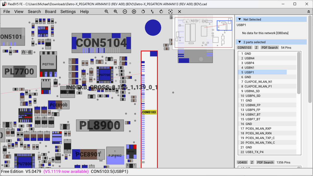

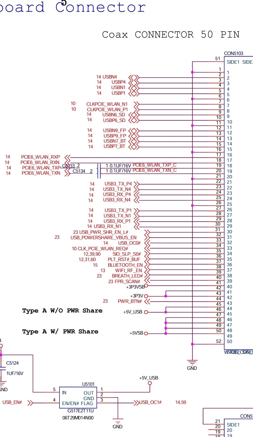

                Schematics and boardview here https://www.badcaps.net/forum/troubl...-and-boardview
                Relevant part of the schematics
                On the first 10 pins of the connector
                USBP4 USBN4 go to one of the USB ports on the I/O board, USBP1 USBN1 go to the other USB port, those data lines are used for USB 2.0, the USB 3 data lines are separate
                Unfortunately they go directly to the CPU/PCH, unless the failure point is on the 50 pin connector on the motherboard side
                Same for CLKPCIE_WLAN_N1 and CLKPCIE_WLAN_P1, straight to the CPU/PCH, I'm suspecting those pins as they're near the affected USB pins
                There's also the USB data lines nearby which go to the SD card reader, fingerprint sensor and the Bluetooth portion of the wifi card
                Measure in diode mode those pins, on the motherboard side 50 pin connector that goes to the I/O board

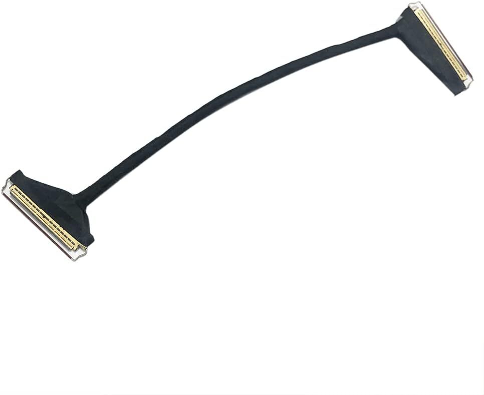

                Still we don't know what's that "serial cable", is it the 50 pin cable that goes from the motherboard to the I/O board?
                  Sorry for the misunderstanding about serial cable. Yes it is the 50 pin cable.
