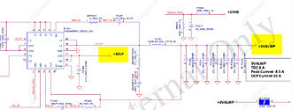

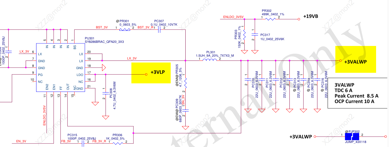

                      From pins 17 & 18 on PU301 - the +3VALWP is shorted.
                      Locate a solder blob @ PJP302. This blob shorts +3VALWP to +3VALW. Remove this solder short and then measure the resistance to ground on PL301. No power to the board during this test. Is PL301 still 10R9 ohms to ground?

                          So the regulator is not shorted but downstream consumer side is. Measure the resistance from the solder blob to the pch 3v3 rail. The pch uses the same power rail. It is possible the cpu is dead from this event but to be determined.

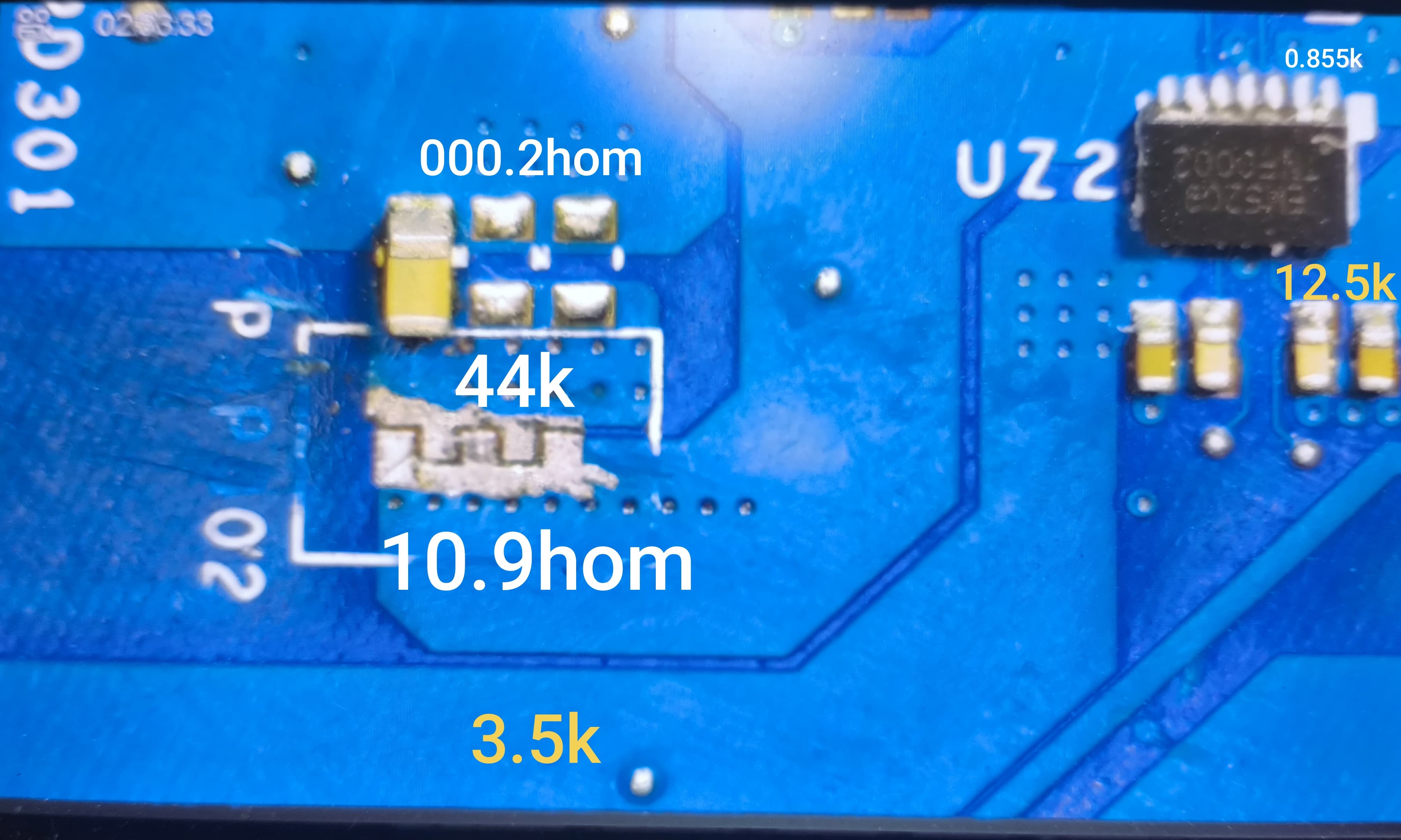

                              Pour some alcohol on the top surface of UZ2. This will enhance the markings. Then take a clear pic of the top surface. What are the markings? The very large PCB traces hints that the same rail is being shared by a device that consumes heavy currents. Where does this area lead to?

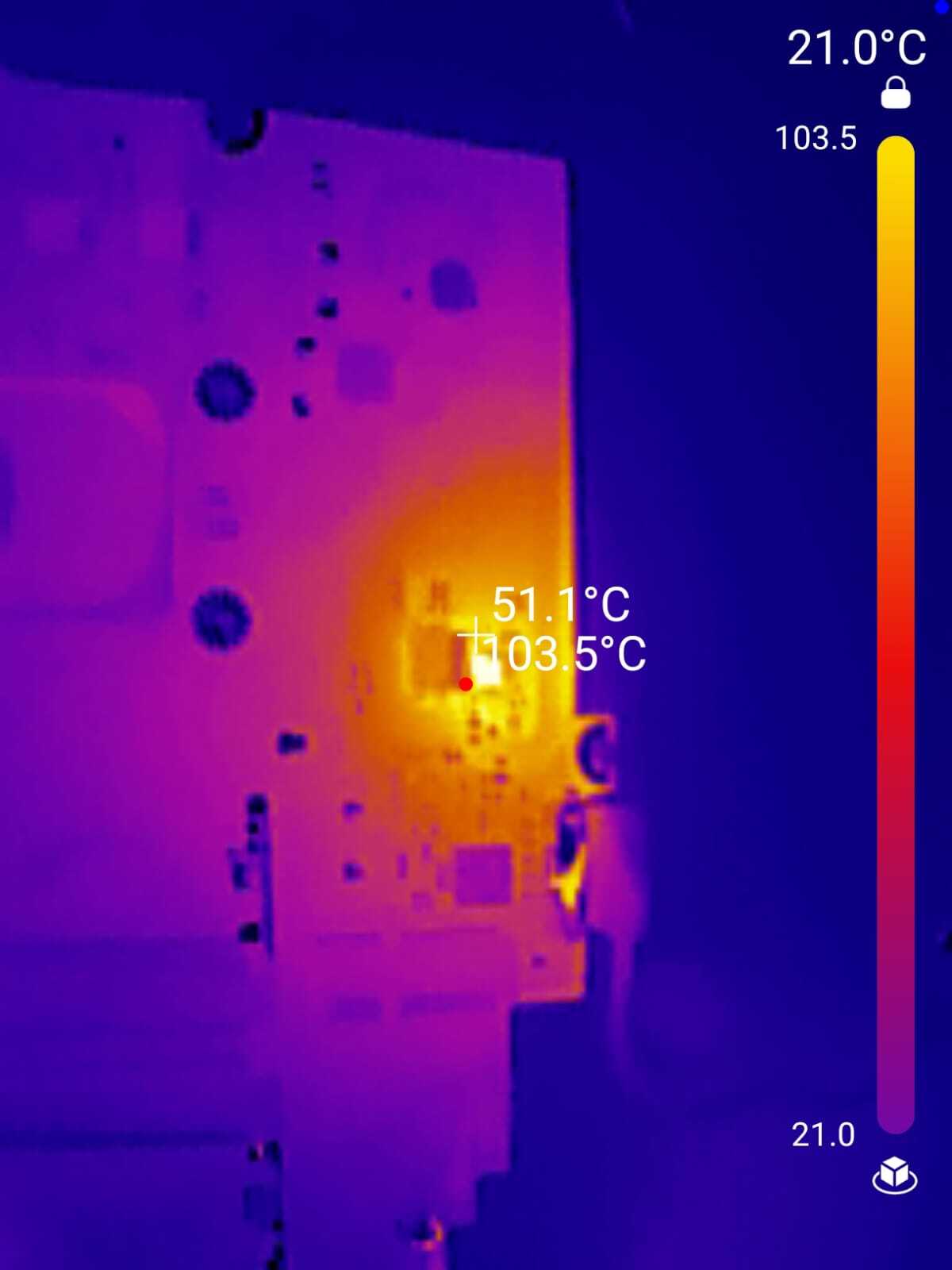

                                PU301 overheats

                                  If PU301 is overheating, remove all power. Meter in resistance mode. Measure the resistance to ground of each output rail on this device.

                                      Can you confirm if the solder blob @ PJP302 is open or is it closed with solder?
                                      • teccyber-lab
                                        • Apr 2025
                                        • 25
                                        • BRAZIL
                                        #39
                                        close

                                          Open this solder blob and confirm if the short remains on pins 19 & 20.
