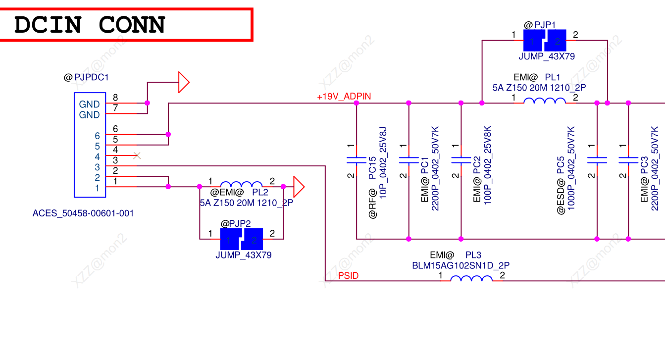

            same thing, going to need the laboardview of this machine and all the information I can get. I'm afraid it's one of those elusive failures that break head. I'm already starting to take values to see where this takes me.
            • mon2
              • Dec 2019
              • 14727
              Remove all power. Meter in resistance mode. Measure the resistance to ground of the PSID (power supply ID pin) on the DCin connector. You can also measure @ PL3 to ground.
              What is the resistance? We are testing if the TVS diode is defective that is used to suppress transients on this communication line.

                okay PSID to GND = 115k
                on PL301 =2050k

                    Connecting the multimeter cables gives a different reading on the two components you requested, which are as follows
                    PSID to GND = 68k
                    PL301 to GND = 5000k

                      Measure the resistance from the PSID pin of the DCin connector to each side of PL301. This must be ~0 ohms. If it is not, you are not on PL301 or PL301 is defective.
                      If you are confident that you are measuring on PL301, then use a piece of wire to bridge and bypass PL301. Then test the resistance again and it should be ~0 ohms. Then test your adapter again.

                        PSID pin on DC in conector to each side of PL301 (RIGHT SIDE124k) (left side 124k)
                        PL301 its two terminals 0.2hom

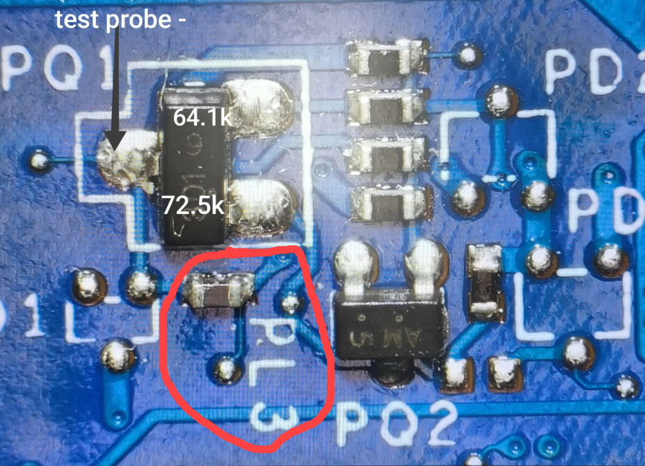

                                    some information add

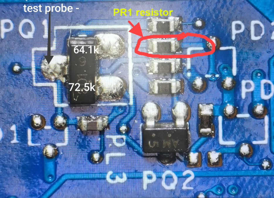

                                      Bad boy PL3 is in the attached location.

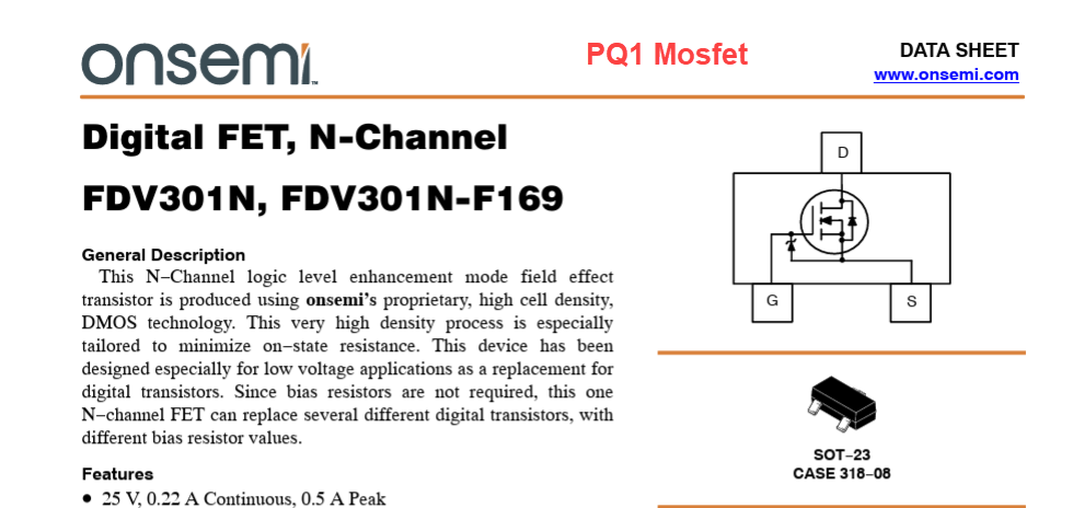

                                      Attached is the pinout of PQ1 N-channel mosfet.
                                      Measure the resistance between
                                      source / drain
                                      source / gate
                                      gate / drain
                                      Post each measurement. We are testing if this mosfet is defective or not.

                                        Another common point of failure is the series resistor @ PR1 = 33R ohms (normal). Often this resistor will be much higher in resistance and raises issues such as yours.
                                        With no power to the board, measure the resistance across PR1 resistor.
