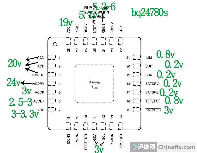

              Click image for larger version  Name:	IMG_4748.jpg Views:	0 Size:	44.5 KB ID:	3647218
              Which mosfet was used for the replacement? With no power, share the same resistance checks for this new mosfet.
              Then, attach the power adapter and carefully measure the voltage to ground for the following pins:
              Using BQ24780S as reference which is with the same pinout -
              REGN
              VCC
              ACDRV
              ACOK
              Also ACDET.

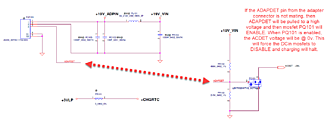

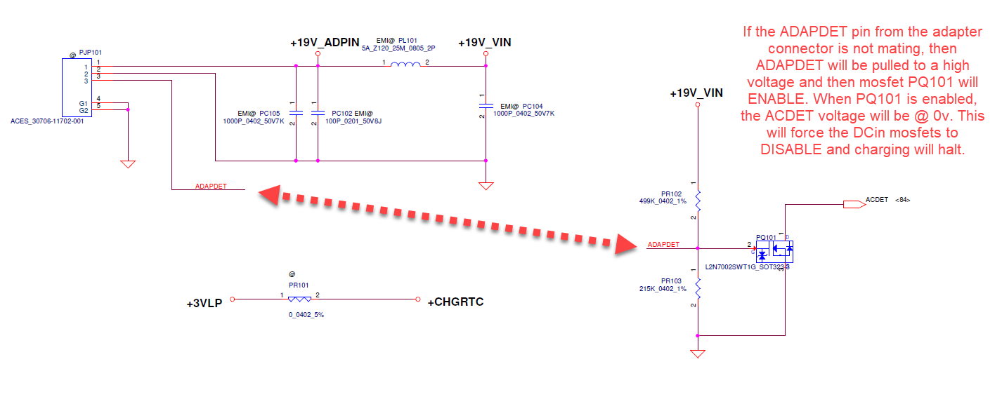

                As per post #5 - confirm the attached which may be the root cause. We have seen this a few times on this forum.
                In summary - the ADAPDET pin on the power connector is failing to provide the 0V or GROUND. Respectively, the ACDET voltage is then pulled to ground due to the mosfet @ PQ101.
                As a test, you can connect a piece of wire to the gate pin of PQ101 to GROUND which will force PQ101 to DISABLE. Then ACDET should follow a voltage suitable to enable the mosfets.
                Click image for larger version  Name:	adapdet.png Views:	0 Size:	78.4 KB ID:	3647314

                  Thanks for the advice, by putting pin number 2 of the PQ101 to ground the PC started working again. Can I leave it like this? Or could it cause problems?
                  • mon2
                    • Dec 2019
                    • 15439
                    You can leave this wire jumper and use the laptop like normal. The root cause is as noted by mcplslg123, the dcin power adapter connecter is likely loose for this pin that should have pulled this mosfet gate pin to ground.
                    The manual wire jumper now performs the same task.

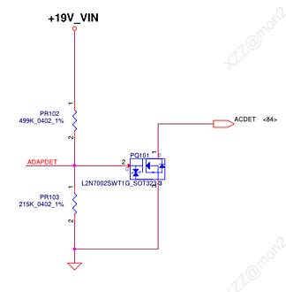

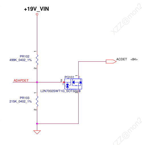

                            alex26 - same motherboard? LA-K093P
                            The board will not power on with the OEM power adapter? I recall similar other posts on this forum with this fault.
                            Locate mosfet PQ101 (3 pin device). Measure the voltage to ground of ACDET with the power adapter connected. Suspecting it will be 0 volts.
                            Then measure the voltage to ground of pin #2 = gate pin on PQ101. Suspecting this will NOT be 0v. Share the feedback.
                            Summary: The dcin power connector, when it is working properly, will pull DOWN the voltage on pin #2 of PQ101. This low voltage on gate pin will turn PQ101 OFF. When PQ101 is OFF, the ACDET will be a positive (ie. not zero volts) to the battery charger.
                            Believe at this time that the gate pin is floating from the DCin power connector so the PQ101 is ENABLED using the voltage divider resistors on the gate pin. This pulls ACDET to zero volts so the battery charger IC believes no power adapter is attached and fails to charge the battery.
                            Assuming this all to be accurate - flux and remove PQ101 mosfet. This should allow for ACDET to be a positive and valid voltage to enable the battery charging (provided the battery is not too old and dry).
                            Click image for larger version  Name:	PQ101.png Views:	0 Size:	24.3 KB ID:	3719066

                              It s the same motherboard. I did this, I have 2.9v on the ACDET pin. Now the laptop starts completely, I have all the voltages but it shows Critical low battery on the display,and than off. If I inject voltage into the battery it doesn't charge
