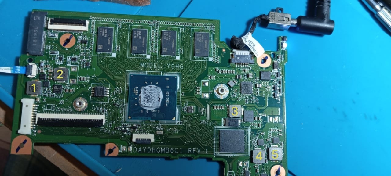

    Hello, there!
    The problem with this laptop is that it does not show video at all, even if I connect an external HDMI screen device to its port.
    I got it disassembled, and first of all it does have its VDC in (19.81). I checked the 5 inductors having the charger plugged in, and the voltage readings are:
    TURNED OFF (without pressing the power button)
    1: 9.07 VDC
    2 to 5: 0 VDC
    TURNED ON (after pressing the power button)
    1: 9.04 VDC
    2: 1.203 VDC
    3: 0.813 VDC
    4: 3.403 VDC
    5: 5.133 VDC
    I'm not quite sure if the reading of the third inductor is fine or not. Hope you guys can guide me on this. I don't know what else to check.

      Measuring voltage on coil is not sufficient for no display issues, you need to dig a lot deeper.
      M_A_DRAMRST# present?
      Bios flashed?
      Schmeatic is available in this forum-so start digging .

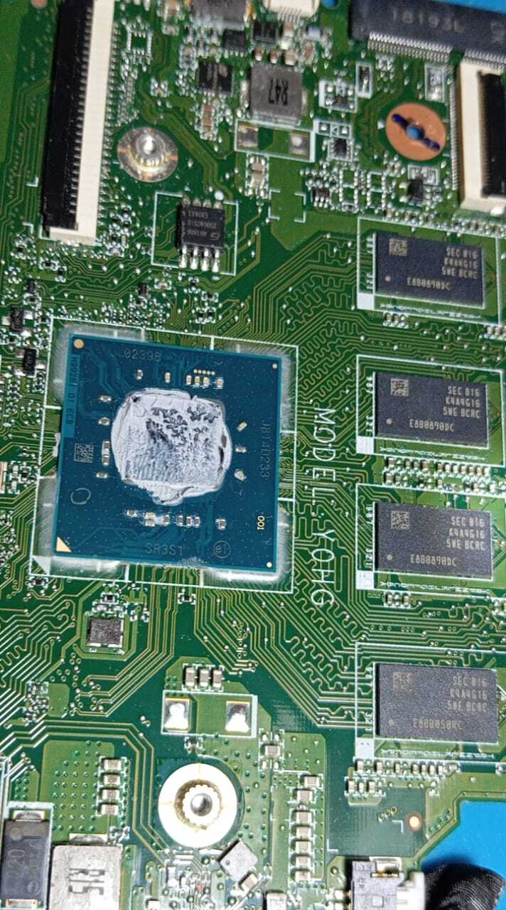

            There's no memory modules on this model, it's soldered chips.
            • mon2
              • Dec 2019
              • 14659
              The soldered ram chips will also feature a reset line. The '#' suffix denotes that the signal is active LOW. This means when the line is LOW, the target device is parked in the reset state. To run normally, the same line must be released to the logic '1' or high state and is often ~3v3.

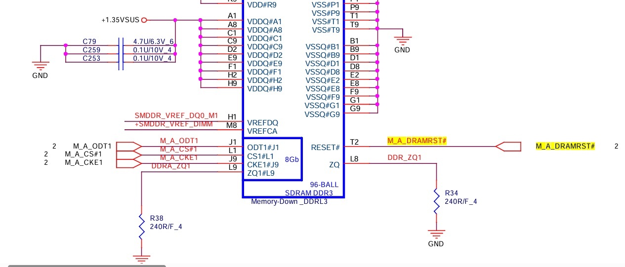

                    Took a screenshot from the schematic where it shows one of the memory slots plus a small rectangle with 4 pins at the bottom, which I suppose it corresponds to the soldered chips I have (4 at the front and 4 at the rear); each one of them of 8 Gb, as you can read in the picture. Also, I'd like to share a picture of the mainboard so you can help me where I should check those lines you previously said? I can notice some check points there, and also the printed numbers 1,2,3 and 7,8,9, by the chips.

                      Correction to post#7-It is often 1.35V for DDR3-L and 1.2V for DDR4 and not 3.3V

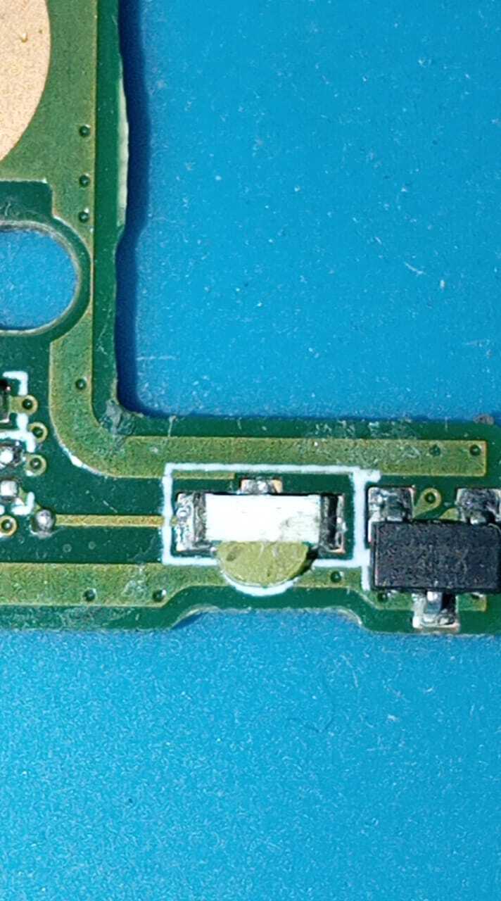

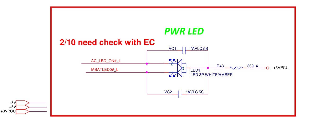

                                Been looking for the boardview, but can't find it; I need to check some areas with no voltage by two of the inductors.
                                After the BIOS flashing process, the problem got worse since now the power led is dead. Since it has two LEDs (amber and white), I tested both using a multimeter on diode function, and it only lit the amber one (the positive lead on the pin 3 and the negative on the pin 1). Did the same with the white led (the positive lead on the pin 3 and the negative on the pin 2), but it does not light up. In both cases, the voltage measured was 1.8 vdc. However, if I check the diodes independently, both have .490 vdc. Even though, when I plug in the charger it does not show the white led. Strange. I wonder how that LED went bad after flashing the BIOS.

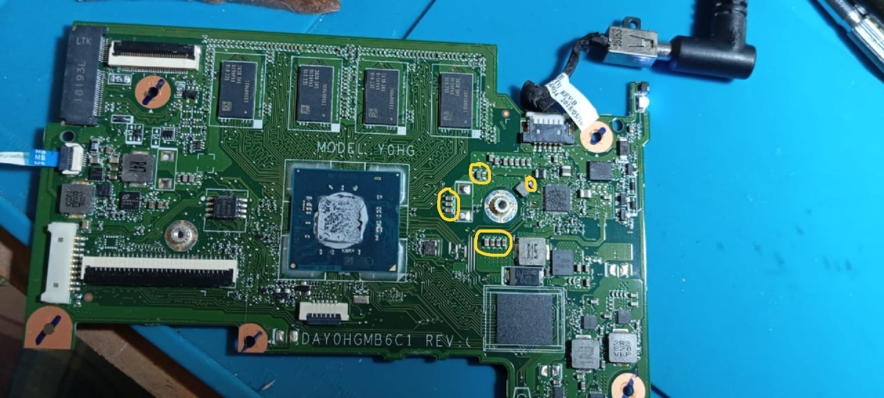

                                    Checking the mainboard more closely, I could detect a few capacitors shorted. I don't have experience with fixing computers on a component level, so I wonder how should I proceed in order to find the responsible for the short.
                                    • mcplslg123
                                      • Jun 2015
                                      • 7262
                                      • india
                                      The circled caps are not likely shorted . They are part of cpu vcore circuit and low resistance to gnd is expected there.
