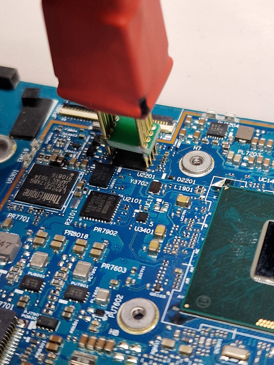

    I'm having a hard time dumping the BIOS of a Lenovo Ideapad Duet 3 (11IAN8). The chip is a Winbond W25R256JVEN, directly soldered to the board in a WSON8 package.
    Since there are lots of tiny components near the chip, I was hesitant to desolder it using hot air. Instead, I soldered thin wires directly to the chip's pads and connected them to a CH341A programmer (photos attached).
    The chip is detected correctly in both NeoProgrammer and ASProgrammer, but I'm unable to get a consistent dump. I've tried over 15 times — shortened the wires to under 10 cm — but the resulting dumps always have different MD5 checksums. I also performed the 3.3 V mod on the CH341A beforehand (following the common guide) to ensure safe voltage levels.

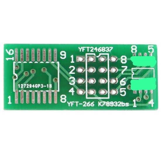

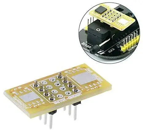

        I suggest to desolder the chip and place it on a WSON8 to DIP8 adapter board, as there may be other components also powered from +3.3v on the board
        Click image for larger version  Name:	wson8 adp.webp Views:	0 Size:	15.0 KB ID:	3638297

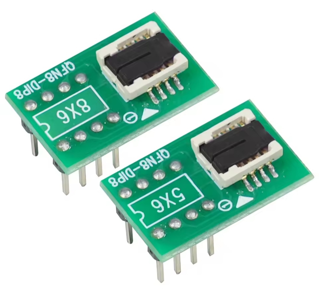

        Or this one, you don't need to solder the chip to it
        Or if you already have a SOP8 adapter, you can cover with UV solder mask the exposed traces on the inside, like this, as the WSON8 package has an exposed ground pad
        Click image for larger version  Name:	sop8 mod.jpg Views:	0 Size:	21.5 KB ID:	3638301

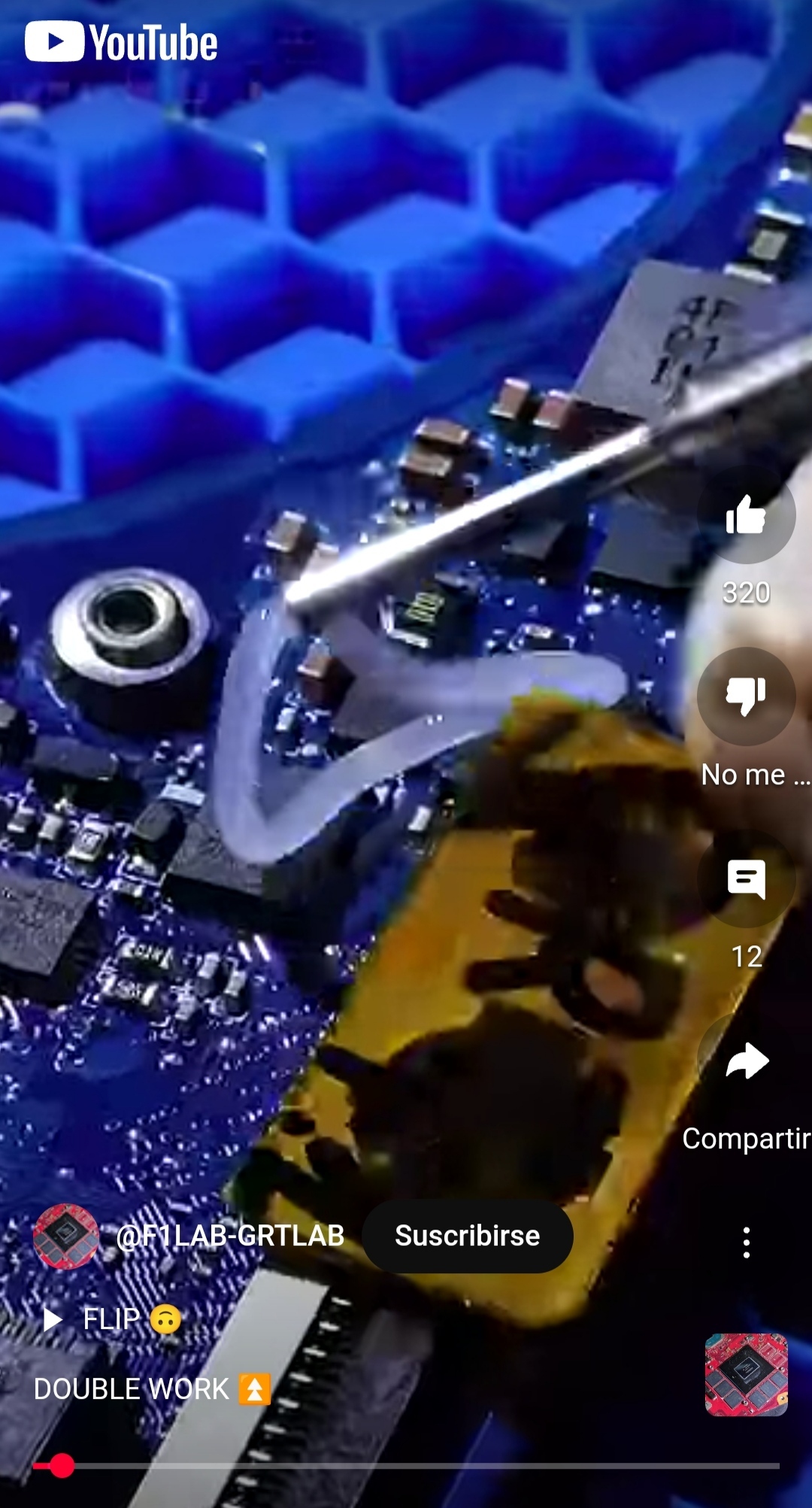

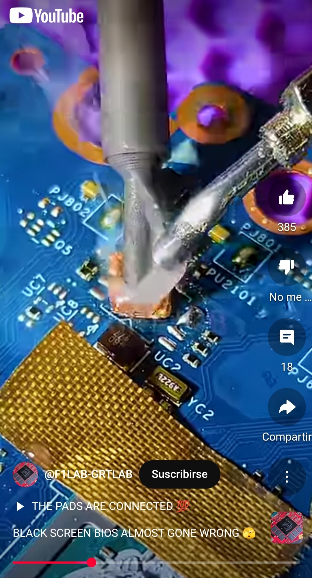

                      You need to worry about the plastic connectors nearby as they will get melted, and the CPU, you don't want to heat it too much (also notice the black glue/epoxy/whatever that Lenovo likes to use on the corners of the CPU/RAM/GPU)
                      I saw a video of someone using PTFE high heat adhesive tape, like the one used for heat sealing plastic bags
                      Click image for larger version  Name:	IMG_20250516_071612.jpg Views:	0 Size:	658.6 KB ID:	3638509
                      Another idea is to make shields out of soda/beer/(insert favourite drink) cans, not 100% sure what he used, maybe copper sheet bent to shape
                      Click image for larger version  Name:	IMG_20250516_071643.jpg Views:	0 Size:	516.1 KB ID:	3638510
