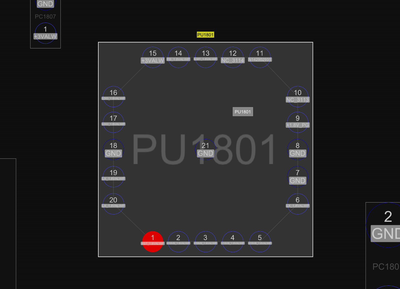

                                #35
                                thanks you very much but when i make short of +3VALW so that i think it the end of life kkkkk
                                i remove PU1901 but when i plug battery, plug charger and press power button so it make PCH blew up
                                replace PCH maybe so hard for me so well maybe i will sell it
                                Click image for larger version  Name:	image.png Views:	0 Size:	132.9 KB ID:	3627235
