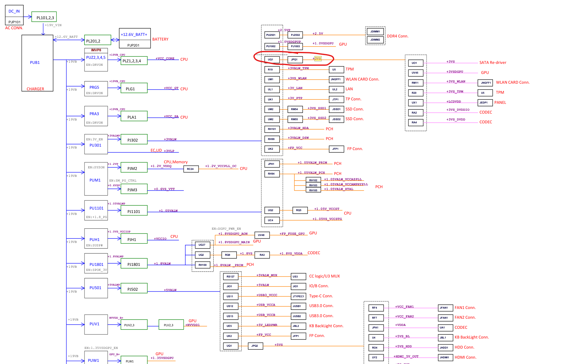

    Hi
    i using Acer Nitro 5 AN515-57-51G6 and my laptop geting like below
    so when i plug battery or power cable ( not press power button) in this componet ( mainboard name UT4 ) getting hot.
    what should i do to diagnose the condition ?

    *Update: the UT4 componet is JHL8040R ic
    • mon2
      • Dec 2019
      • 14659
      Hot or warm? Are you able to measure the temp of this part?

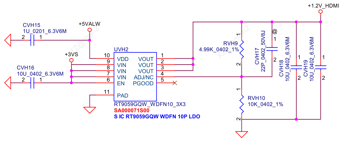

                  CVH14 is +1.2V_HDMI.
                  +1.2V_HDMI rail is an output from LDO @ UVH2.
                  Confirm the VDD voltage which should be +5VALW.
                  Also VIN voltage which should be +3VS.
                  • nhe quan
                    • Apr 2025
                    • 35
                    • Vietnam
                    Thanks you very much
                    Confirm the VDD voltage which should be +5VALW. > plug AC in and measure VDD is 5V​
                    Also VIN voltage which should be +3VS. > plug AC in and measure 0V, measure in CVH16 too is 0V

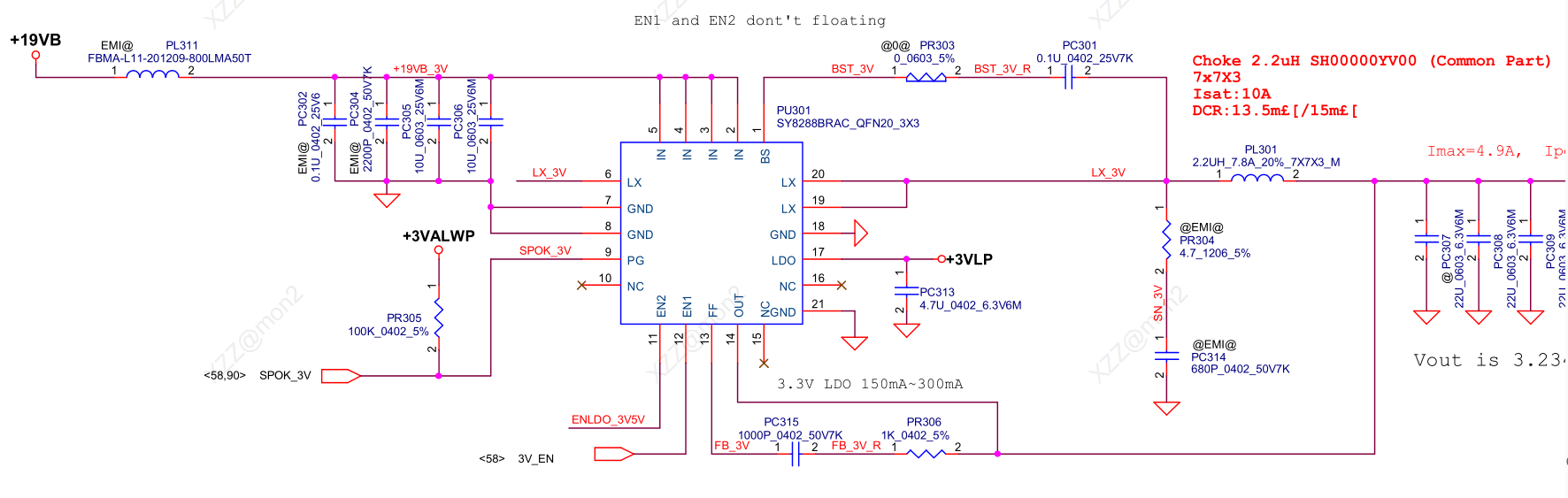

                          mon2 my condition relate to PU301 and should i remove that to check the 3VALW
                          • mon2
                            • Dec 2019
                            • 14659
                            If you are missing +3VALW, check:
                            - the resistance to ground @ PL301 - if the resistance is too low then there is a shorted part on this rail
                            - confirm if you have the enable signal @ 3V_EN (pin 12) - this signal enables the +3VALWP rail = +3VALW
                            - confirm if you have the enable signal @ ENLDO_3V5V - this signal enables the LDO regulator inside of PU301 on pin # 17 = +3VLP
                            When checking resistance, remove all power & no battery.

                              My result:
                              - the resistance to ground @ PL301: measure with 2000 and it so aroud 400
                              - confirm if you have the enable signal @ 3V_EN (pin 12) : 0v
                              - confirm if you have the enable signal @ ENLDO_3V5V : 3V
                              • mon2
                                • Dec 2019
                                • 14659
                                3V_EN (pin 12) : 0v
                                Driven by the EC @ UB1. Confirm the VCC voltage of +3VLP_EC @ LB1. This voltage is required to power the EC so it can provide the 3V_EN signal to enable the voltage on PL301.
                                If the voltage on LB1 is missing, confirm the voltage to ground of +3VLP on pin 17 of PU301. This must be present since the ENLDO_3V5V : 3V = enable the LDO rails.
                                If the voltage on PU301 is missing, remove all power -> measure the resistance to ground on pin 17 of PU301. If there is a low resistance, then something is wrong. It is possible that PU301 is defective if pin 17 is without a stable voltage.
                                Resistance to ground of PL301 is ok and not a short.

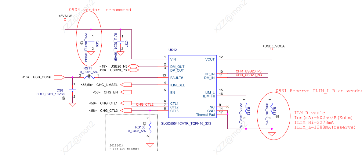

                                    • nhe quan
                                      • Apr 2025
                                      • 35
                                      • Vietnam
                                      i find the hot part in mainboard it is US12 and when i measure resitance of pin12 it shorted.
                                      • mon2
                                        • Dec 2019
                                        • 14659
                                        Very good find US12 is a Silego USB based battery charger and definitely a good suspect. Flux and remove this part. Confirm that the short is removed and then test again without this part on the board.
