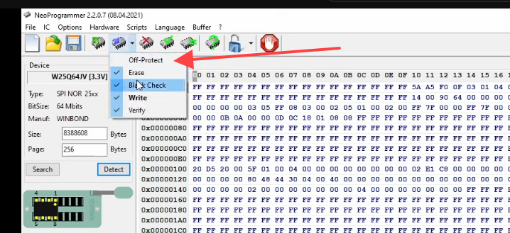

    Hello
    I took the bios from my motherboard - succesfully can read the data from bios chip (Saved backup file on my PC)
    Downloaded new bios bin here but i cant write that to the chip (I have tried Asprogrammer, Neoprogammer) as soon as i click "write ic" the programs goes "Not responding" state and hangs there.​

    Check your write protection flag for this memory.
    https://www.reddit.com/r/GPURepair/c...rom/?rdt=38004
      • 21853
      The chip needs erasing before you can write to it.

        Hello.
        Thank you for the quick feedback.
        Just tried once again , connected the CH341A and verifyd the IC , read the IC info - all working good.
        When i clicked on Erase IC , Asprogram freeze and goes to "Not responding".

          What about the protection flag?
          See here:
