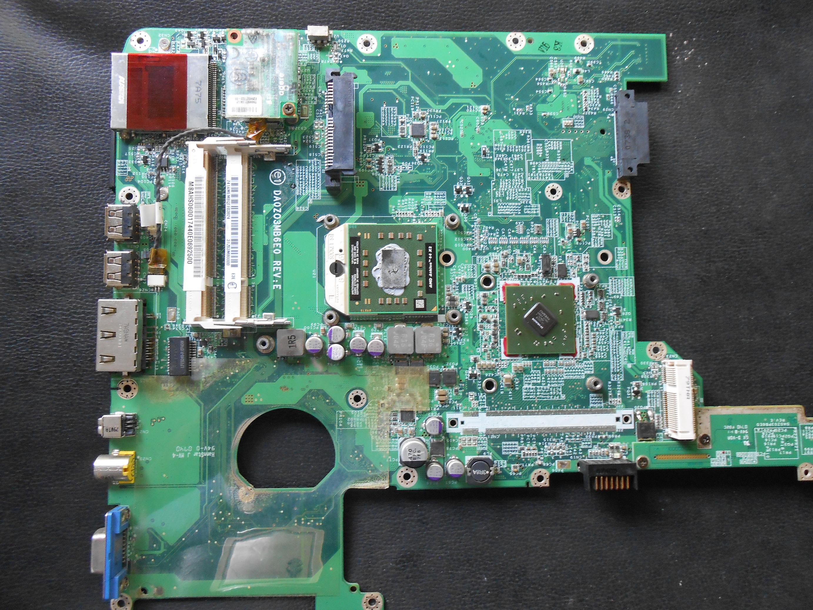

    Acer Aspire 4520 fan spin 2sec & suddenly stop.
    Thanks.

      Re: Acer Aspire 4520
      Connect a DC Amper meter in series with the DC jack + in and measure how many mA you have without press ANY button.
        its short on some power rails or no PWRGD signal. check every big coil for short to ground and for voltage right after start button
          reflow navidia gpu. its a common issue with this model
            Thanks to all cpu reset signal ic u23 all ready removed. Wait.
              Same like Acer 5520 just get a hot air gun (for testing) blow it a bit, and see if it running if yes do a proper reflow.
                i reflow nvida but same condition
                please upload schematic board no DA0Z03MB6E0 REV:E
                    common issues is nvidia gpu.try reflow
                      Just don't forget the MCP chips tend to die, and after reball or reflow give only video output on the other screen (monitor) not the primary.
                          try amd turion 64 which is also used in compaq cq40
