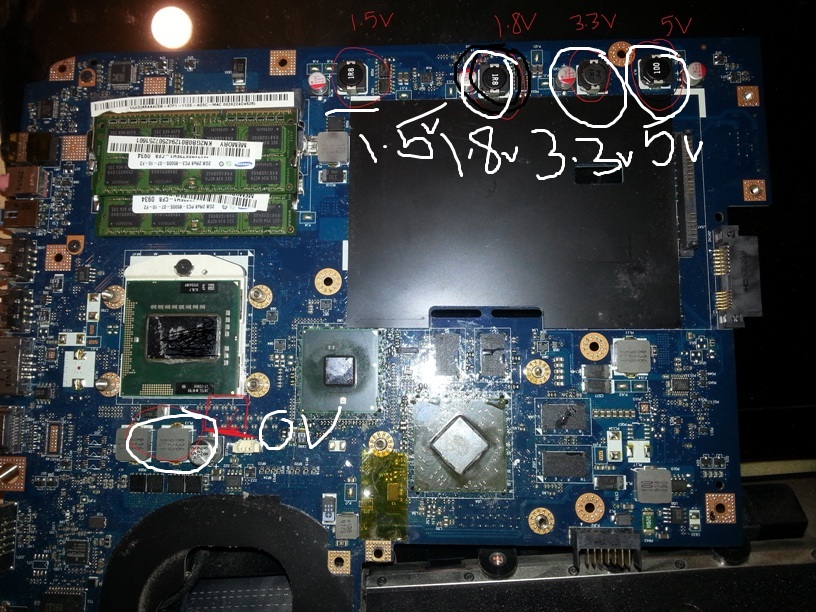

    hi
    this laptop boot with no display: i found that the cpu will sti;; cold even if it works for hour no heat at all
    i took the voltages as shown in photo:
    but the bios has 0 volts on all pins when only plugged in , but after power on, there will be 3.33v on all pins except pin 4.

    Re: aspire 5940g
    can any one help with this , still not functioning
    thnx

      when it power on, fan spin ?

        Re: aspire 5940g
        yes the fan spins

          Re: aspire 5940g
          probably intel chipset need reballing (not reflow)

            Re: aspire 5940g
            this one`s got HD4670 MXM video card !
            go with that first or at least try the video in another laptop

              Re: aspire 5940g
              in the picture i see vga is soldered onboard, but as he say cpu is cold then ill go first with nb right ?
