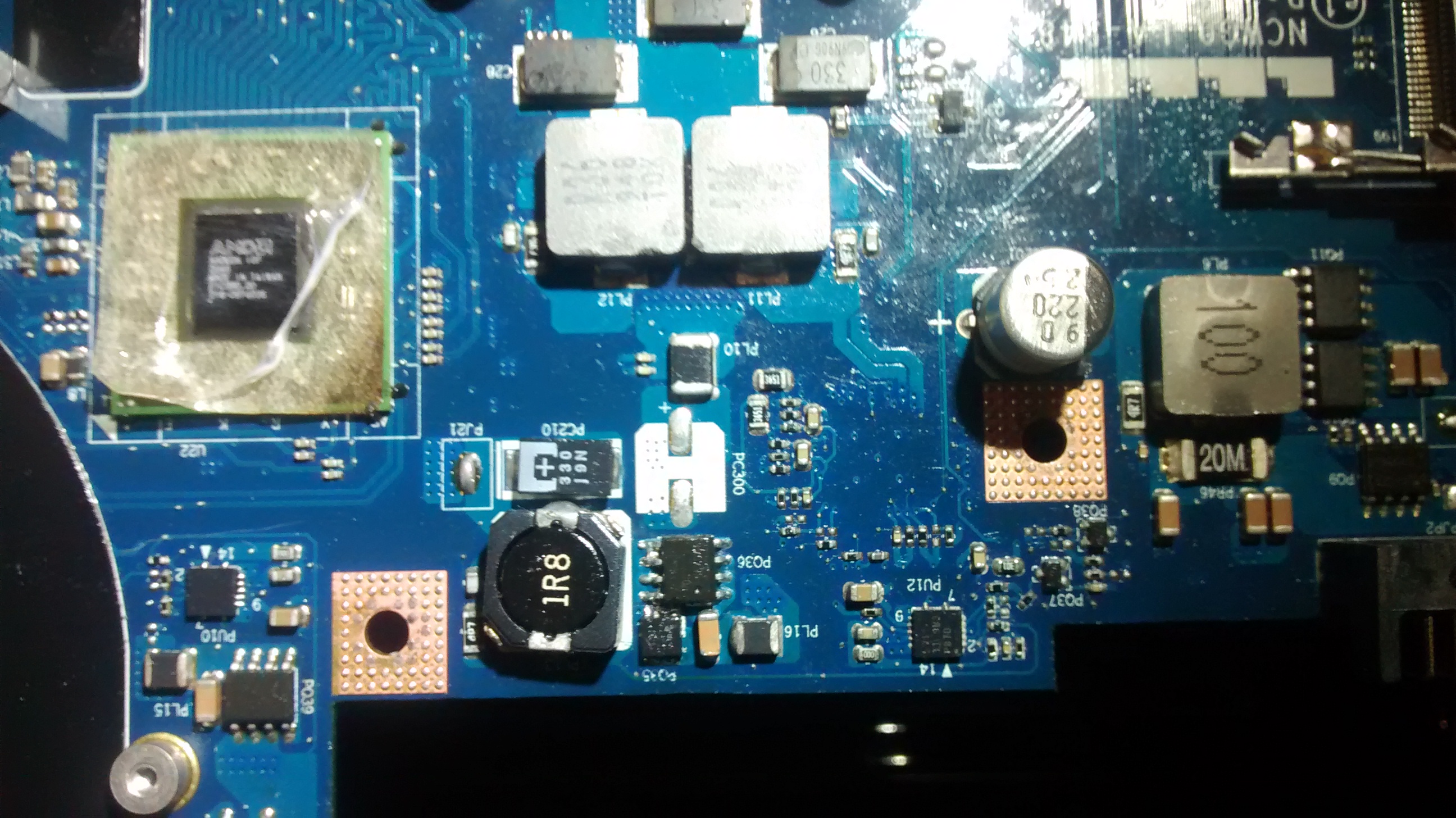

    Hello.
    I got a faulty Acer Aspire 5517. took it apart and found a burnt mostfet (PQ35).
    through the schematics i found online i order some new mosfet a replace it.
    i re assemble the laptop to test it. and when i pressed the power button the laptop work for a few second (fan and power led turned on)and then stop.
    Took the laptop apart and checked the mosfet with a DMM and Drain and Source was shorted.
    i replaced the mosfet once again cause i though i didnt solder it well. but the same thing happened.
    above the mosfet i replace there is another mosfet(PQ36). Now the Source of PQ35 is Connected to the Drain of PQ36 acording to the schematics.
    Checking with the DMM i see that its connected to ground but according the the schematics its not.
    the schematic i have is this one. on page 42 you can see the relative circuit.
    https://www.badcaps.net/forum/showth...er+aspire+5517
    what else should i check around the mosfet? nothing else seems to be burnt.
    Not a native english so sorry for anything that doesnt making any sense in my writting.
    Thanks in advance

    change that integrated circuit PU12 : tps51117

        nearxos> check pq36 for short. if it is shorted, after the power button the vin is shorted through pq36 and high current blow pq35

            forget about it u have 3.3v and 5v good. 3.3 and 5v must be good to power on so u have it good.
            system detect short on switched powerrail and power off because didnt have PWRgood signal. in your case SUSGD or something like that.
            Focus on pq36 or short on that power rail.

                if u took it out check for short on that rail
                but how do u know that pq35 is shorted when dont know how to check if it is shorted?
                look on youtube how to check it, because when u dont know , u can bad check and think it is shorted

                        after the first attempt to replace PQ35 it did start for a sec.
                        Now it wont start at all.
                        i start check from the power jack.
                        on the power jack i got 19.5V
                        the on PL1 19.5 V
                        PQ7 on the drain i got 19.5V on the source i got 18.7 V
                        Next Pq8 is connected to PQ7 Source to Source. and on the Drain of PQ8 i dont get any voltage.

                                Let's start from the beginning. Stop searching for the 3.3v and 5V.
                                Remove PQ35.
                                What is the resistance relative to ground on all pads of PQ35?

                                      Drain to ground resistance: started measuring 900 kΩ and gradually decreased to 110kΩ
                                      Source to ground resistance : 10Ω
                                      Gate to ground resistance 234 Ω
                                      i check for 3.3 V and 5V as advised earlier couldn't trace a 5V anywhere I did find a 3.3V on PQ13 but not on U41 according to the schematics

                                        chceck pl4 and pl5
