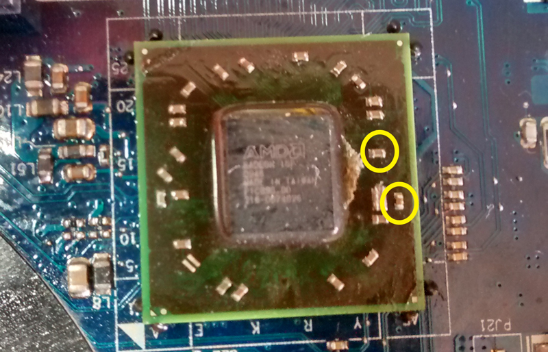

              Re: ACER ASPIRE 5517 burnt MOSFET
              Originally posted by atsio
              No, you are not checking the resistance of the caps but the resistance at the caps. Check both sides of each cap relative to ground (one side is the ground).
              I found two cap that measure lower than 3Ω
              you can see in the photo i attach which ones
              • atsio
                • Oct 2013
                • 819
                • Greece
                That's not good. Hope your Northbridge is not shorted. You have to find which line is shorted. Check resistance relative to ground on PJ1, PJ2, PJ3, PJ4, PJ5, PJ6, PJ7, PJ8, PJ21, PJ10.
                Report the results.
                • nearxos
                  • Jun 2014
                  • 41
                  • Cyprus
                  Report the results.
                  PJ1----- 26KΩ
                  PJ2----- 1.64KΩ
                  PJ3----- 36KΩ
                  PJ4----- 9ΜΩ and was keep decreasing
                  PJ5----- 24.3MΩ
                  PJ6 ----- 334Ω
                  PJ7----- 322Ω
                  PJ8 ----- 159Ω
                  PJ21----- 11Ω

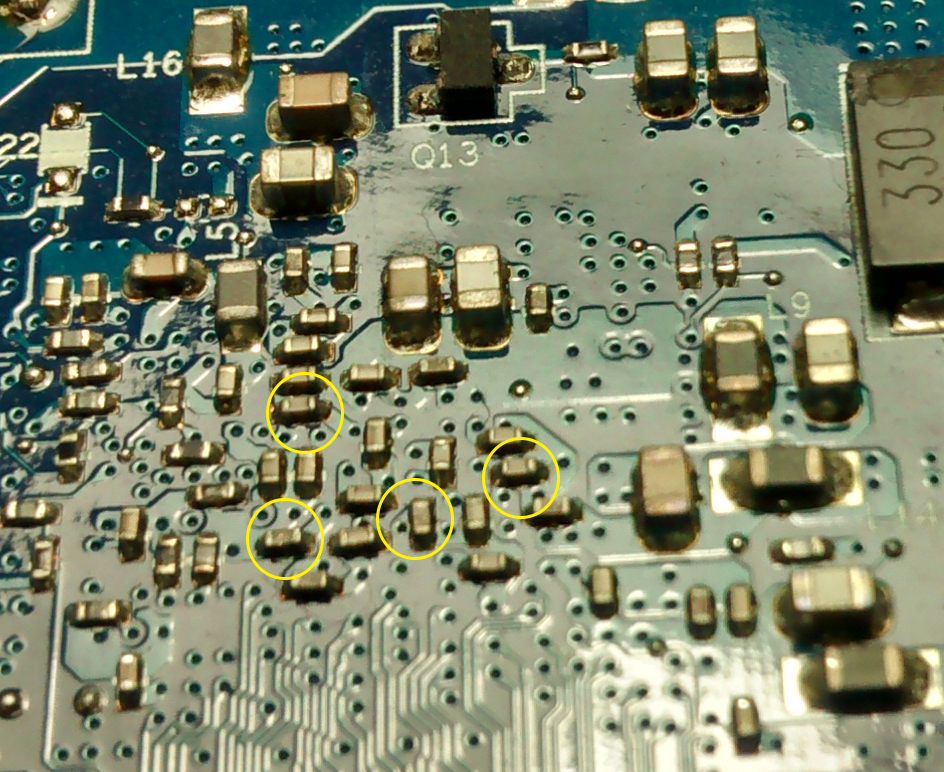

                    Check resistance of capacitors under the northbridge (other side of board) to find which line is shorted.
                    • nearxos
                      • Jun 2014
                      • 41
                      • Cyprus
                      #30
                      i found 4 caps with low resistance around 10-12 Ω

                        #31
                        These are on the NB_CORE line which gives you 11Ω resistance. We are looking for less than 3Ω like the ones you have on the chipset.

                          #32
                          i ve check and recheck but could find any low resistance on the caps.
