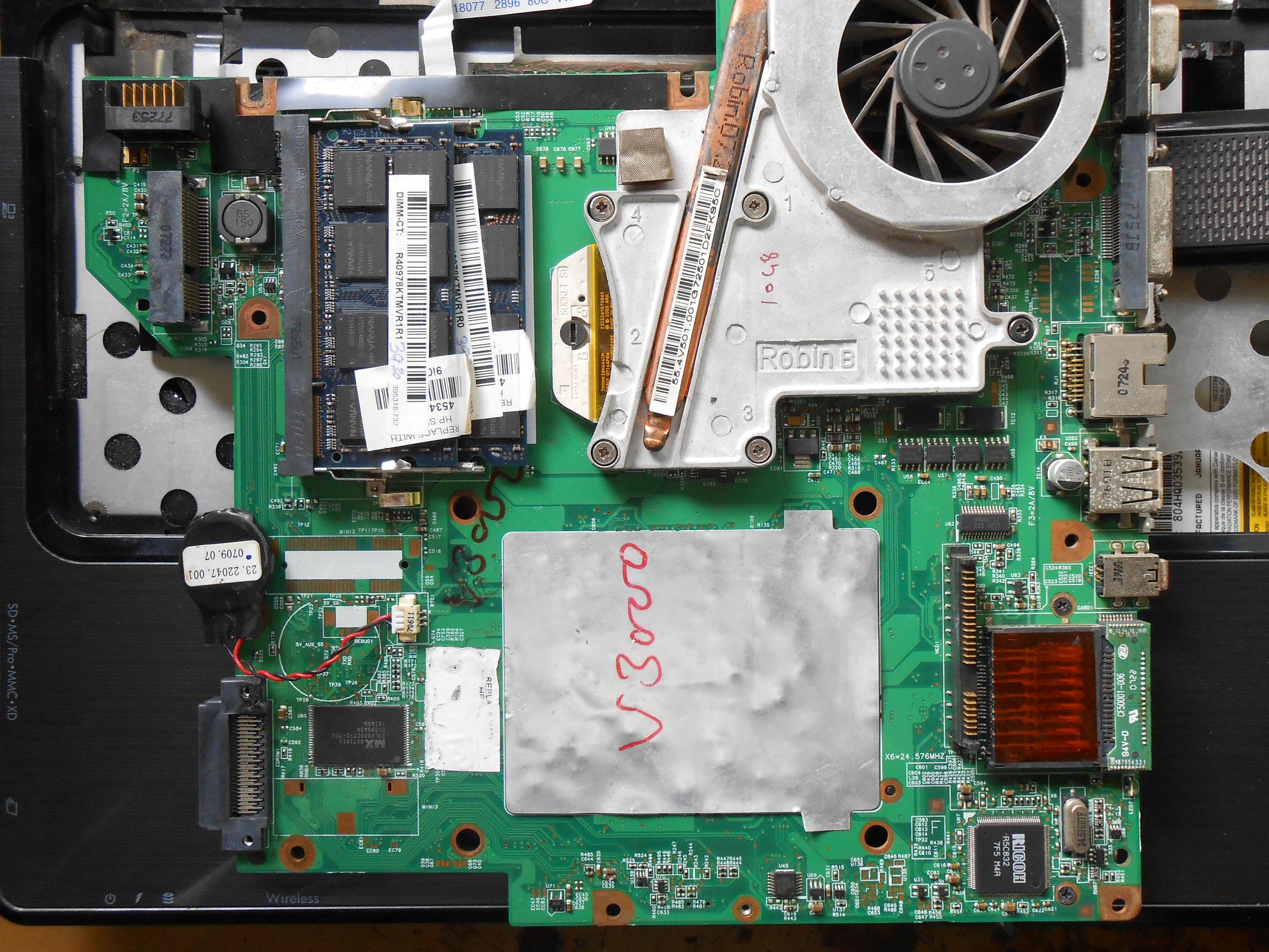

    No display on Compaq Presario V3500 all led on suddenly when press power button . please schematic upload.

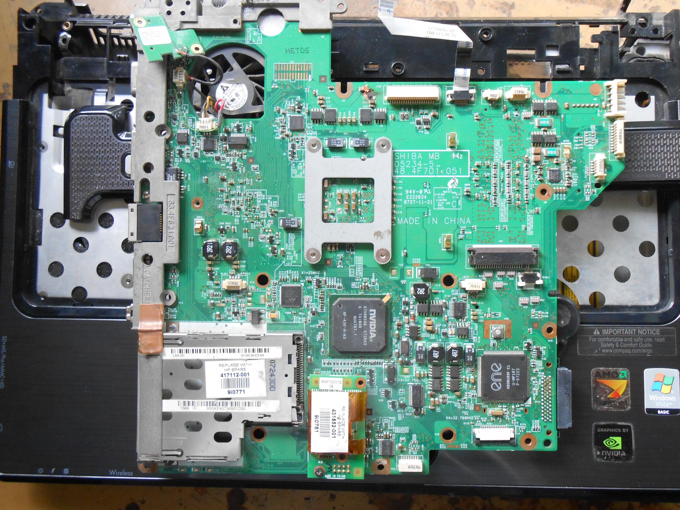

        Re: No display on Compaq Presario V3500
        Photo 2 shows spillage near the bios bottom left
          also bios chip looks like its missing a pin at left side row at the bottom, I count only 23 pins on that side, and there seems to be burning on the connector just under cmos battery
            Also near the battery connecter on the right burn marks?
              Also by LVDS and KB connector. OP this would take a hell of a lot of work to repair - presuming it is even possible. I'd personally not bother for such an old laptop.
                when i see "work" on fan connector im not surprized
                    Thaks to all.
                    schematic & board difffret. no burn near batt connecter.
                    trebo 46&47 pin ground.
                    Near lcd connecter some part & path burn.
                    so i need schematic.
                        Thanks vikas
                        my laptop on i resold bios pin.
                        Thanks again to all.
