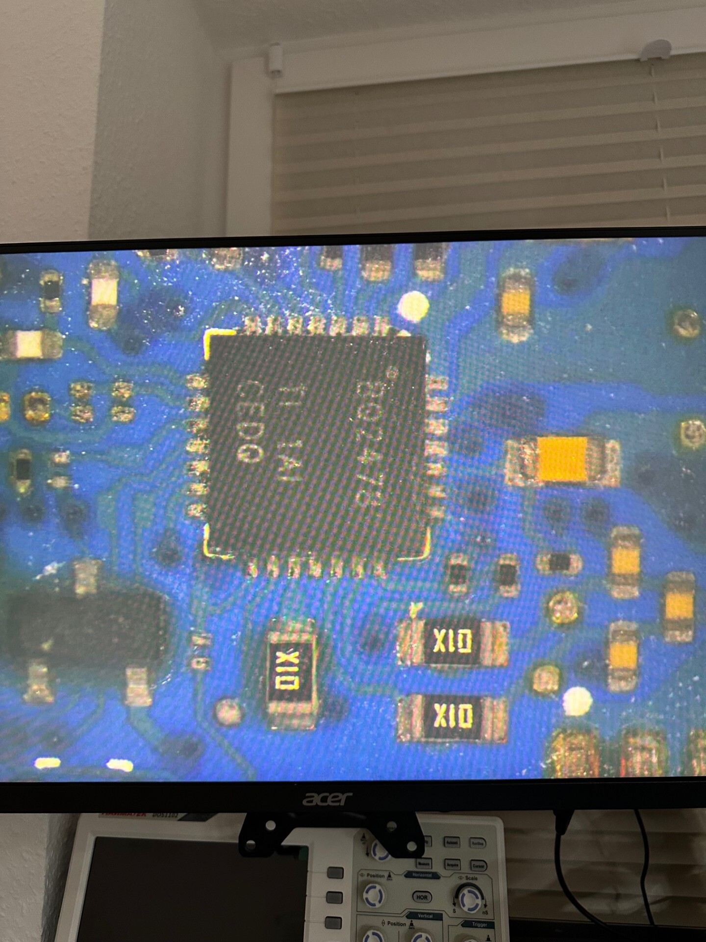

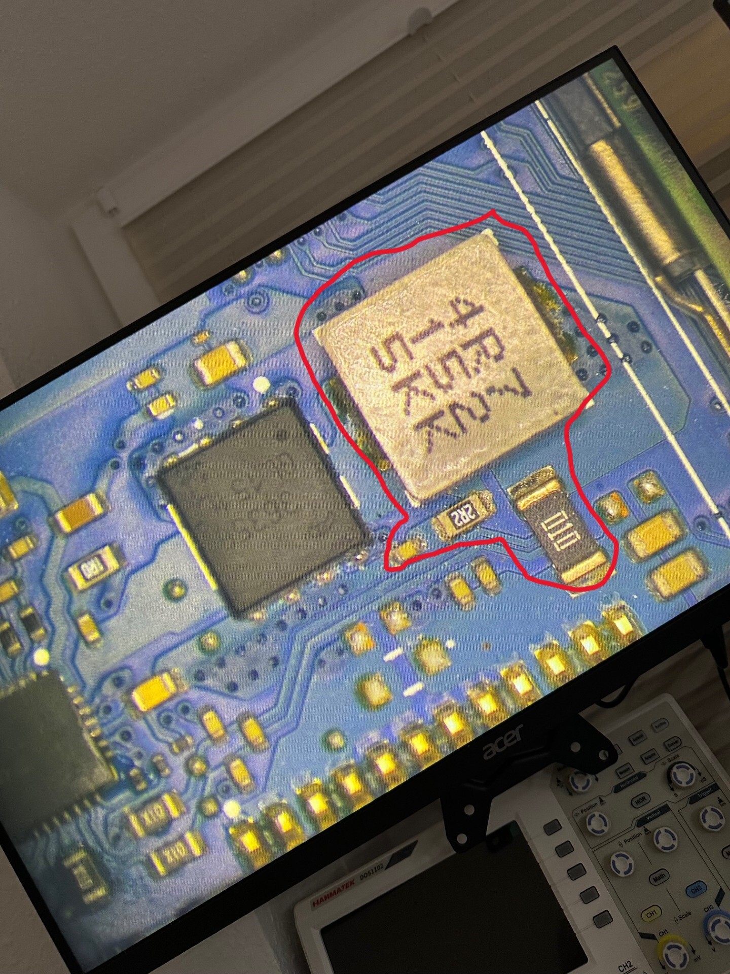

                      Today the parcel with the SY9329CQFC was delivered. I quickly reflowed the new chip onto the motherboard, attached all wires, fans, keyboard, RAM and so on (but not the battery) and pressed the power button. The fans started to spin and the laptop booted properly. So I assembled the battery too and with power supply in, the orange charging led turned on. Now, after I pressed the power button, the laptop booted too, but the coil whine is back. So I took out my thermal cam and the components, which are red marked, are between 95-110°C hot. When I detach the power supply, the temperature cools down to the supposed normal values and no coil whine.
                      So:
                      - Power Supply without battery = white light and no problems / Battery without power supply = white light and no problems / Battery with power supply in = orange light, coil whine and hot components and cools down and no coil whine after detached power supply
                      - Good diode values on marked components between 0,3-0,5V
                      - Measured 2,2ohm between the marked resistor / No short to ground with black probe on ground and red on resistor
                      - Measured 11,5V with battery attached on inductor/coil and on all other components on that rail
                      - Measured 13,2-13,6V with power supply and battery attached ...
                      That is crazy! It looks like there is no problem with charging and booting, except the hot components. Even the test mode, which is integrated into the recovery mode (booted it without hard disc) shows battery status, logic state and charge state "OK".
                      Near the marked components there is a BQ-chip and I think it´s a charging controller similar to Nintendo Switch or other devices. Maybe that chip is giving false/to much current? Maybe the mosfet near components is faulty and the culprit?
                      I think it makes no sense to remove the mosfet, when there is no short. Because good voltage is present.

                        Had that happen to me once and it turned out that it was the power supply not providing enough current - can you measure the current coming from your power supply? If not, do you have another power supply you could test with, one with higher amp rating? Also, I noticed in the photo you have circled a small capacitor that heats up. Did you try removing it?
