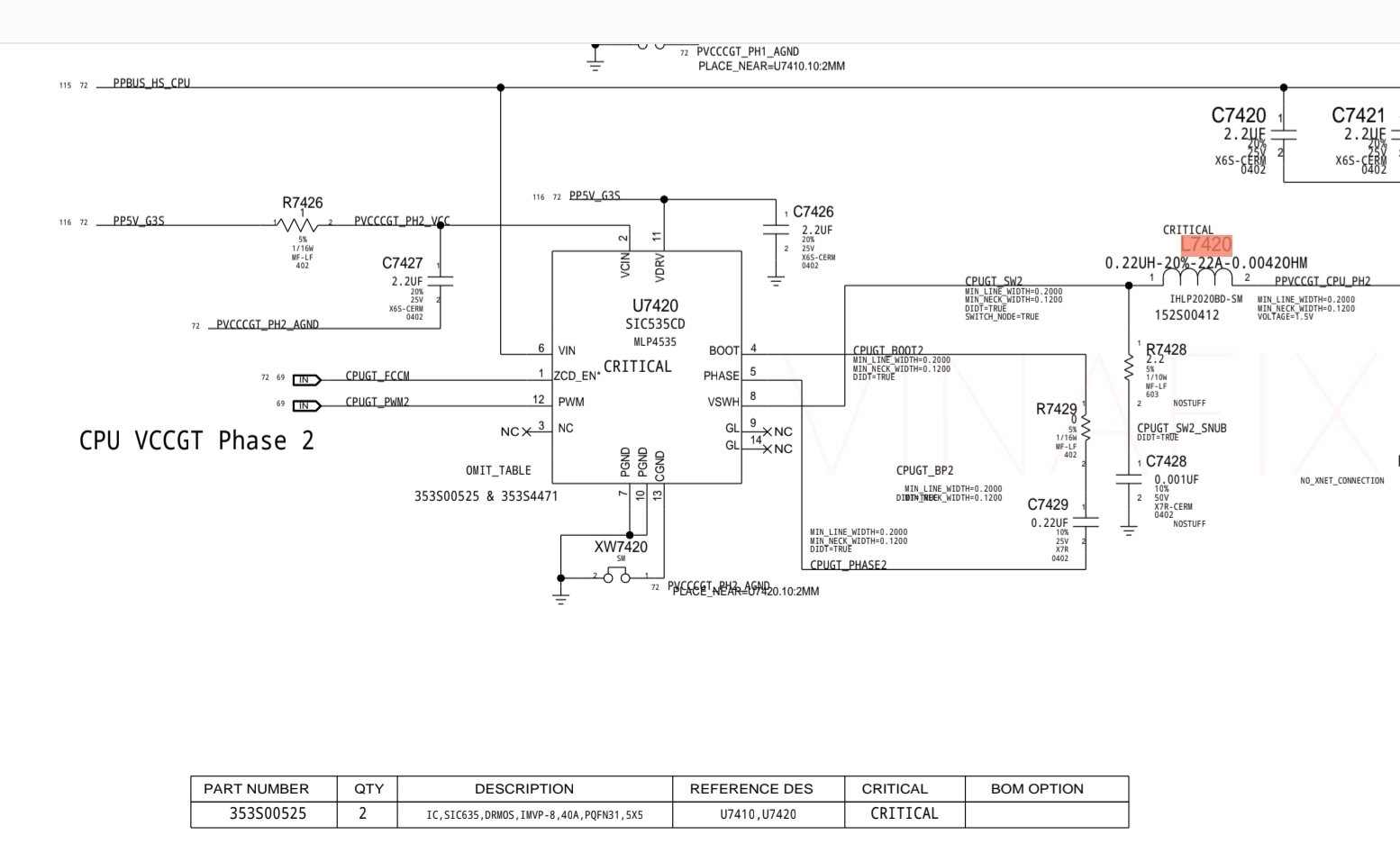

    I have a A1990 which had a blown inductor next to the display connector. There was no short at this spot, so I replaced it.
    I noticed that the big coils above the GPU/CPU (PPVCORE) had a pretty low resistance (2.2Ohms). I already talked about this with mon2.

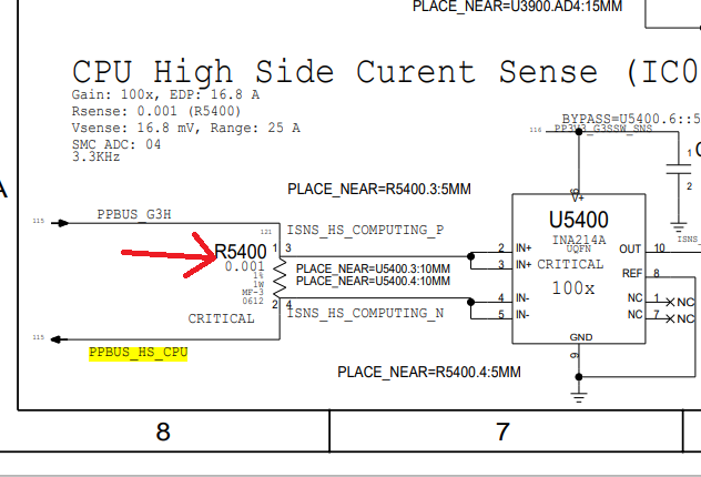

    PPBUS_G3H, PPBUS_HS_CPU showed 1.8ohm to gnd. So I removed the R5400 to seperate the two rails. PPBUS_G3H is fine again but the short is unfortunately on PPBUS_HS_CPU. Sounds like a no fix to me.
    Plus I can't find any particular spot which his heats up when I inject 1V@max2A
    Any suggestions how to move on?

    I removed the cooling shields of the GPU/CPU and when I inject 1V into PPBUS_HS_CPU, the CPU heats up.
    Doesn't look too good tho
    • mon2
      • Dec 2019
      • 14677
      Correct. Very likely the CPU is dead. Test the resistance from PPBUS_G3H (fuse) to PPBUS_HS_CPU (inductor). A low resistance means that the high side mosfet which is used to dial down the high voltage to a CPU safe one is defective and the high voltage has reached the CPU rail.

        Thanks for your answer. Do you mean another rail instead of PPBUS_HS_CPU to measure?
        PPBUS_G3H is conntected to PPBUS_HS_CPU by the R5400 (pic in my first post). So this should always be about 0 ohms. That's why I removed The R5400 yesterday to make figure out which rail causes the short.
        Is the U7420 the high side mosfet you mean? The L7420 shows 8 ohms to PPBUS_HS_CPU. You're probably right that this Mosfet is defective or leaking.

          With an 8 ohm resistance from L7420 to PPBUS_G3H / PPBUS_HS_CPU, the high side mosfet is dead. The CPU is very very likely dead.
