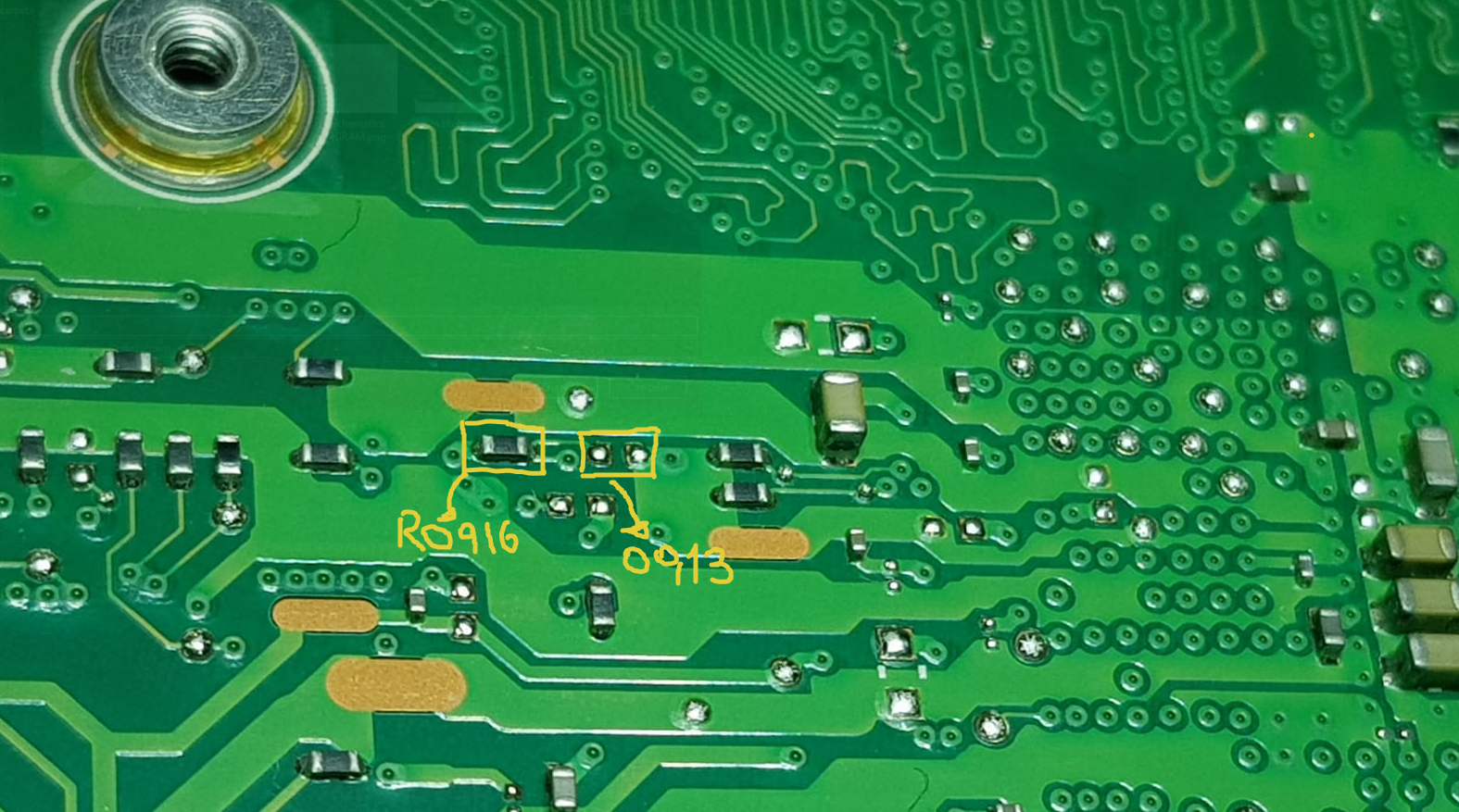

X512DK MAIN BOARD REV. 2.1 Disable Onboard RAM
  • xloomx
    • Oct 2020
    • 50
    • Argentina

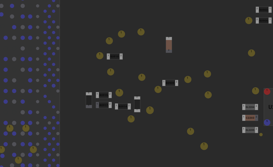

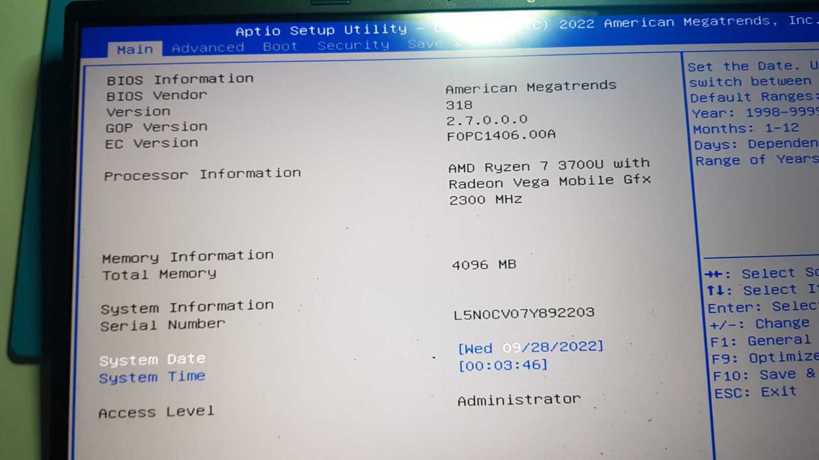

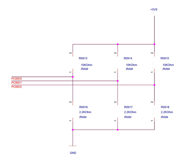

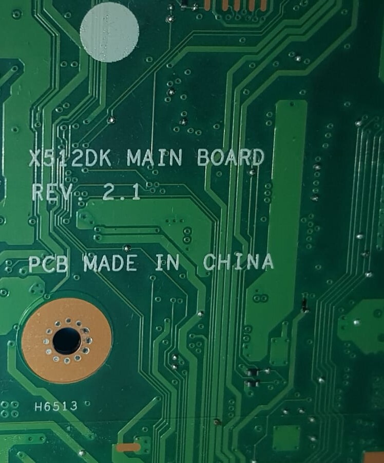

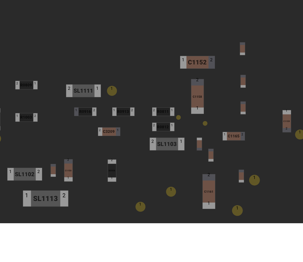

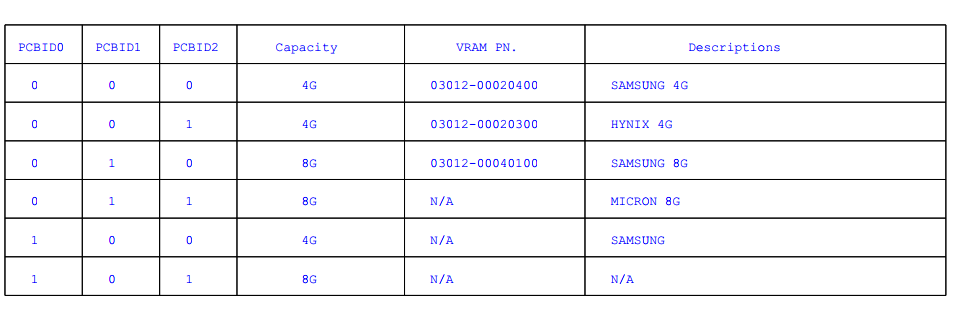

    Asus F512D, motherboard X512DK MAIN BOARD REV. 2.1 Hynix 4GB OnBoard, (ID0=0, ID1=0, ID2=1)
    In this case to disable onboard ram, Take out R0916 and place a 10K Resistor on R0913.
    The configuration would be for N/A:N/A , ID0=1, ID1=0, ID2=1. (Working for me with Hynix 4gb OnBoard Memory, in this case, do not touch other resistors)
    Images Attached
