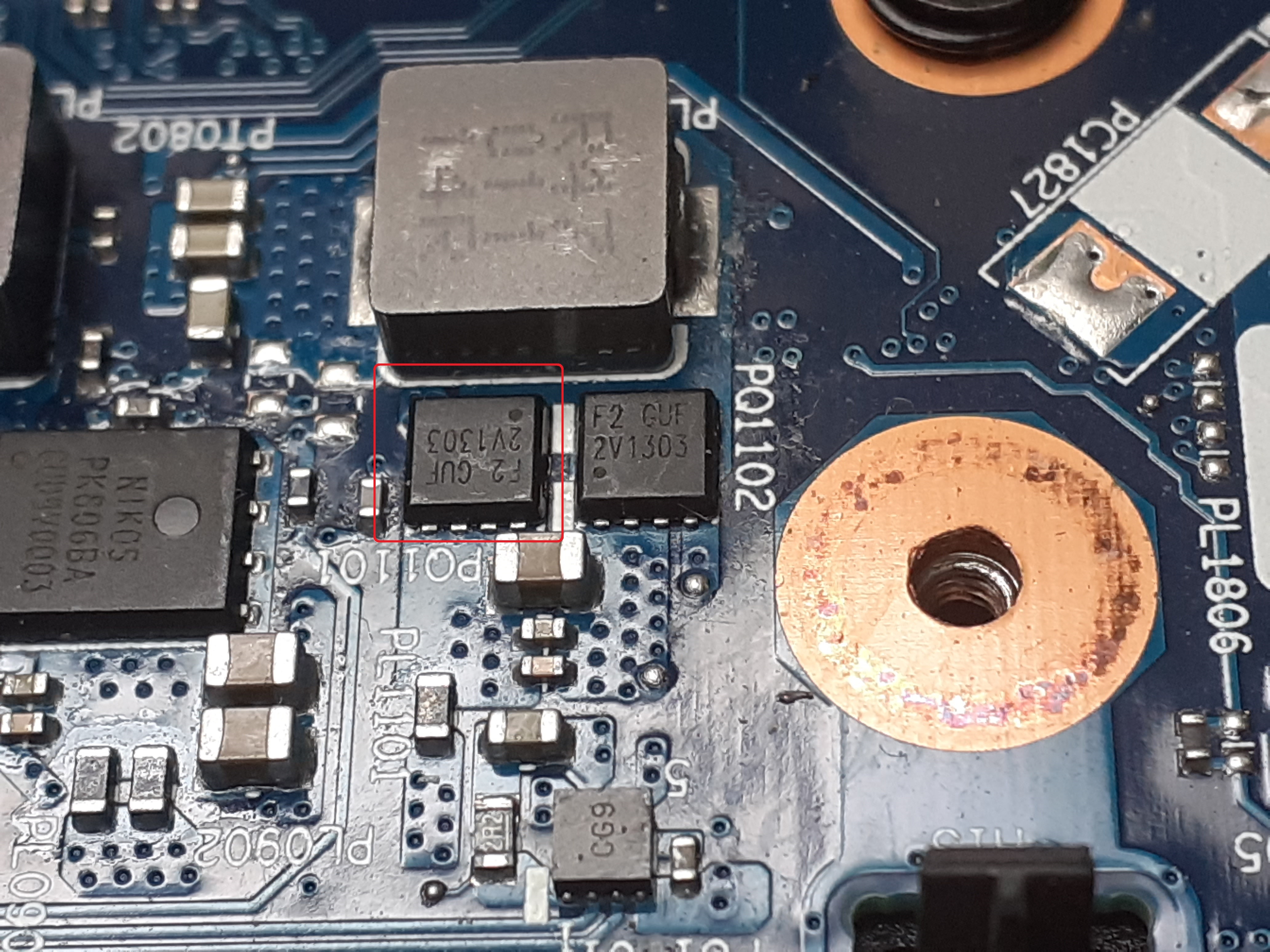

    Hi at all. My thinkpad is dead yesterday.
    After open the bottom board, i see PQ1101 go to burn after powerup.
    Probably is shorted? On the schematic is a n channel mosfet, marked as AONR32340C.
    Click image for larger version  Name:	20241221-144119.jpg Views:	0 Size:	1.86 MB ID:	3533451
    Hope someone help.
    Thanks,
    Maurizio

          Replace both PQ1101/1102 along with pwm controller associated with these mosfets at one go.Else the new mosfet may get shorted again
          .After removing the controller ic plus both high/low side fets,measure resistance to GND on the coil to be sure its not shorted.

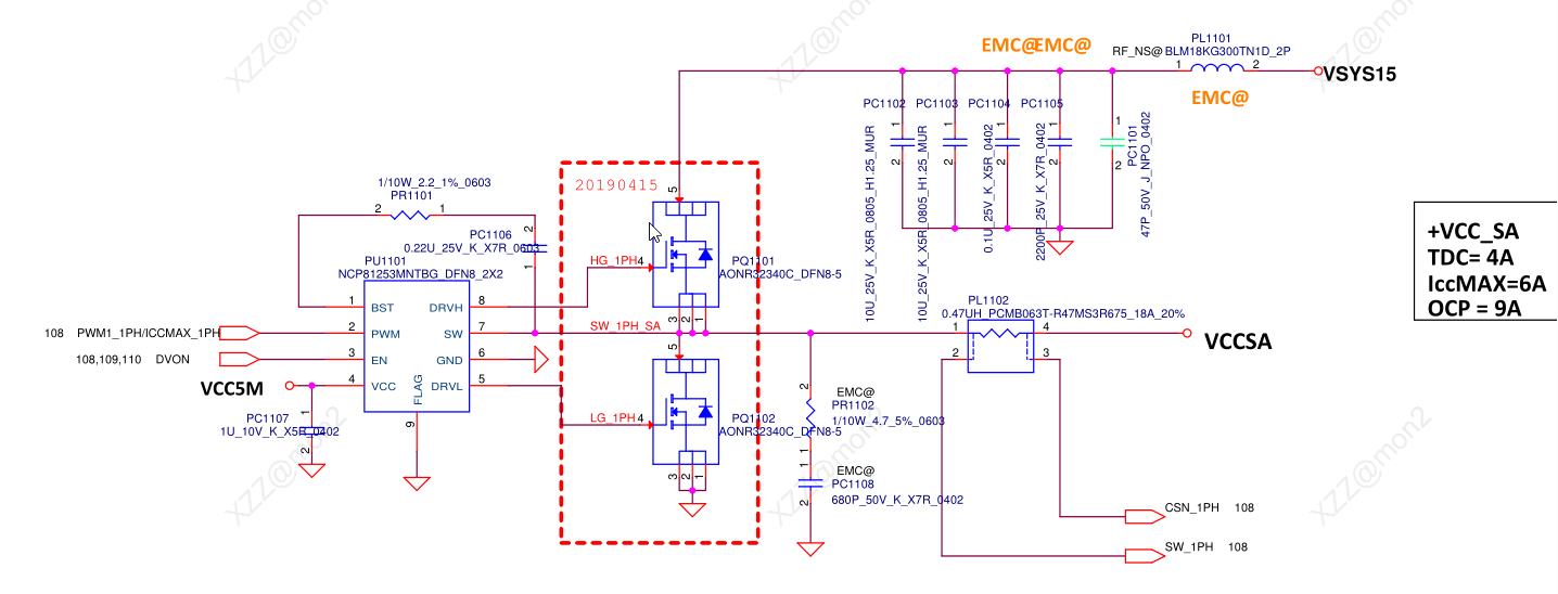

            The mosfet driver, is marked CG9. What did mean?
            I'm unable to find the datasheet.
            Thanks,
            Maurizio
            • mon2
              • Dec 2019
              • 14201
              See attached.
              Your board is NM-C421.
              Datasheet for this controller:
              ONSEMI # NCP81253MNTBG

                  Hi at all, i replaced all the mosfet and the driver, but before power-up i note, have missed (sadly with hot air) this little capacitor marked in orange.
                  What type of value have this capacitor? Before power up i wanna to install it.

                      Mon2, is the little cap immidiately on the left of PQ1101 and circle in orange. No the Mosfet is not missing.

                                Ok i find the component i lost, it's not a capacitor, is PT0008 (prf15bb541nb6rc) a NTC thermistor, 640 ohm made by murata.
