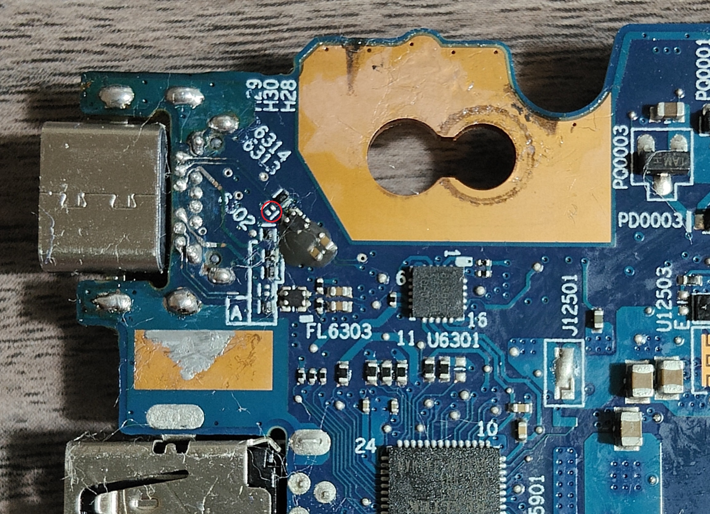

    Need help to fix my son's laptop.
    I changed the USB C port, still no charging. checked U5901/RTS5455, pin 25 has 5V, pin 26 has 3.3V. Not sure where to check next.
    If any one can tell where I should check next, it'll be much appreciated. Thanks.

      thanks for that. read that before. how do I know it's this RTS5455 has issue? I checked pin 26 which has 3.3V. does this mean it's good?
      • mon2
        • Dec 2019
        • 14673
        Pin 26 is only a fixed ldo rail at 3v3. It is a good start. This controller requires firmware to operate and communications will be over the CC1 and CC2 lines.
        Do you have a usb type C meter? The linked thread mentions methods to reflash the firmware onto this device.
        Be sure that CC1 and CC2 lines are ok. Meter in diode mode. Remove all power. Red meter probe to ground. Black probe to CC1 pin on the usb type C connector. What is the measurement?
        Repeat for CC2 pin.

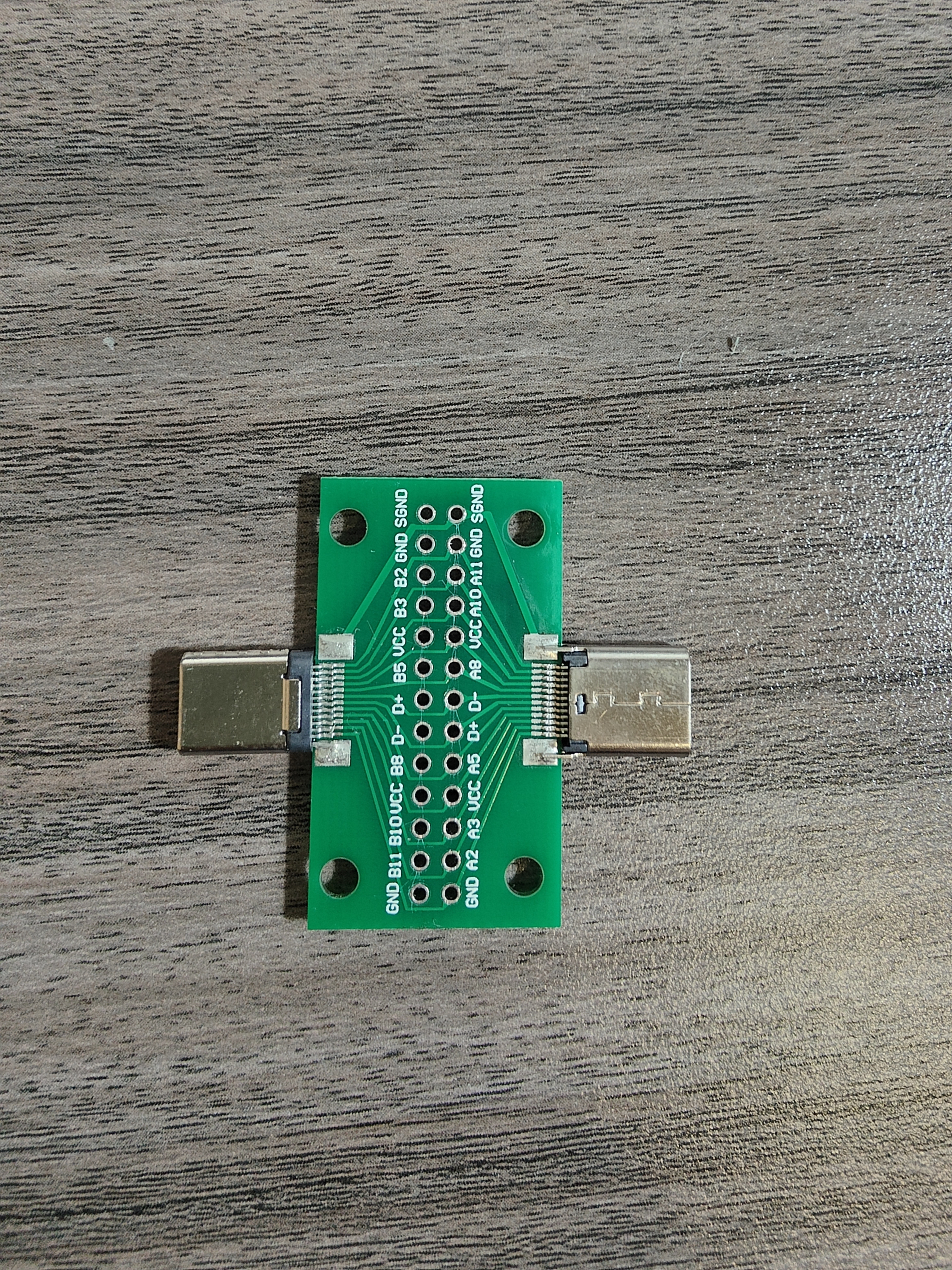

          I don't have a USB type C meter yet. Looking to buy one currently. I have this tester
          Plugged in it to the USB C port. in diode mode, readings for CC1 and CC2 pin of this tester are all 0.599V.
          Checked voltage of pin 9/CC1 and pin 11 /CC2 of RTS5455 when plugging power to USB C port, voltages are 0.004V and 1.661 V.
                The CCx voltage will only be active for the side being used by the power adapter for the power delivery communication. So for the low voltage side, flip the power adapter cable by 180 degrees and measure again to confirm this side is now active with the ~1v661 reading.

                  if flip the power adapter cable, CC1/CC2 voltages also flip from 0.004v/1.661v to 1.661v/0.004v.
                  The laptop works with the battery. could the issue be a mosfet for PD? Not sure how to check it.

                    Are you using the official power adapter?
                    Carefully measure the voltage to ground of each of the dcin mosfets. Need to confirm that the power delivery contract for 20v is being selected. After this stage, the mosfets must be enabled to charge the battery and to power the logic board.
                    If 20v is not selected then the power delivery controller is a suspect. Is the PD controller the original or it was replaced? The firmware in the PD controller can be reflashed by following the steps linked in the above post.

                      official power adapter has no issue, works for another laptop. also tried another official power adapter from another laptop, same result.
                      for sure 20v is not selected. there is only 5v from the usb c port.
                      the PD controller RTS5455 is the original one. at the beginning the charging issue should be only the usb C port which is damaged I believe, seems connectivity issue - had good or bad contact when the plug is pressed or bent. replaced the sub c port - did it twice due soldering skill😅.
                      now the connectivity seems all good. connections from all VBUS and CC1, CC2 pins of USB C port to board are all good. CC1/CC2 pins reached U6301 pin 4 and 5. it seems the power adapter is not communicated to lift up the voltage to 20v.
                      could you please help to tell which chip/pin to check next? Thanks.

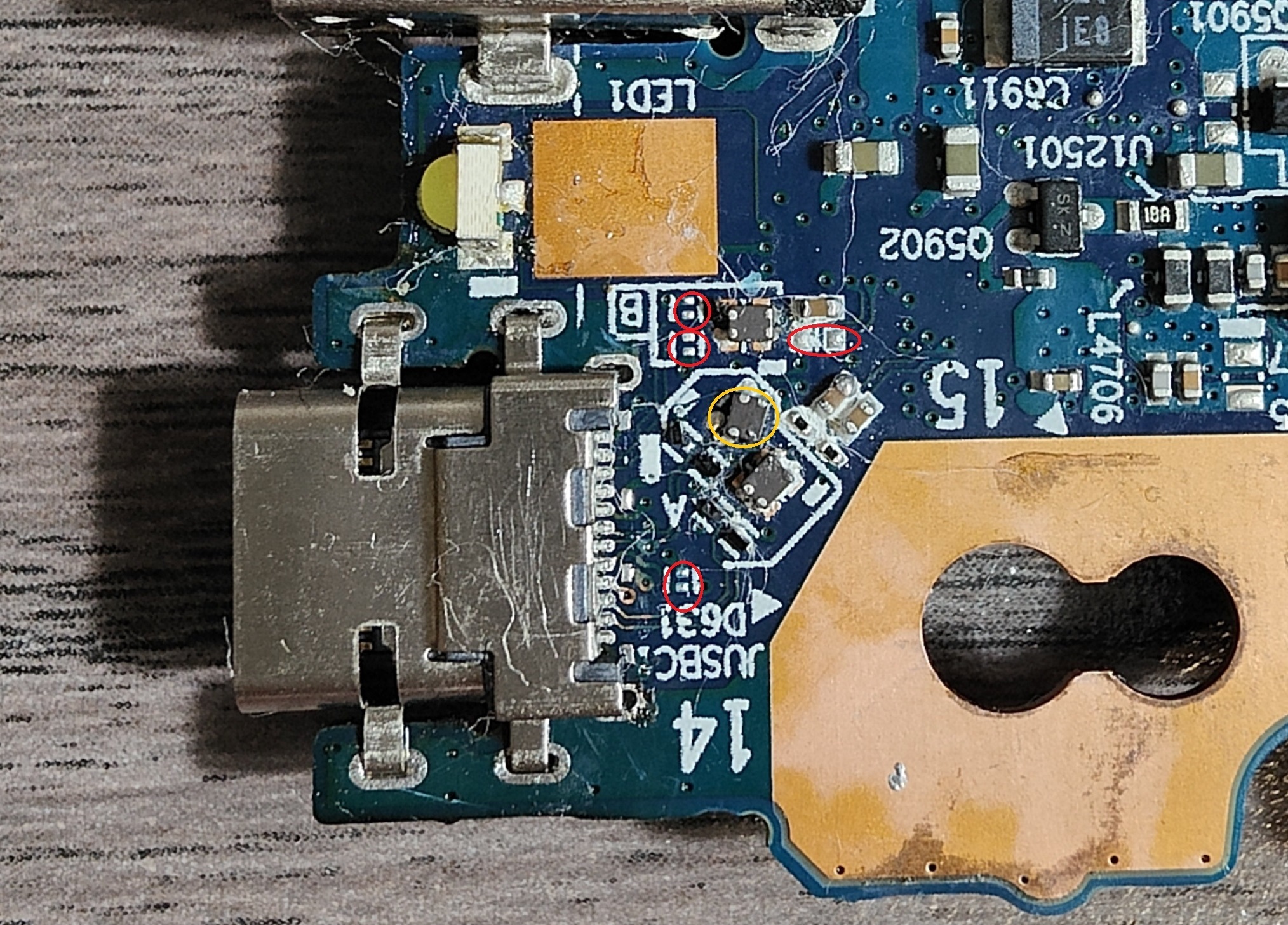

                                        I think I did a bad job when changing the USB-C port, several tiny components are missing from the board - those red circles. and one is misplaced - yellow circle. are they critical for PD?
