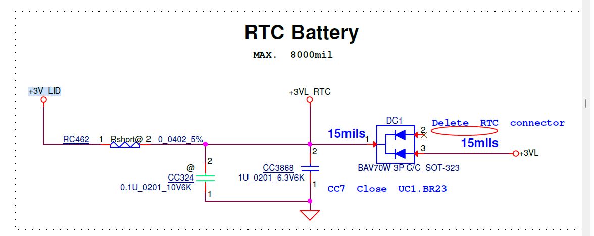

                  Sorry, unable to follow this conclusion albeit it is very early here.
                  +3V_LID is created by +3VL after it passes through the diode @ DC1. Can you confirm the voltage to ground of +3VL?
                  +3VL = +3VLP and is created by the internal LDO inside of PU301 (pin # 17).
                  This LDO rail will enable only if there is a valid voltage on the EN2 pin # 11 of PU301.
                  Check each of the above points of interest.

                  • dclass-pro
                    • Dec 2022
                    • 157
                    • Italy
                    I noticed that DC1 was heating up a lot and so I checked on pin 1 of DC1 and between pin 1 and ground I have a short so 0ohm.
                    I tried to inject 3v on pin 1 of DC1 and I noticed that it heats up the processor, so it is the one that is shorted​
                    • mcplslg123
                      • Jun 2015
                      • 7262
                      • india
                      RTC section of PCH is shorted-Precise answer to your fault. Quite a common phenomenon
