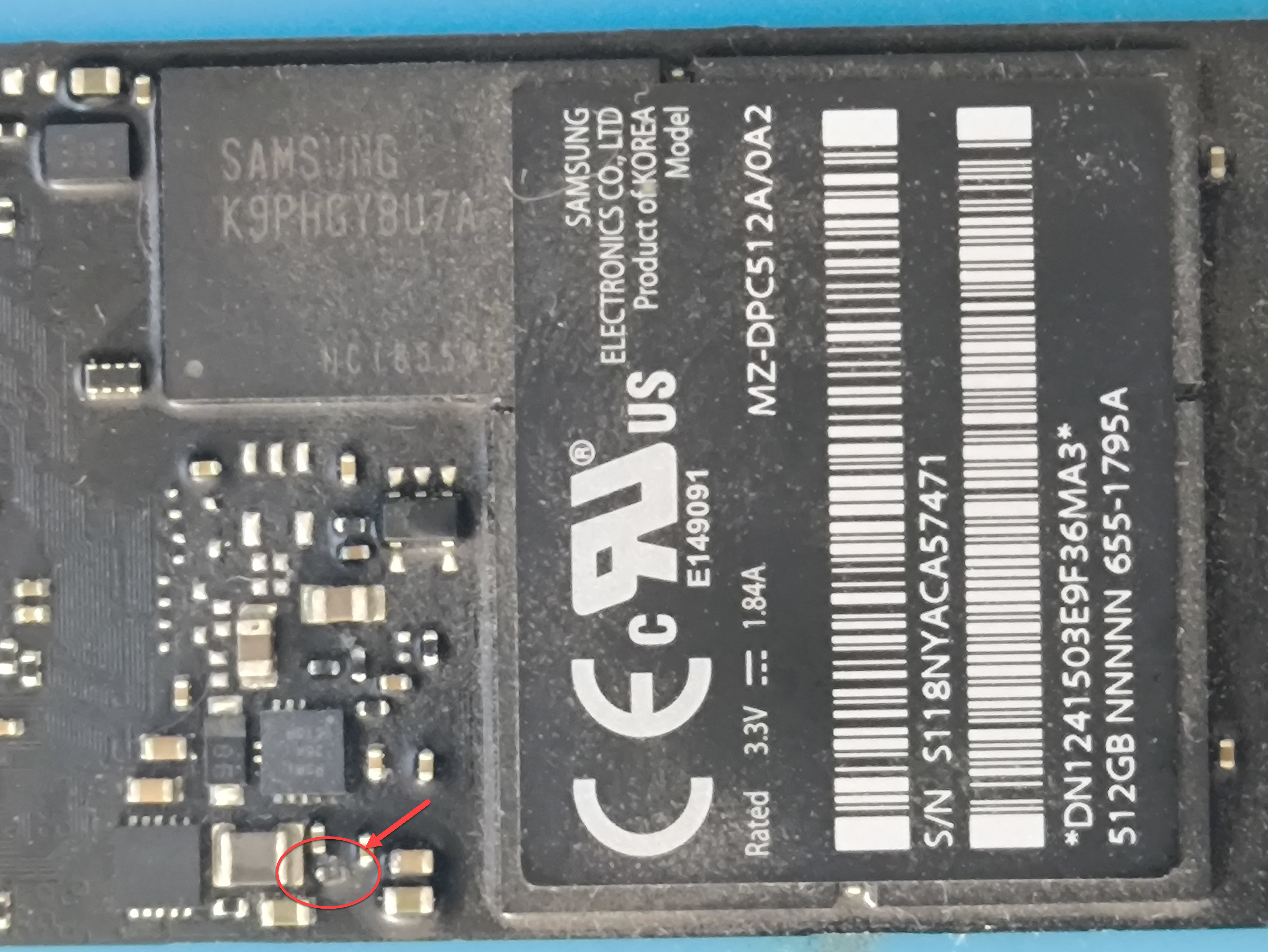

    Customer brings in this severely liquid damaged 2012 Macbook Pro A1398. Primary thing he wants data off this SATA SSD he has fitted and it's not being detected on a spare motherboard. Other drives are ok.
    Noted a small amount of corrosion on the SSD on one component, even though it was coated in that black glue. The component in question does read short to ground. Wondering if any one else has a working 512GB SATA SSD from a 2012 MBP (either A1425 or A1398) to verify I've got a bad cap. Or maybe some diode readings would help.
