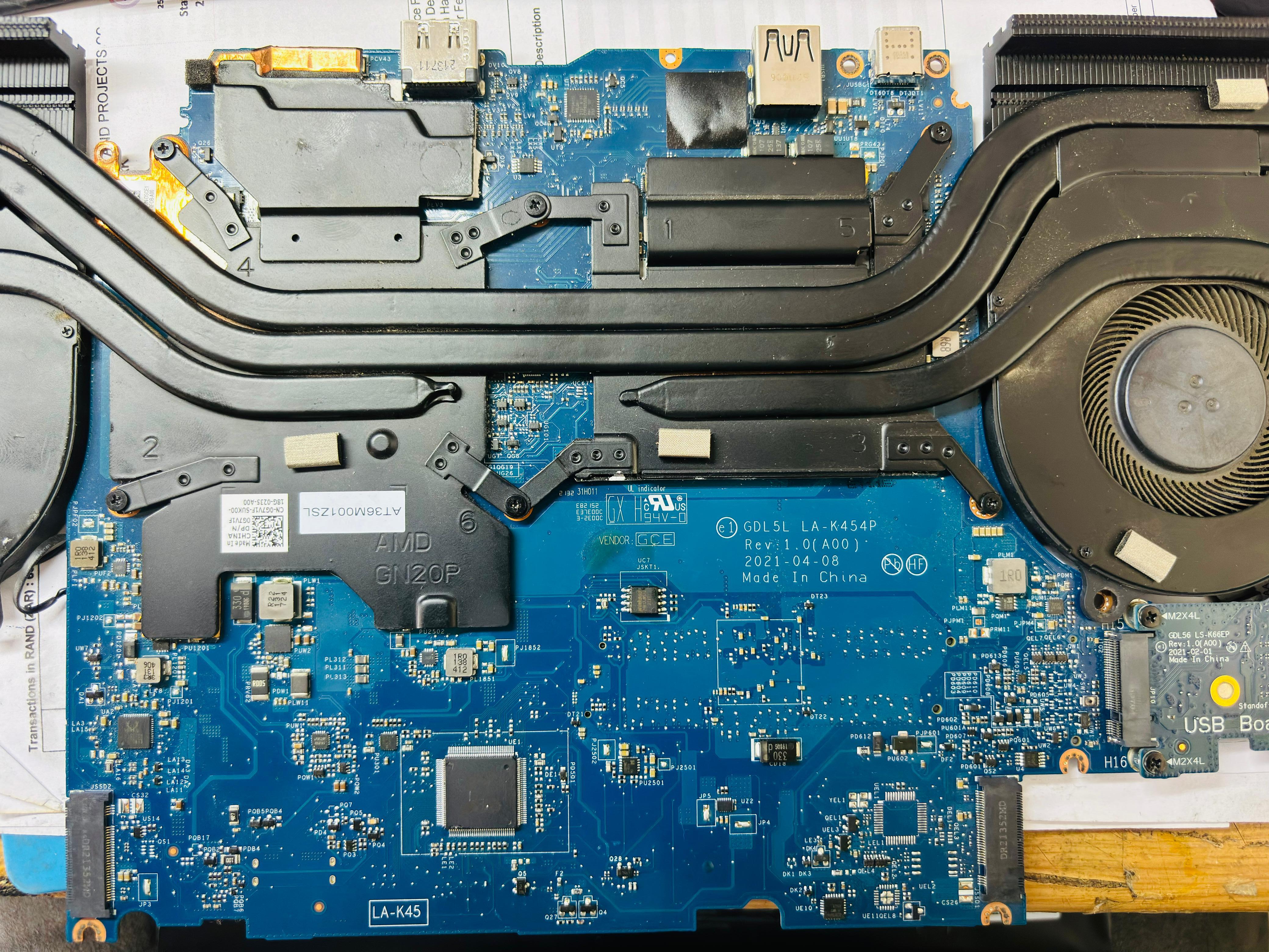

    DELL G15 RYZEN EDITION LA-K454P disable gpu
    by PacoGT
    Hi friends, I have a problem with this laptop. It gives me a processor error, but when I measure the processor, it has power, heats up, etc.
    But at first I thought maybe it was the BIOS. I tried reprogramming it, but nothing.
    After that, I measured the graphics card and realized that the graphics card has no power.
    So I lifted the power coils and checked that there is power, but when it reaches the GPU, they go to ground.
    With a thermal camera, I realized that it apparently has a short in a VRAM. After removing the short, it goes to the GPU.
    So my question...
