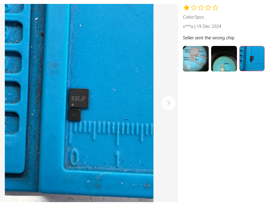

    PU9501 is shorted IC is marked as B3FNM but i am unable to find this icClick image for larger version

    B3*** SY8388ARHC P/T QFN-16

        The part number provided above is incorrect IC size is different

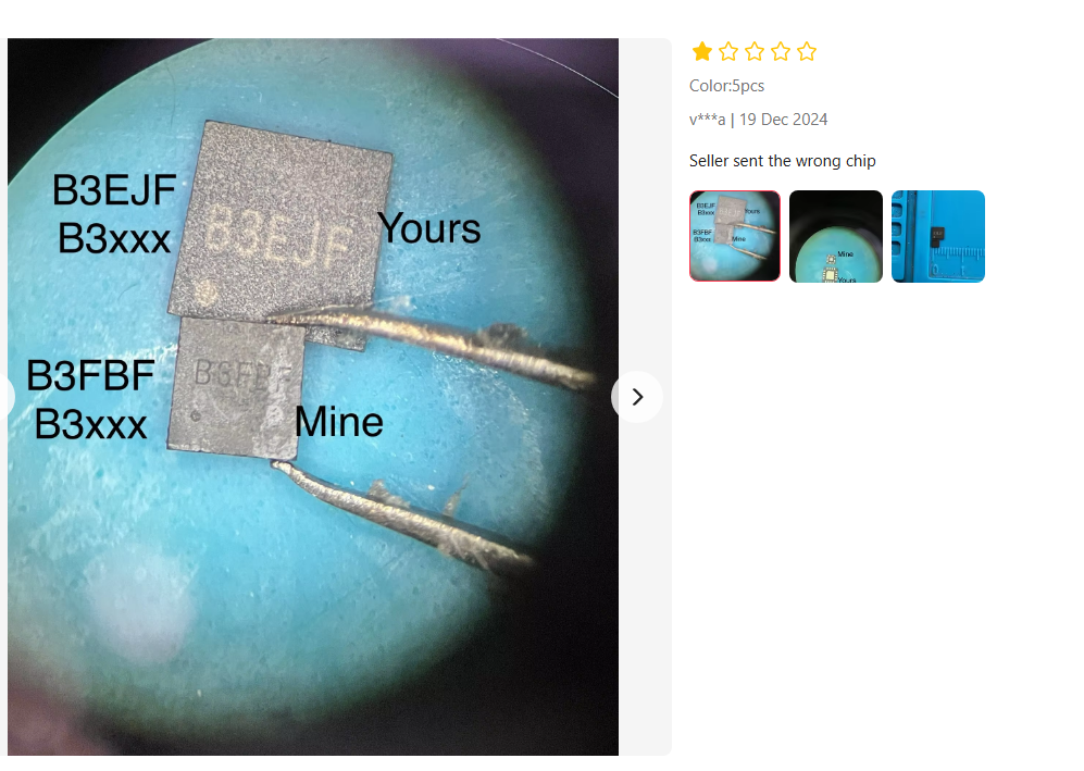

                          The vendor shipped the wrong part. Very confused about the shipped part size which may be a fake. There is a 1 star review on this same part on their website noting the same issue. Perhaps your review? Reach out to the vendor for a refund.
                          Suggest to source the proper and same part number from LCSC. We use them often for parts sourcing and also met them at an electronics fair in Shenzhen. Never had any issues with the quality of their parts.

                            Yes same happened with me, the review is not mine and I have already requested for a refund but I need to be sure that the part is exactly same, I mean these two ics have same markings

                              From the public documents, if the component has the B3*** SMD code, the part body size must be 2.5*2.5mm; QFN-16. To me, anything else is a fake. The larger packaged version of this part is with a different SMD code. Source it from LCSC. If the vendor truly believes the parts are the same, request a datasheet to support the claim.
