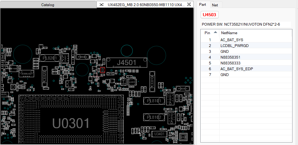

    Chip id help please
    letters on the component as in pictures - IC X08Y 2176
    the issue is with the main lcd backlight as iti is not getting power via the IC X08Y 2176 not sure what this is but must be kinda switching component for light as it is getting 15 volts in but not passing over ...... plan is to bridge in and out temporarily to allow for the customer to use both lcds after testing lcd not in short on the light side ......

    looking for bv and schematic

    model mainboard???

      ..... Click image for larger version
