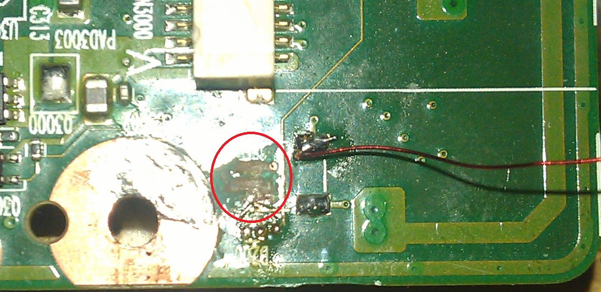

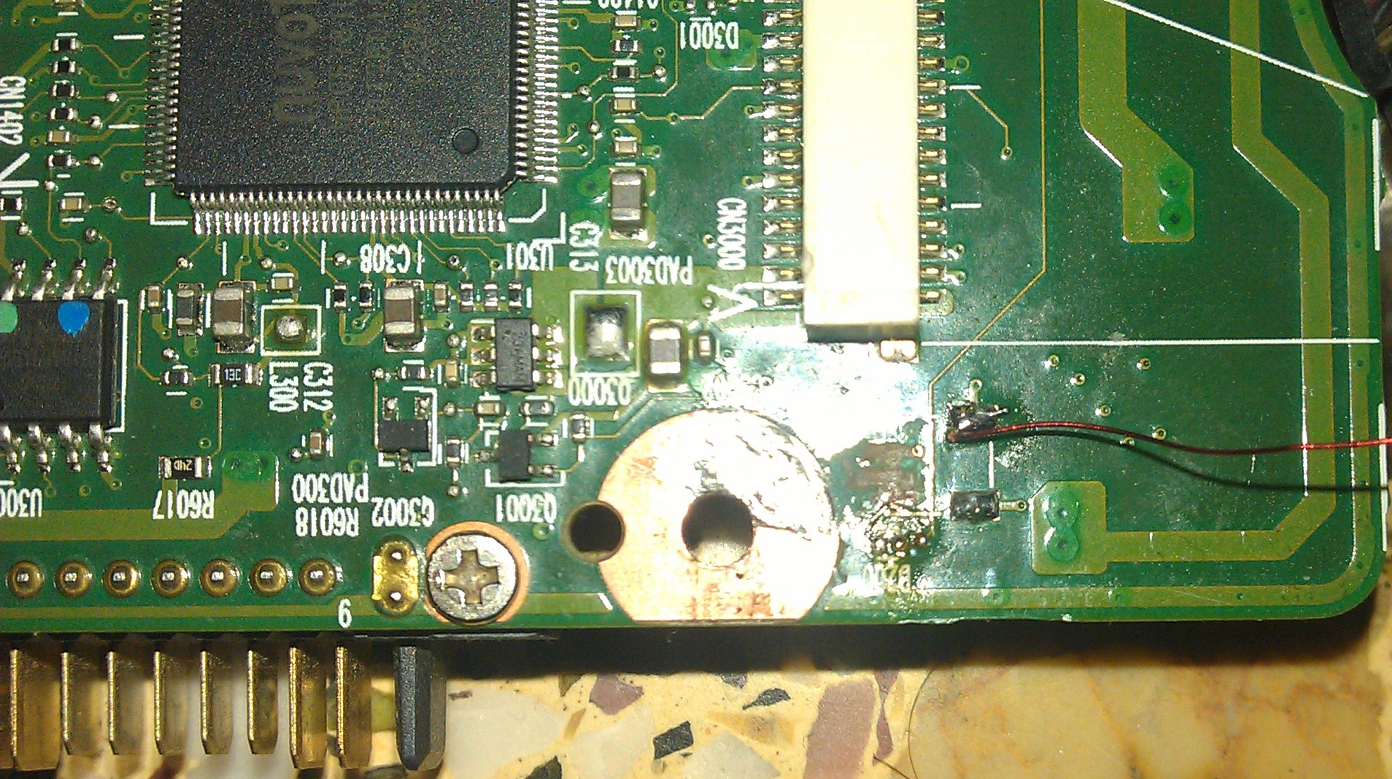

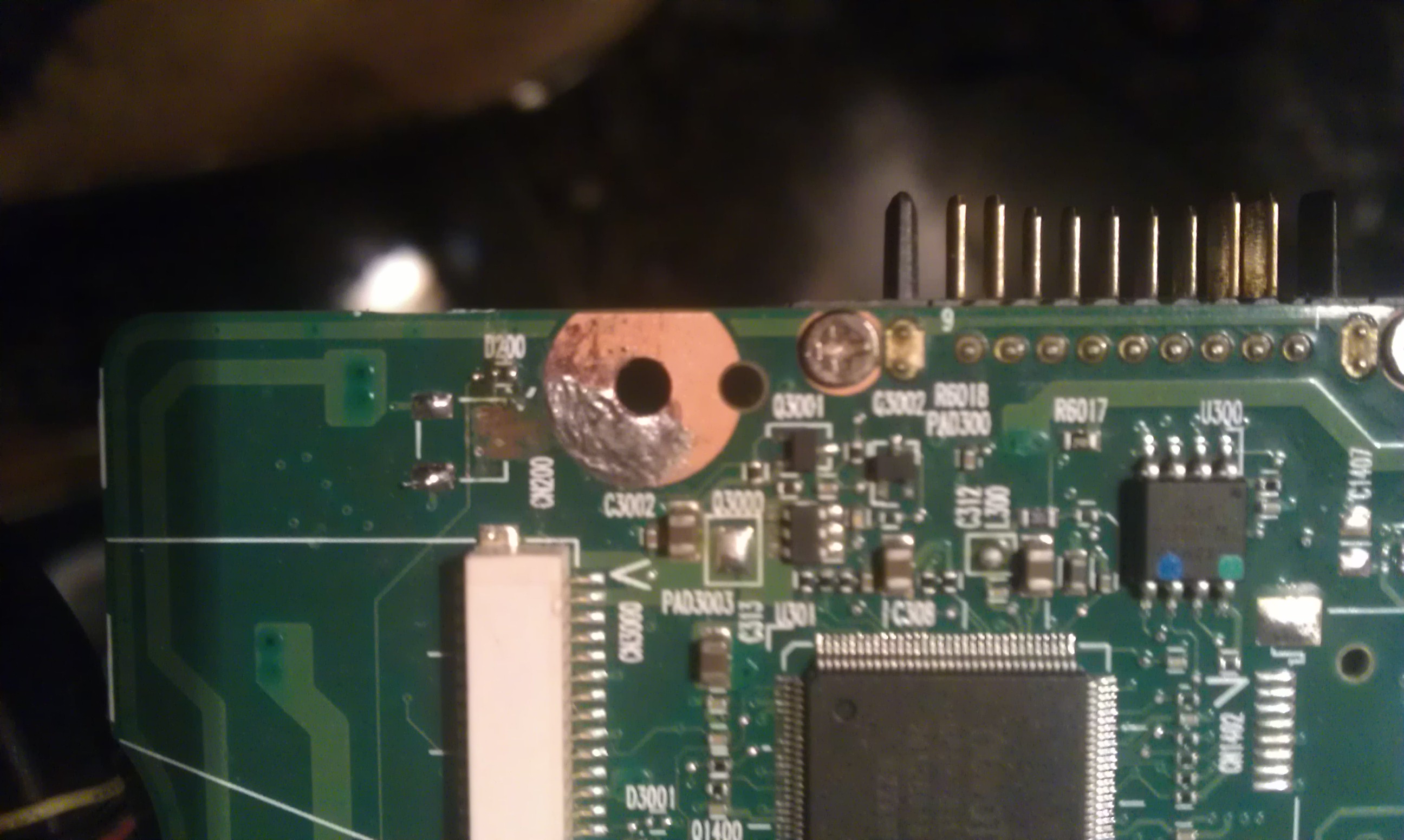

    Problem with power button connector i have the schematic but i cant find where i can make a jumper becase i broke the board connections.

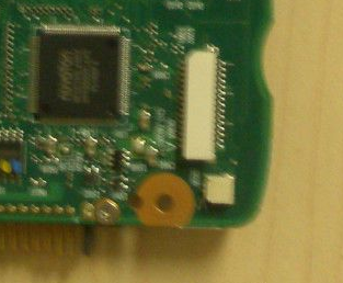

    That photo is blinded by the flash. Is that on main board or power button board?

      Re: Toshiba Satellite C650D
      That is the main board.sorry for the flash.
        still same image, slide to a different angle to eliminate flash
          And why do you post a photo of the LVDS connector? You need to find CN200.
            Stay near a lamp and disable the flash.
            if the cam or cellphone has good ISO you don`t need lamp.

              That part is missing i need to make a jumper for that i cant connect it there.
                Can you please post complete model, schematics and number of pins in CN200?
                  One of the pads is connected to KBC and the other is ground. For ground you can use the wire you have soldered. For the signal you have to scrape the green protective to reveal the line or you can solder it to D200 from the opposite site to ground (One side of D200 is to the ground.)
