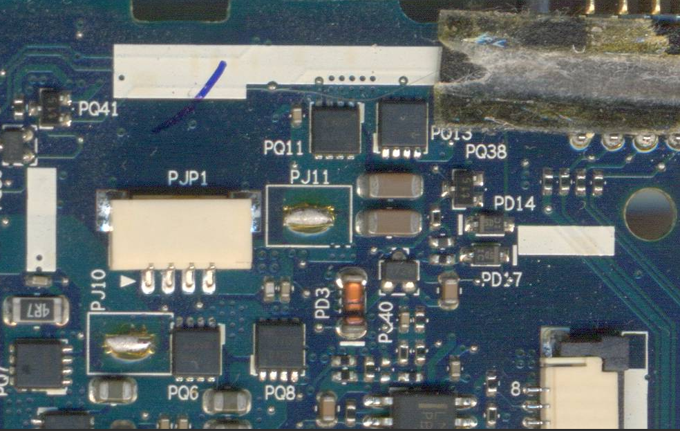

    Re: Acer aspire one kav60 d250
    ok so ive found a broken cap, here is a pics
    And A close up
    I know im a noob in this and stuff
    Thanks for any feedback
    Please gimme some hints.
    Im learning atm to study schematics, for the board and. my multimeter blew on me so when my new one comes in ill start testing again.
    anyway obviously bad cap could this be the problem for no POWER NO LED NO NOTHING except a buzzing sound. not loud faint.

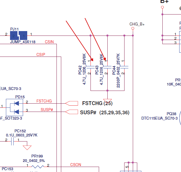

      Can someone please help me find a replacment for this cap in the schematics its 4.7U_1206_25V6K
      i think

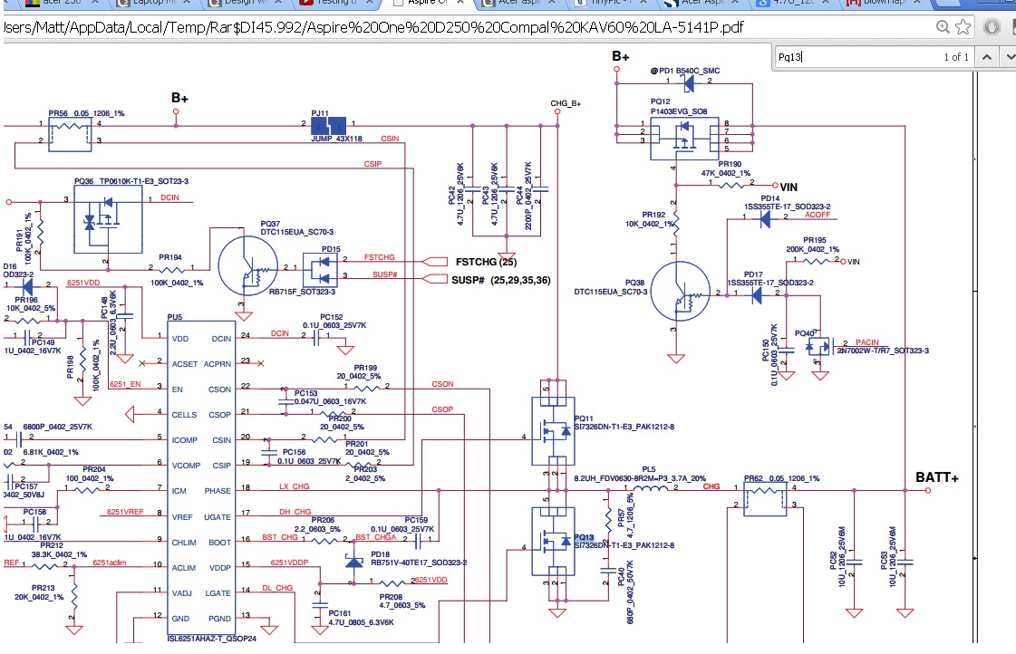

        here is the
        schem
        http://www25.zippyshare.com/v/7936844/file.html
        page 34 is what im looking at
        THanks
            edit: was looking wrong on the schematic.
            just get one on ebay. many seller have them.
            if you want to practice, better you get Kit of those things.

              About reading the diagrams
              4.7U 1206 25V6K <=- what do these numbers represent?
              thanks.
                    4.7U = 4.7 mikroF
                    1206 = housing dimensions
                    25V6K = 25,6V - maximum U

                      • drdyzio
                        • Apr 2014
                        • 74
                        how can damage such as this occur?
                        do you guys rekon it got knocked about while it was appart and broke. or just broke?
                                      Hey guys, so I've received the caps, 10 of them, wandering. Because I'm a noob.
                                      Is there polarity on these suckers? Or just mount them either way?
                                      Thanks.
                                      Hope this fixes the problem. ill get all my equipment over the next 2-3 days including hot air station.
                                      If I fix this I will reball it for experience. purposes
                                      chips are well small on these.
                                      Good practice for ati chips as they are normally very small as well.
                                      • Th3_uN1Qu3
                                        Believe in
                                        • Jul 2010
                                        • 6031
                                        • Romania
                                        Ceramic caps are not polarized. Any orientation will work. Polarized caps are always marked.
