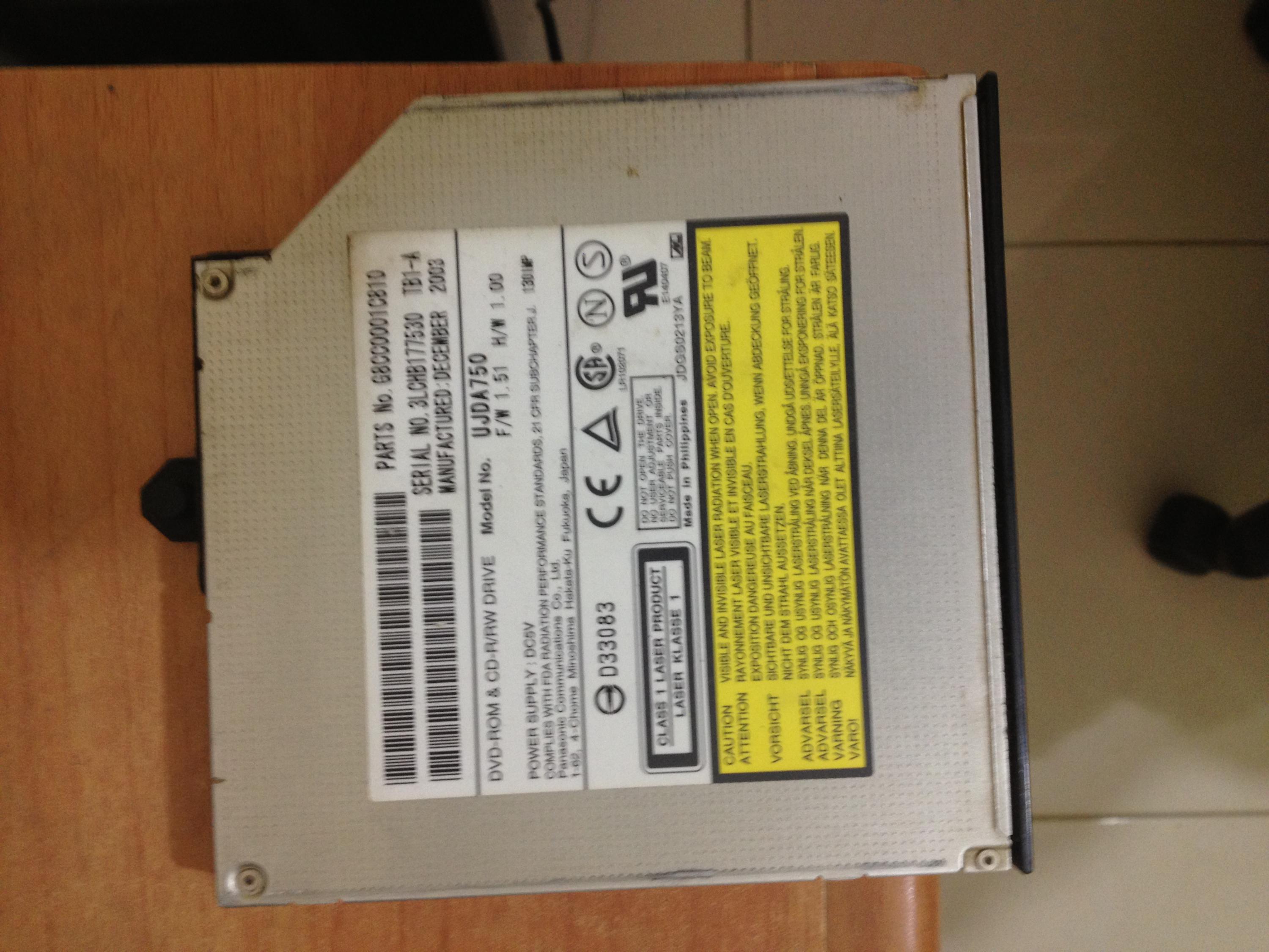

    Well after hacking the bios password,
    Found the HDD is bad, so i replaced it.
    Needed to reinstall XP, but this laptop can't boot from usb :-(
    Tried booting from CD but the DVD didn't read the installaion disc.
    Tried cleaning the lens with alcohol but with no luck.
    I tried replacing the DVD drive, but every drive i tried gave me
    IDE1 Error.
    The drives i tried, were good, took them from working laptops
    that were waiting for parts.
    Is it possible that the bios can work, only with the exact model drive?

      Re: Toshiba PSA40E-0EWDE-G3 replace DVD
      Thats good news, because i already bought the AC adaptor, HDD, hacked the bios, and ordered hinges.
      any ideas why do i get the error when using diffrent drives?
      • s_henya
        • Jan 2011
        • 483
        • Israel
        Bought the exact model of DVD including firmware (used from ebay)
        and it works like a charm,
        wonder why only the original model works....

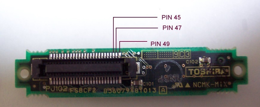

          • 31248
          probably just a difference between master & slave setting.
          i know some old laptop drives you could change the setting with a software utility.
          • ala_borbe
            aka Donald
            • 1625
            • Malta
            you could use google....
            http://www.daniweb.com/hardware-and-...e-1-error-info
            all you nedd to do is to put it in slave mode, hdd is already master, and you are ready to go
            ive done this, works 100% for toshibas....
                I would give five Star for the guy who found this work around. I really frustrated from this error message. I have Toshiba Satellite A45-S150. I bought SD-R6472 DVD burner. I thought I wasted the money. simpley I replaced new DVD Writer and it came out with IDE#1 Error message.
                I followed the instruction as stated in this website. I sutter pin 45 and 47. It took me a while because it was very hard to do, because of very small pin. After done, when I inserted, right away, I did not see error message. It fixed the problem. It READ/Write and working Fine. Thanks for tips.
                sometimes pin already shorted, in that case invert, desolder pin from logic board on odd
