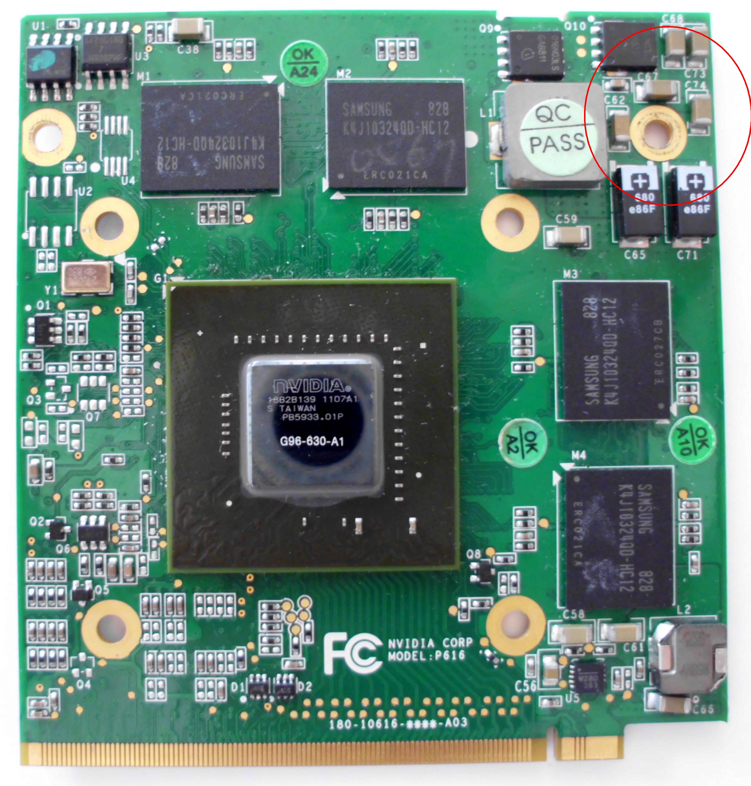

    Just posting this here for reference. I had several of those.
    These laptops use a NVIDIA GeForce 9600M GT graphic card.
    There are ceramic capacitors very closely mounted to a hole used to fix the board with a screw. The screw causes a deflection of the board and can also cause the ceramic capacitor(s) to crack and short. They are then shorting the power supply, you will hear some noise when it tries to start.
    Will cost you a $1 or $2 instead of a new graphic card.
    Cracked SMD ceramics (the brownish ones) will often show a visible discoloration.

    hye. my name is boon. i have something to ask, my laptop Acer 6935g wont turn on. already dissemble everything. and when ever i plug it in the charger, there was some tiny noise around the motherboard. already remove graphic card and possessor, still got noise. maybe there is some short component? is there is any way to detect which component dose the sound?
    email - ****************
    please help me
