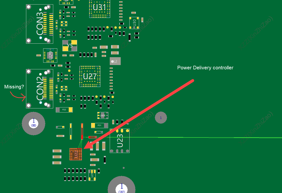

              The boardview diagrams in my database appear to match your board. How are you powering this logic board? Through a USB Type C power adapter? Would you have a USB type C meter? What voltage and current draw do you see with the USB Type C meter? If you do not have such a meter, it is a good investment and available through Amazon / Aliexpress. Useful for quick checks for the USB type C power adapter.
              By default, upon power up, the USB Type C power supply will offer 5 volts. Only after a proper negotiation with the PD (power delivery) controller on this logic board will the voltage and current draw change to something else. That is, the PD controller will request from the adapter, a full list of PD contracts (voltage & current pairs). After this list of PD contracts is received, the logic board will then select the best PD contract to power the board. Often, this will be a 20V contract.
              Noting this, it is important to know what is the PD contract being selected or is it the power up default.
              Also, are you missing one of the USB C connectors in the lower left of your posted pic? The BV shows that there should be a connector onboard.

                Thank you so much for getting back with me. I value any help you are able to give. I did get the boardview on XinZhiZao site, but unfortunately it doesn't seem to have the schematics. I do have a USB C meter reader. I'm including a picture of it plugged into the USB-C port. It does seem to thave the 5v, but does not go to 20v when the power is pressed and or at anytime. With that, I'm thinking that either the 5v isn't getting thru to where it needs to go for the contract or handshake. Or something else is going on. I've tried other adapters and the same thing. And Yes...it is missing one of the USB-C ports. It came in like that. I was thinking that it does not need that one to power up. The other one I have to do micro surgery on and resolder back on properly as it was loose. I should be able to just use that one to power up the laptop, once I figure out the handshake/contract issue...correct? Thank you.

                      You have 0A of current being drawn so there is 'no load' on this VBUS pin of the USB Type C connector. Suggest to google and search for a datasheet for any USB Type C connector (which is a spec so almost any datasheet should match your connector) -> review the location of the VBUS pin. Then proceed to select that pin on the BV drawing and see who lights up in the CAD tool. Continue to trace till you can locate a fuse. Hoping there is one in the path. Often will be with a 'F' prefix. Once it is found, meter in resistance mode -> test the resistance of that fuse to see if it is blown or not. Post the resistance. Summary - there is no current draw so there is a break in the power path from this USB C connector to the main power rail.

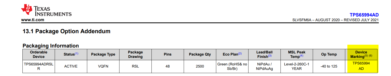

                                What are the full topside markings on the TPS65994?
                                Is it this device?
                                TPS65994AD Dual Port USB Type-C® and USB PD Controller with Integrated Source Power Switches Supporting USB4 and Alternate Mode datasheet (Rev. A)

                                  Here's the full markings on the IC (U22) TI 04AFFP8 TPS65994 . I think its the same, but no AD at the end. I'm attaching a photo for you of it I just took.

                                      3rd line = 'AD'
                                      Click image for larger version  Name:	markings.png Views:	0 Size:	83.1 KB ID:	3334684
                                      Use the datasheet from this webpage to study the pins used to drive the external mosfet.
                                      TPS65994AD data sheet, product information and support | TI.com
