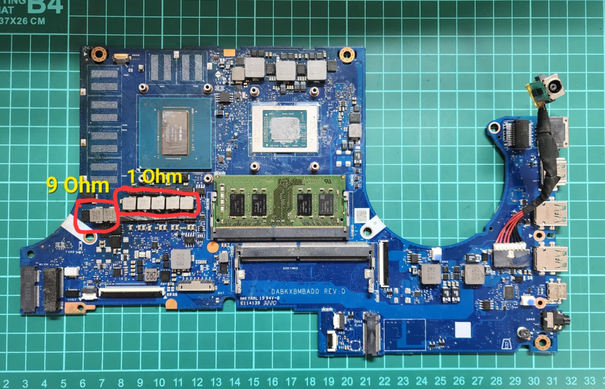

    Good day Guys ! Im have a board having issue on error 43, i diagnose using mats to know what is the causing of error 43 and its 6 vram. I remove all of vram that casue the error. The board still working thru onboard GPU, when troubleshooting this i need to liftup or remove the GPU coils to work the board, is that normal? because when the GPU coils is connected the board doesn't boot. Any inputs or suggestion on same repair issue. Boardview, diagram and board w/ resitance check on coil pic posted. Thank you
    • 21841
    Please post a link to the boardview. Reminder: rules and organization of this section https://www.badcaps.net/forum/troubl...f-this-section
