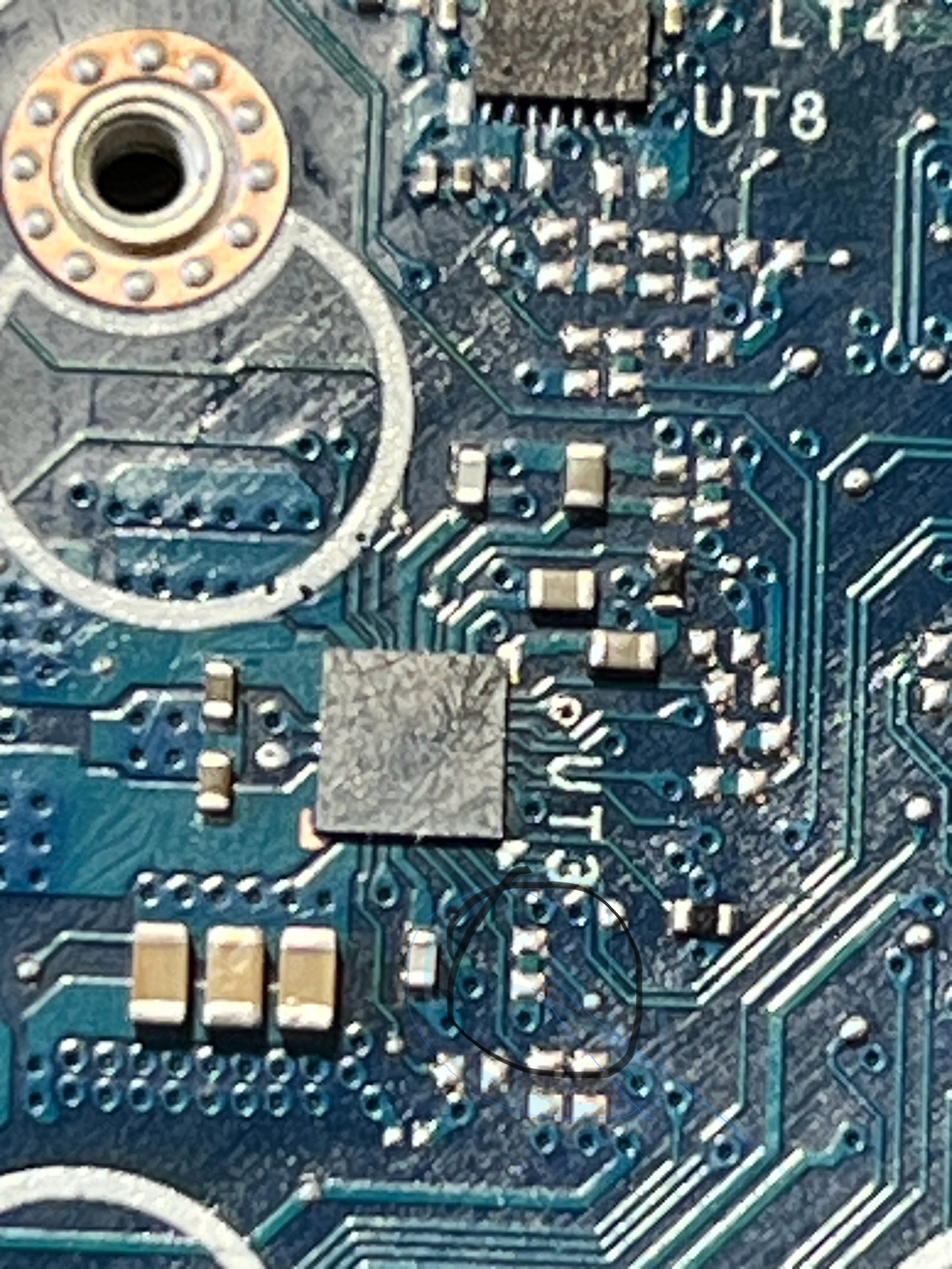

Dell latitude 5440 does not turn on after a short 5v
  • antibotan
    • Feb 2020
    • 42
    • Ukraine
    La-m401p
    The board after a short circuit of 5v, everything was done and replaced the faulty components, the duty voltage rose, the board turned on from the battery, but the power supply does not see, or rather from 5 yuv does not raise to 20v
    t was replaced by tps65994, but it did not lead to a positive result, I did not find any schemes for this board, maybe someone has already encountered such a malfunction

    check all coil for short and all power rail is present

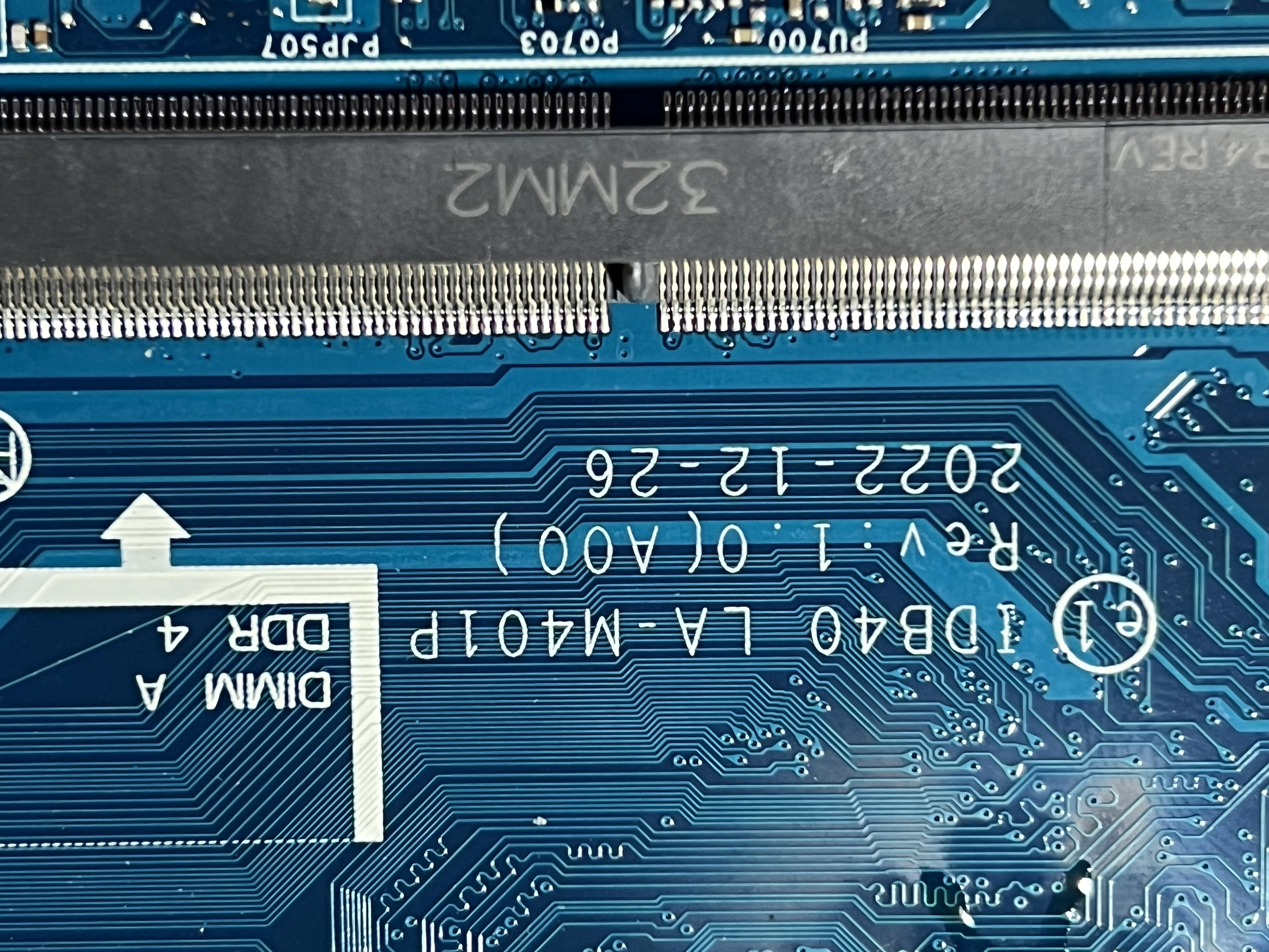

        Board number: VAW30 LA-9832P Rev1.0 (A00)

          no!
          La-m401p

              I have this motherboard available outside the computer. If you need me to take measurements in certain areas of the motherboard, let me know.
              You mentioned tps65994 chip. I would try to see whether all pins make a good connection with the motherboard. Remove the chip, tin the pins again, use good amount of flux, then resolder the chip. After you do that, get the schematics on the tps65994 chip. See if the voltage reaches the chip, check all caps around it.

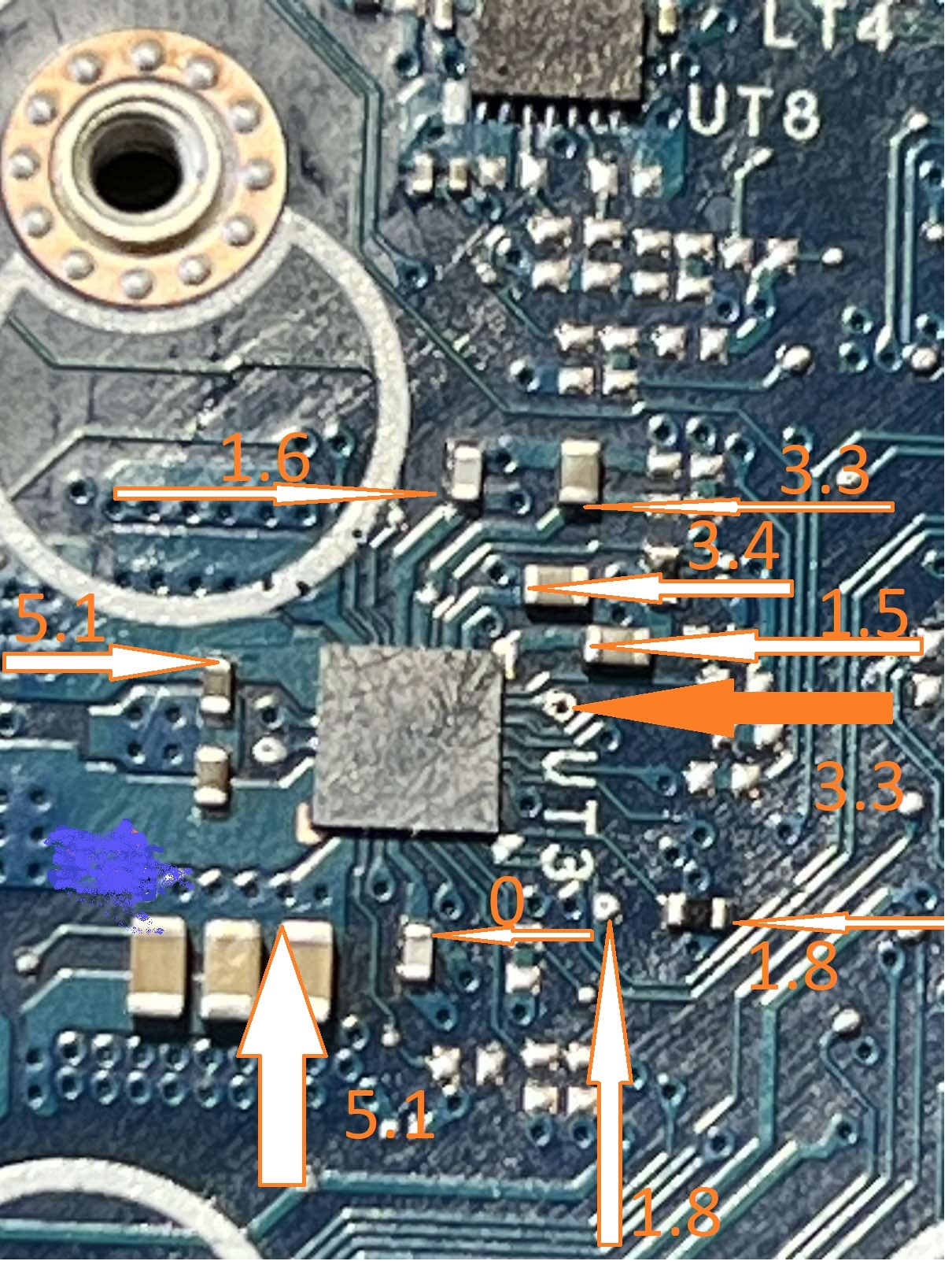

                  I changed 65994 several times, tried different ones, the voltage coming to it is 5v, 3.3v, 1.5v, but 19v never rises, the laptop turns on from the battery

                      Here are my measurements
                      • antibotan
                        • Feb 2020
                        • 42
                        • Ukraine
                        Measure who is what voltage with the connected type-c at this point
