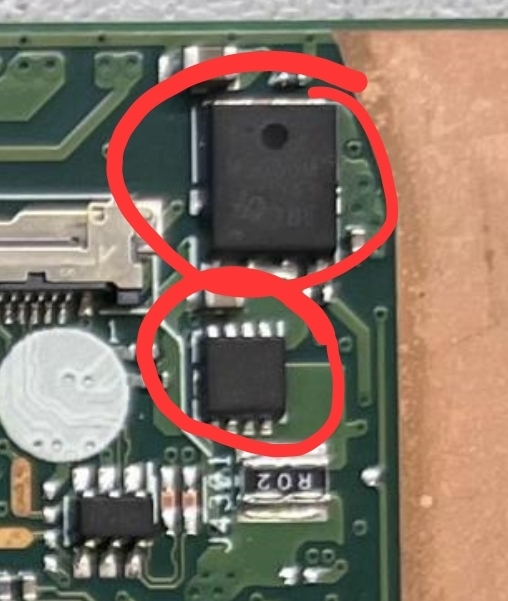

            I have now located both mosfet near the said resistor. One that is further from the currency sensor have 18v going into it. But has a 3v at the gate. Therefore what should be the 2nd mosfet has 3v at source and 3v to gate. Might this mean a shorted 2nd mosfet?. I shall get the part numbers from the schematics. My wife has a clever camera phone but I do not. The 2nd mosfet is the same one with odd resistance of 0.02

              It is important to share the full details otherwise the case will take much longer to resolve.
              Meter in resistance mode.
              Measure the resistance of the mosfet:
              source (1-2-3) & drain (5-6-7-8) ; place a meter probe on any pin of source group / other probe on any pin in drain group
              source (1-2-3) & gate (4)
              gate (4) & drain (5-6-7-8)
              Post each resistance with units of measure in ohms. Not sure what 0.02 means. Take pics of the meter face if required to post here.
              Measure each of the mosfets. From the measurements we can determine if the mosfet is defective or not.
              Units of resistance will be ohms; kohms (thousands of ohms); Mohms (mega ohms). The units are important to note.

                Okay I was measuring in diode mode. Let me do in resistance mode. You right it looks like a hole but actually a marking or so. The picture I shared is from someone here who had a bad battery case. So his tantalum had that hole-like mark and so does mine it appears.

                  1st bigger mosfet is part number: PQ8901
                  2nd mosfet: PQ8902

                    With my meter function set to 200k res range, the first mosfet keeps counting up (was near 200.0 at some point). The 2nd mosfet start from 01.0 and within a second or so counts down to 00.0
                    Assuming the 2nd mosfet is shorted?
                    if so, can I temporally jump it until I have a replacement? I understand it could be risky but I am to run the PC without a battery (since they both last locked up after years of use) and so I hoped it could perhaps work to my advantage somehow. I will understand if the battery's absence will on the other hand only amplifies the risk - and gladly wait for the replacement part.​

                          When set to 2000K resistance range, the 1st mosfet counts up to about 730 (it seems) and then start counting back slowly. The 2nd mosfet counts back from around 050 to 000 within some 2 seconds or 1 and then stay there. The screen will show 725 for example with no decimal at all. It is the cheap DT-830B so perhaps it is very limited.

                              And get rid of the 200K range please. Way to high to detect a real short-circuit. 200 (without K) Ohms range works perfectly fine for most of the cases.
                              I'm convinced, one of the DC-IN Mosfets is the origin of your issue as already more or less confirmed in post #14. but to confirm and to solve that, we need to stop moving in circles right now.

                                To the best of my recollection the meter (in resistance mode) would not display a reading for any of the two mosfets unless I set it to 200k or 2000k but I shall retry this to confirm. Post#14 was done in diode or continuity mode but I see I went on to infer to the readings thereon as resistance (instead of voltage drop?) in some of my succeeding posts (my bad - I am admittedly a newbie in these, trying to fix my own mobo). As suggested, I shall retry measuring at a 200 range first and then feedback.
                                Sephir0th
                                Yes, those are the mosfets I am testing. And the smaller looking is the one which had 0.02 reading in diode mode.

                                  Smaller mosfet has a reading of 02.0 when set to 200 range. Bigger mosfet will only have a reading from 200k range - counting up front around 35.0 going up.

                                    The "smaller" Mosfet is internal shorted and need to be replaced. After that the board should work again.

                                        Short version: Laptop now working with a bypassed mosfet (yes, I understand the inherent risk and can only hope in God's mercies and goodness that the spare part will find the laptop still in one piece).
                                        Long version: After failing to cleanly remove the mosfet with a soldering iron and added solder, I had to carefully scratch up the black part of the mosfet with a pin, and broke it further with a long nose. After uncovering the greater part of the internal plates I applied solder and then the plates slid off.
                                        Connected drain and source and then went to analyze this (again): https://electronics.stackexchange.co...l-in-a-laptop#
                                        When the risk seemed somewhat calculated, I plugged in the AC and the PC came on.

                                          Except that this answer is not related to the question that was asked. The answer is about the protection MOSFETs of the BMS, which is the circuit on the battery itself, whereas the question was about the DC-in MOSFET of the charging circuit, which is on the motherboard.
                                          Both circuits have back-to-back MOSFETs, but they do not serve the same purpose.
                                          The DC-in MOSFETs act as an overcurrent protection by switching off the reverse MOSFET when the current flowing through the DC-in current sense resistor is too high.
                                          The DC-in MOSFETs act as an undervoltage protection by switching off the reverse MOSFET when the input voltage falls below a certain threshold (either normal if AC adapter is unplugged, or abnormal due to defective AC adapter, too much current draw on the AC adapter that hasn't entered protection yet or too much resistance, all of which could cause further catastrophic issues).
                                          Similarly, the DC-in MOSFETs also act as a reverse discharge protection by turning off the forward MOSFET when the AC adapter is unplugged from the wall but still connected to the machine, so that the battery does not discharge into it.
                                          The DC-in MOSFETs can act as an inrush limiter, which means limiting the amount of current flowing when the main power rail is completely discharged (that current can be high because there's a lot of capacitance with low impedance on this rail) by turning the reverse MOSFET on gradually.
                                          So no, I cannot say that bridging a MOSFET is a reasonable idea. It'd be even worse to do that on the BMS circuit of the battery itself btw.
                                          Since the failure happened after a reverse polarity event, it sounds like an even worse idea to bypass protections now.
