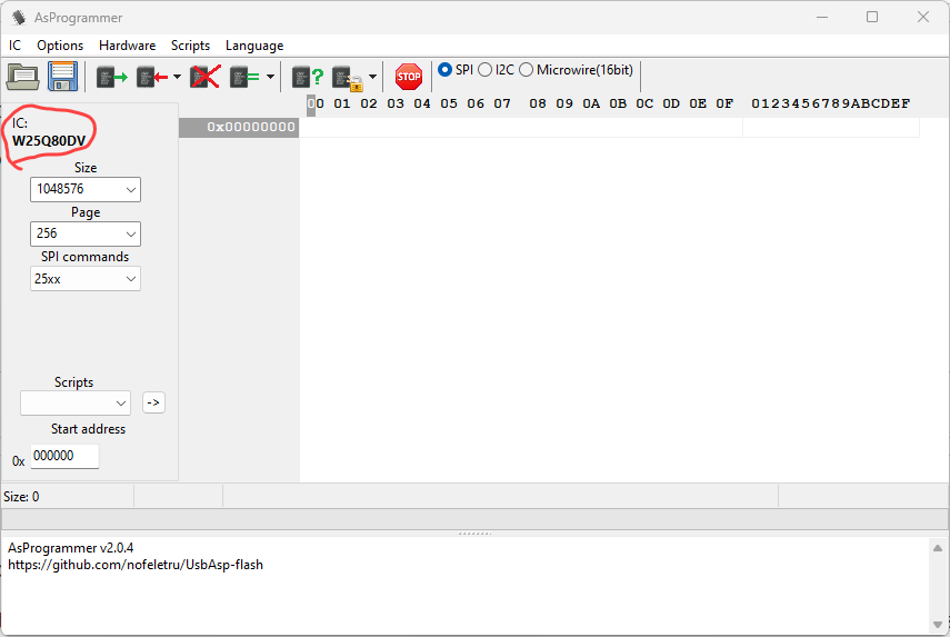

          Ok - found your s/w on github via Adafruit chats.
          Try this tool and post your results.
          Releases · nofeletru/UsbAsp-flash (github.com)

            AsProgrammer is for Windows, I'm on Lunix so tried flashrom. It identifies the IC so I did 4 reads and compared them. Different each time :-(
