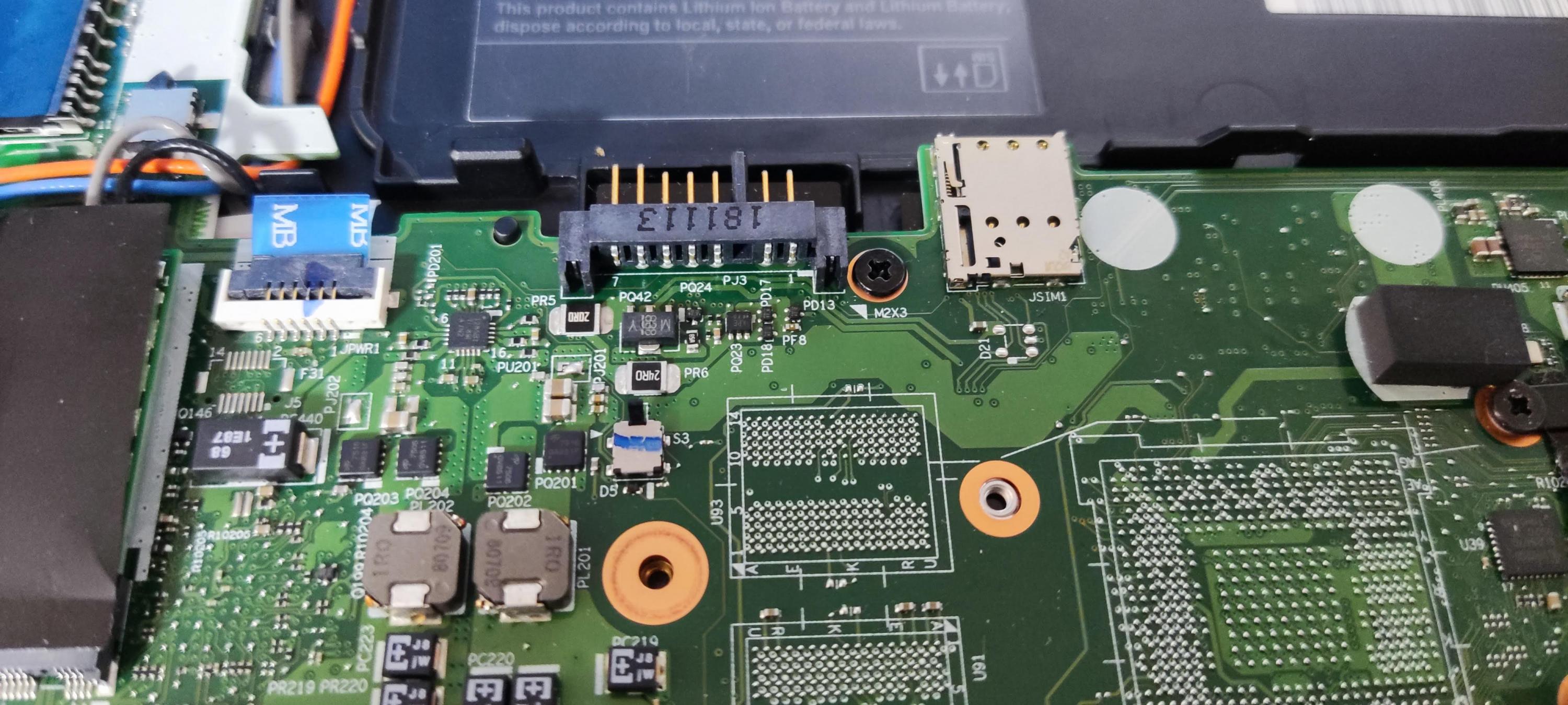

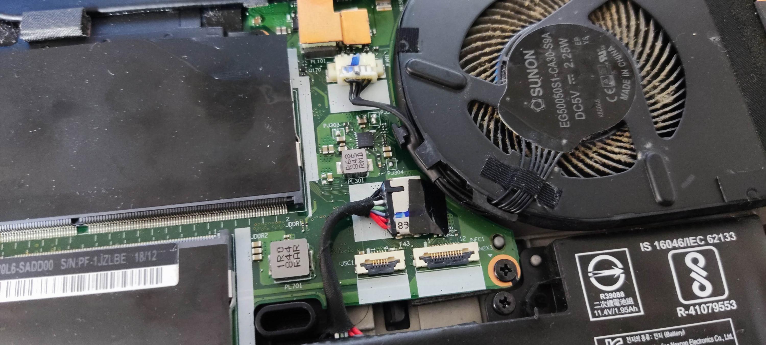

                    • gsoft
                      • Jul 2023
                      • 38
                      • Italy
                      Re: Thinkpad T480 Thunderbolt problem not charging
                      Originally posted by mon2
                      Does this laptop boot normally if the adapter is connected? It should, even if the battery is connected but not fully charged.
                      Do you have the schematics for this unit?
                      Regardless, locate on the board the charger IC which will be near the battery connector. This IC will follow the thunderbolt controller and it will use the adapter voltage to charge the battery. Once we know the charger ic topside markings, we can debug this fault.
                      Post pics and more details of the charger IC.
                      No, do not recommend external hacks to charge the battery, etc. It should not be required.
                      Thank you for answer.
                      No the laptop not boot if adapter is connected, and yes if battery if not fully charged it boot. I attach the image of the two batteries connector so you can help me to identify the charger IC.
