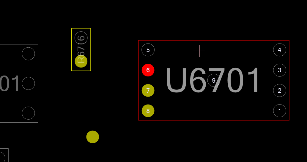

    I need to flash the thunderbolt eeprom, laptop now fails to charge or power on. Can anyone confirm the IC? I think it is u6701 but I cannot read the chip (read the text on the top I mean). I don't see anything else that really looks like it would be it.
    Could anyone help me out if this is the correct one? I am new and still learning some so I wanted to be sure.
    Thank you!
  • mon2
    • Dec 2019
    • 14239
    No. U6701 has pins 6-7-8 grouped together. This is not normal for a flash IC.

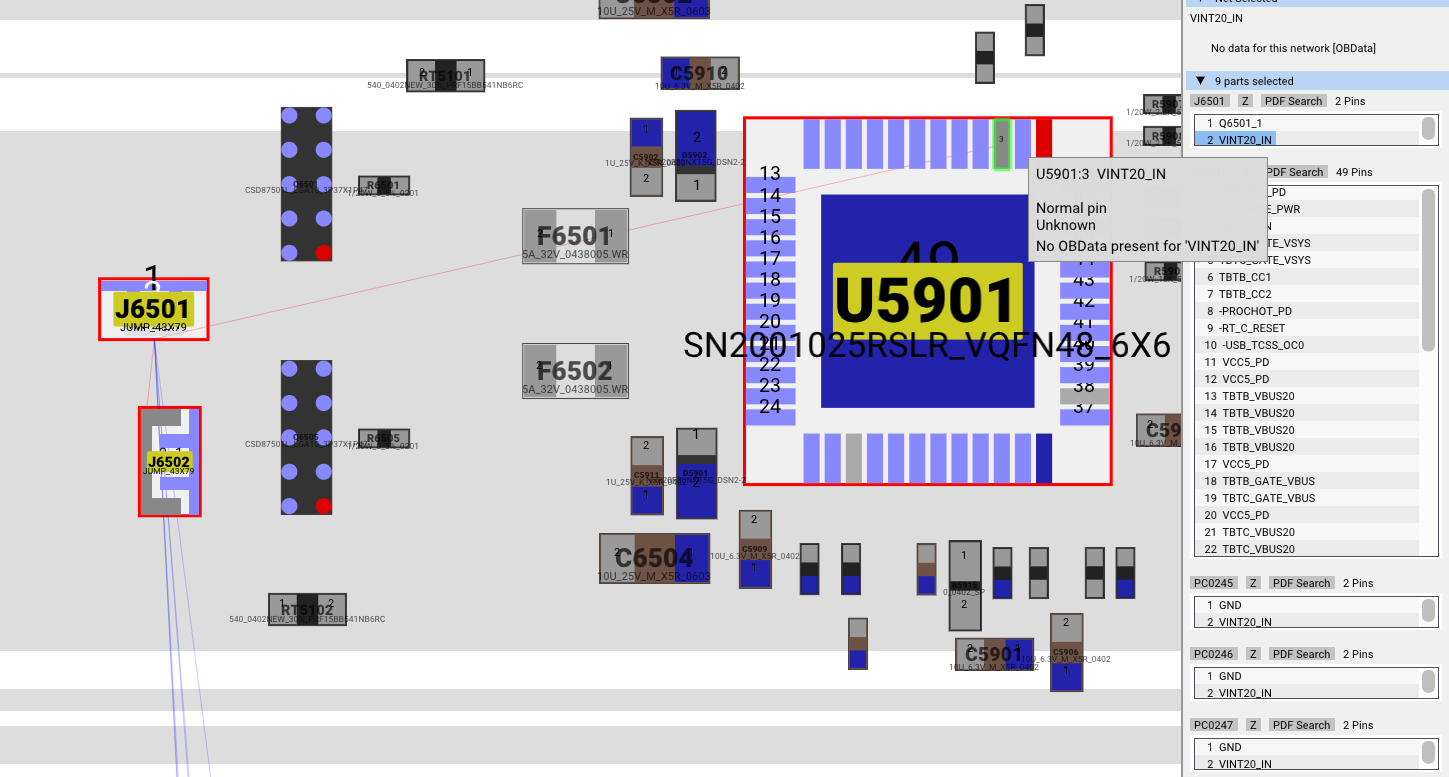

                        Wondering if this is even a tbt issue at this point. I just kind of assumed it was. I JUST noticed some signs of someone poking around with a soldering iron. There's J6501? 9501? crap now I forget. Was just about to pull that up on the board view. there's 2 pads, 01 and 02, that for sure looks like fresh solder is on them. Messy, looks like one pad may be bleeding over to a via. The only other *something* is a very small cap seems to maybe be missing? It doesn't look like an unpopulated pad, it looks like it was knocked off. But it's no where near any power stuff, nor is the board labeled anywhere in that area. Ideally I can remember where these components were to find on the board view. Probably should have taken a pic or wrote something down.
                        • Whale linguini
                          • May 2024
                          • 30

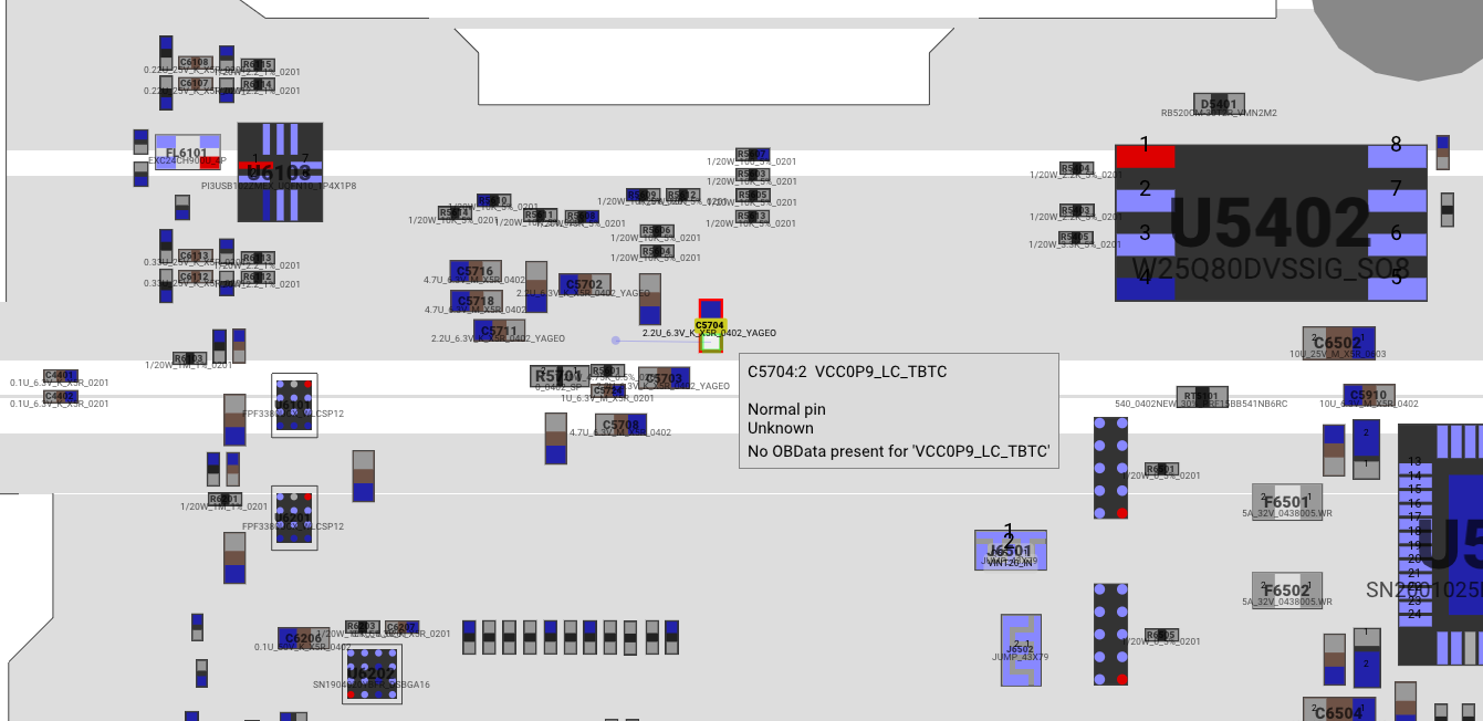

                          J6501 and 6502. Looks like they should be jumpered, guessing someone just reflowed them to be sure. Trying to get a picture of things but I am still trying to figure out where I set my phone down. There may be 2 small caps that.... I just cannot tell if are unpopulated or missing that are near the usbc/tbt port.
                          • Whale linguini
                            • May 2024
                            • 30
                            c5713 and c5704 are MIAClick image for larger version
