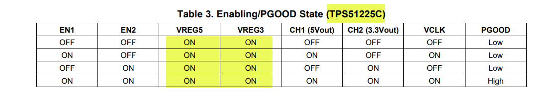

    Attached is the datasheet for the TPS1225C (PU301 on the pcb silkscreen) which will be supplying your always on rails for the 3v3 and 5v0 power.
    Confirm, carefully the voltage to ground of VREG5 and VREG3 on this component. Post each measurement.
    If you do not see these always-on rails, next confirm if the VIN pin 12 has a valid input voltage to create these LDO rails.
    If yes, then check the voltage to ground of the respective ENABLE pin voltages @ pin # 20 and pin # 6. Each of these enable pins must be a logic '1' to enable the respective always-on power rails.

        My bad...on the TPS1225C, the VREG5 and VREG3 are always-on as documented in the datasheet. Next of concern is that the EN1 and EN2 lines are at 0 volts so the inductors that are linked to this regulator will be OFF. That is, the low current VREG5 and VREG3 are fine at the measured values but the heavier current rails are OFF. These ENABLE signals are most likely being driven the local EC that is onboard.
        Perhaps the EC is defective? Not familiar with EC programming but check if there is a local flash device nearby this controller (or it may be embedded inside this part).
