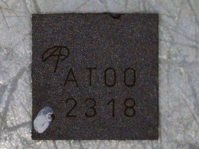

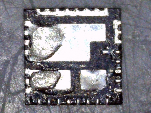

    IC Identification and source or alternative for A&O AT002318
    This is a power regulator/driver for the CPU of an HP 15-FD0008CA that is shorted and overheats. It needs to be replaced but I can't find a datasheet nor source a replacement. My many searched have come up blank. Any help will be gratefully received.
    • 21196
    https://www.badcaps.net/forum/troubl...41#post1538441
    • LarrySabo
      • May 2015
      • 29
      Thanks so much for that link! So it looks like my device is an AOZ5016QI. I'll order some from DigiKey and hope for the best.
