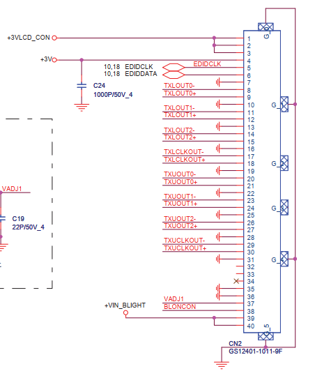

    Hi again guys. I have this motherboard that won't show display even tho it was doing it yesterday. I think something could've past away in the circuit.
    I'd appreciate if anyone who is used to MOBO LCD voltages and circuits could enlighten me since this is the first time I have to deal with it.
    I'm missing +3VLCD.
    This is the circuit
    Click image for larger version  Name:	image.png Views:	760 Size:	50.6 KB ID:	3284862 Click image for larger version  Name:	image.png Views:	225 Size:	38.2 KB ID:	3284863

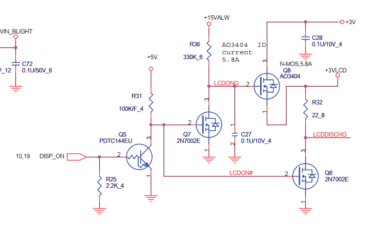

    With laptop OFF:
    Values in LCD motherboard connector:
    +VIN_BLIGHT: 19.55V
    +BLONCON: 0V
    +VADJ1: 0V
    +3V: 0V
    +3VLCD_CON: 0V
    Also some voltages I assume are important here:
    +15VALW: 12.8V
    LCDONG: 12.4V
    LCDON#: 0V
    DISP_ON: 0V
    With laptop ON:
    +VIN_BLIGHT: 19.55V
    +BLONCON: 0V
    +VADJ1: 0V
    +3V: 3.3V
    +3VLCD_CON: 0V
    +15VALW: 12.8V
    LCDONG: 0V
    LCDON#: 5.06V
    DISP_ON: 0V
    Is very strange to me how in R36 has 12.8V in both ends when laptop is OFF, but when laptop is turned ON, one end has 12.8V and the other one is 0. Blows my mind.
    I don't know the timing of these voltages/signals but this is my conclusion:
    -GPU is not giving DISP_ON signal; therefore
    -Tansistor Q5 is not pulling +5V to GND
    -+5V
    reaching Q7-Gate and now pulls +15VALW to GND
    -+15VALW doesn't turn into LCDONGate, therefore
    -+3V don't go through Q8 for +3VLCD
    I'm very noob still but I'd like to know if anything I said makes sense.

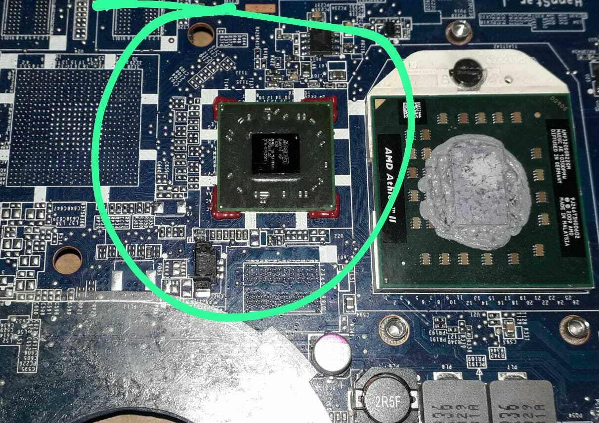

      Does your mb has discrete video chip? If yes, then its the video chip gone bad. Thats the norm on discrete models of CQ42.
      • gjgib
        • Nov 2022
        • 70
        • Venezuela
        mcplslg123 Thanks for answering. So, is my conclusion accurate?
        Btw I took this picture. I assume this is discrete since it's not integrated inside the CPU(?

          I think I might be wrong in some way. DISP_ON signal is supposed to shut down Q5 INVERTER transistor. So, since DISP_ON is not there, +5V is going to GND through Collector to Emitter, therefore, not turning into LCDONG.
          Very interesting stuff.
          Conclusion will update like this:
          -Tansistor Q5 is pulling +5V to GND
          -+5V not
          reaching Q7-Gate and not pulls +15VALW to GND
          Seems weird to me that +5V reaches Q6 GATE but not Q7 GATE aswell. Schematic design couldn't show properly why?​

            It appears that your board has the "popular" AMD 216-0752001 North Bridge chipset with a built-in GPU, which is known to have such issues. One method to verify it is by applying hot air to the chip for a short period. If it temporarily starts working again, it could confirm the issue, although this is not a recommended solution.
            It's worth noting that most 2001 "new" chips on the market are remarked, meaning they have been rebranded, so replacing the chip may not resolve the problem.

                        Also, how would you interpretate the circuit that I posted first? I mean, what are the parameters to have the missing +3VLCD.
                        • alexfts20
                          • Jun 2023
                          • 30
                          • Kyrgyzstan
                          gjgib You don't have DISP_ON​ which comes from 2001 chipset. Please check PM.

                                  Thanks for insights. I did the reflow on the 2001 GPU chipset since customer wanted to try. You guys were right, it came back to life but went off again. What does the reflow do exactly in that case? 'Repair' the structure within the chip and make it work or is it something with the BGA solder? Now I'm shipping in the stencil because customer wants me to try reballing since she saw it work and plus got nothing to lose and I can practice manual reballing.
                                  What do you guys think?
                                  • piernov
                                    • Jan 2016
                                    • 4439
                                    • France
                                    It is probably a similar effect as with the Nvidia "bumpgate" ICs (https://www.badcaps.net/forum/troubl...vidia-bumpgate), where heating the IC to a high temperature softens and expands the underfill and the bumps between the die and the substrate, which causes them to make contact again. But thermal cycles will deteriorate it again. This is not about the balls between the IC and the motherboard, but between the silicon die and the substrate of the IC itself, hence why reflowing and reballing is useless.

                                      piernov Ohh, I didn't get before why people was so pesimistic about this. Crystal clear now.
                                      Very interesting stuff! Thanks a lot for the insight, piernov. I'm digging more about it.
                                      Thanks to everyone who contributed to the post.
