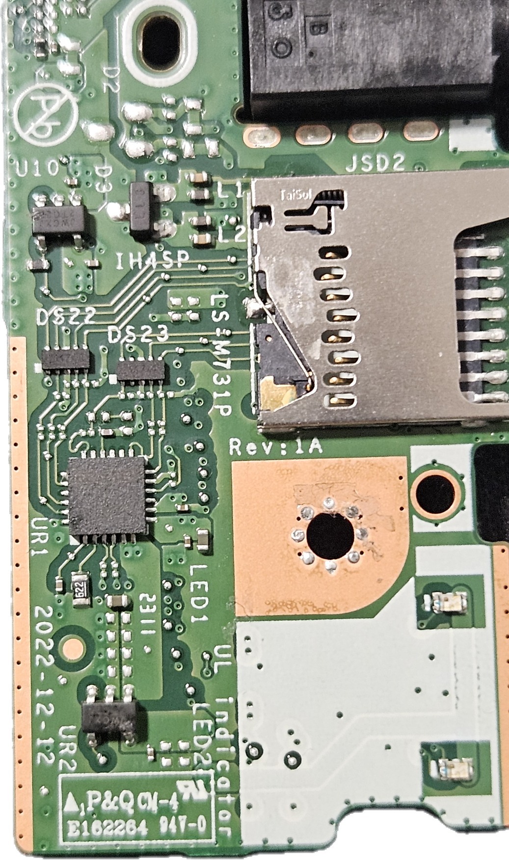

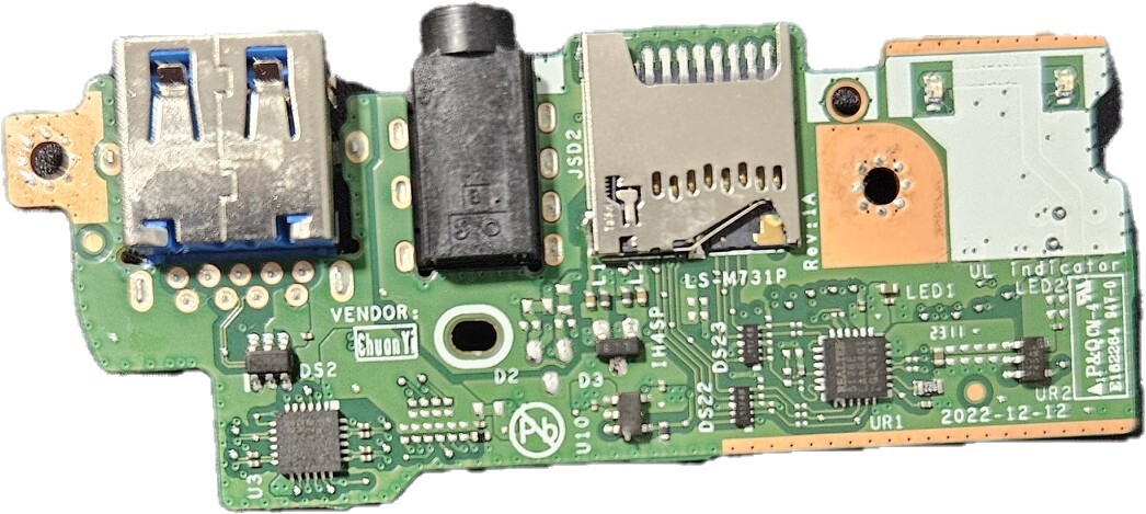

    I have a:
    Laptop (Acer Swift Go 16)
    MODEL: N23C7
    SFG16-71-771P
    I need to replace the USB/audio board but can't find it anywhere. I googled, used Goolge image search, nothing, not even on aliexpress.
    Do you know where else I can look for the part?

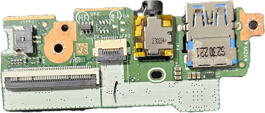

    Does no one have any idea where else I can look?
    My problem is that I can't start the laptop without the circuit board.
    Green: This is the power on button.
    Red: This is the defective circuit board.
    Blue: This is a ribbon cable going to the mainboard.
    Is there any adapter or way to run the power on cable directly to the mainboard so I can start the laptop?

      Have you tried repairing the board? What is the fault symptom? That PCB has several ESD protection components which can be removed if they are shorted (DS1, DS2, DS22, DS23).
