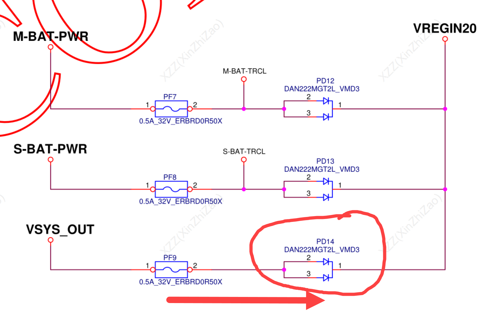

please help friend's thinkpad T480 NM-b501 dead, VSYS_OUT 9.2v, thank you
  • mon2
    • Dec 2019
    • 16628
    See attached.
    The issue is probably with the diodes in series. Investigate PD14. It is probably defective. Do inspect the resistance to ground of VREGIN20 and compare to the known good board.

    • fredyjbi
      • Feb 2021
      • 157
      • malaysia
      sir there is good news I replaced the broken PF9 now I have 10.2v on VSYS_OUT but the board won't turn on
      SYS_OUT 10.2v
      PL201 VCC5M 5v
      PL202 VCC3M 3.3v
      PL701 VCC1R0_SUS 1.05v
      ​PL702 VCC1R8_SUS 1.8v
      The board can't turn on yet, where should I investigate so that this board can turn on, sir, thank you

        Good. Have you attempted a bios reflash? I believe I have a flash image that can be posted if there is an interest.
        • fredyjbi
          • Feb 2021
          • 157
          • malaysia
          It's working, sir, thank you very much for your help

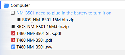

                      1) Have notes in my database that this board requires a charged battery to power on the logic board.
                      Click image for larger version  Name:	conditions.png Views:	0 Size:	19.4 KB ID:	3274622
