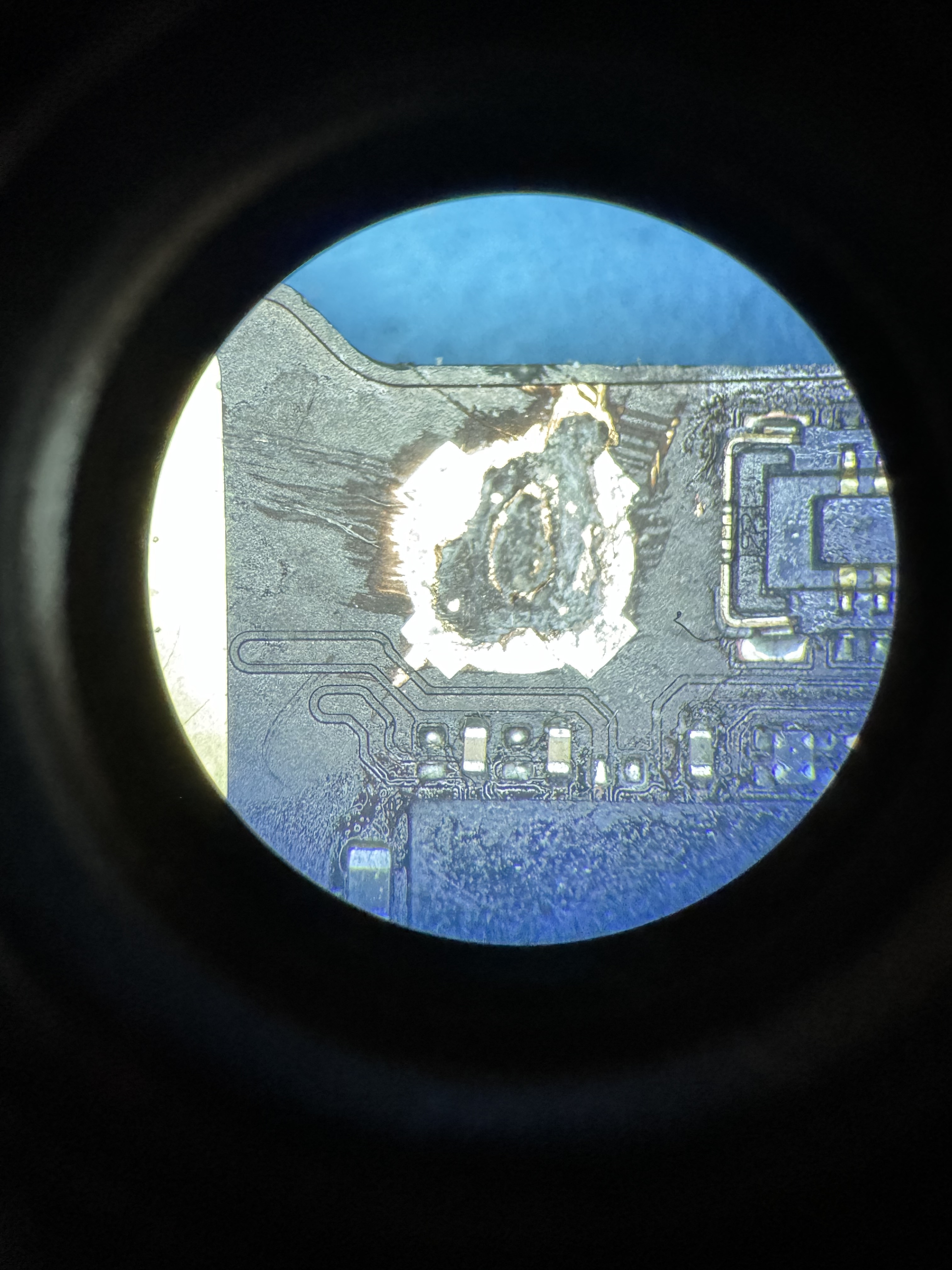

    Hi All,
    i got one Macbook a1534 boardnumber 820-00244 that is taking only 5V 0,2A
    I've tried to replace 3x CD3215B01 chip but it's still behaving same ....
    On the board there was blown L4804 so i've replaced it.
    when power is connected 5V 0,2A
    PPBUS_G3H - 0V
    PP20V_USBC_XA_VBUS_F - 5V
    I've tried to remove F7040 as mentioned here
    https://www.badcaps.net/forum/troubl...1534-820-00244
    but there is still no Voltage on PPBUS_G3H line ...
    I've checked and PPBUS_G3H is not shorted to ground ...
    I've checked with thermal camera and nothing obvious ..

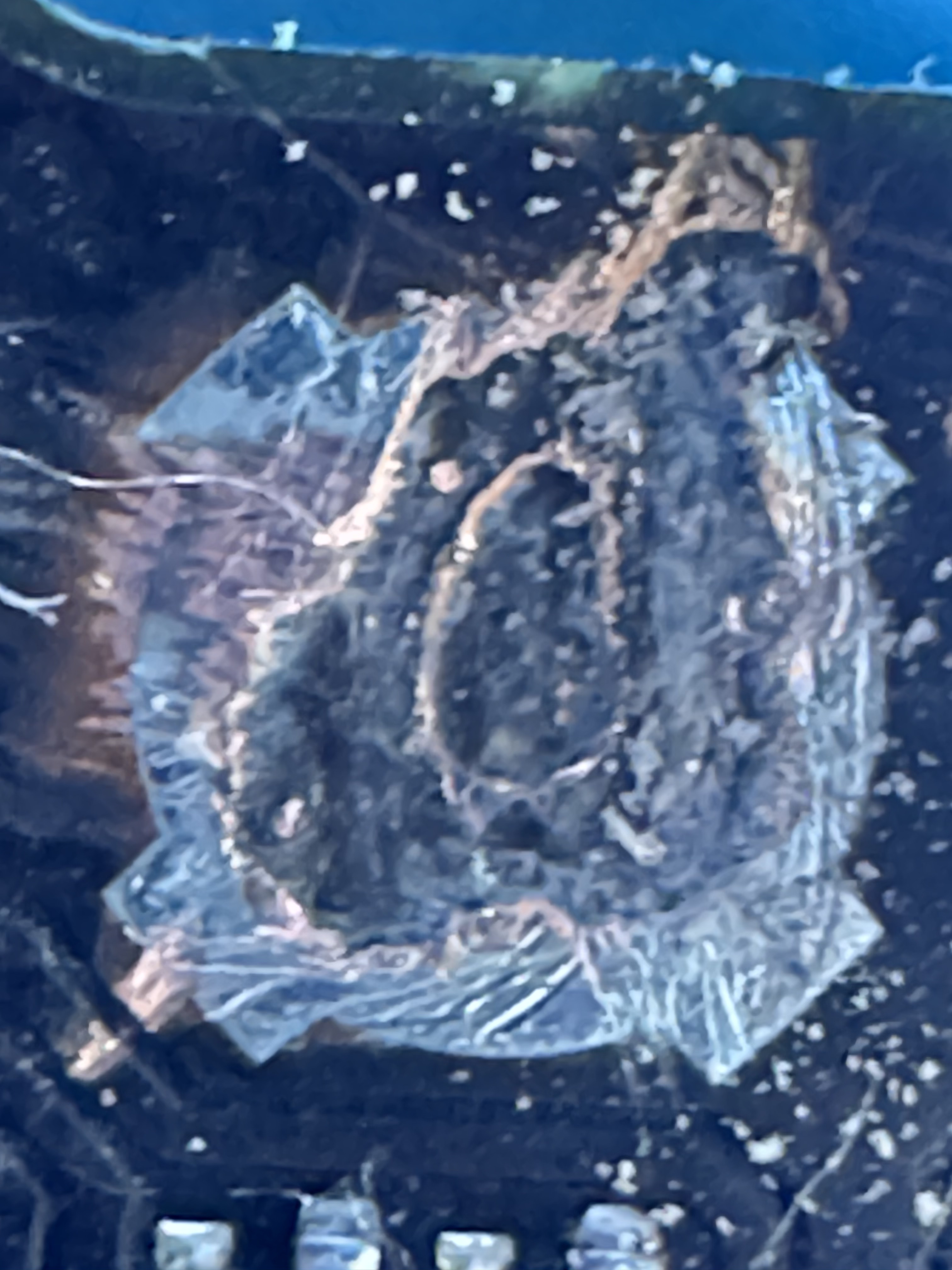

      and i forgot there is long screw damage see image.
      Resistance to ground is in Mohms and falling down

        I mean resistance when fuse is removed
        • kevingill
          • Jun 2013
          • 152
          • England
          What resistance to ground is on pin 1 of F7040 (PPVBAT_G3H_CHGR_REG)? Do you get a voltage on pin 1 of F7040?
          • obelix24
            • Jun 2023
            • 300
            • Slovakia
            resistance to ground on PIN1 is 4,1Mohms (mega)
            Resistance to ground on PIN2 is 5,7Mohms (mega)
            In Diode mode (red on ground black on pin :
            PIN1 : 0.624
            PIN2 : 0.435
            • obelix24
              • Jun 2023
              • 300
              • Slovakia
              Any idea ? Currently it's taking 5v 0a ... i'm out of idea what should i check ...
