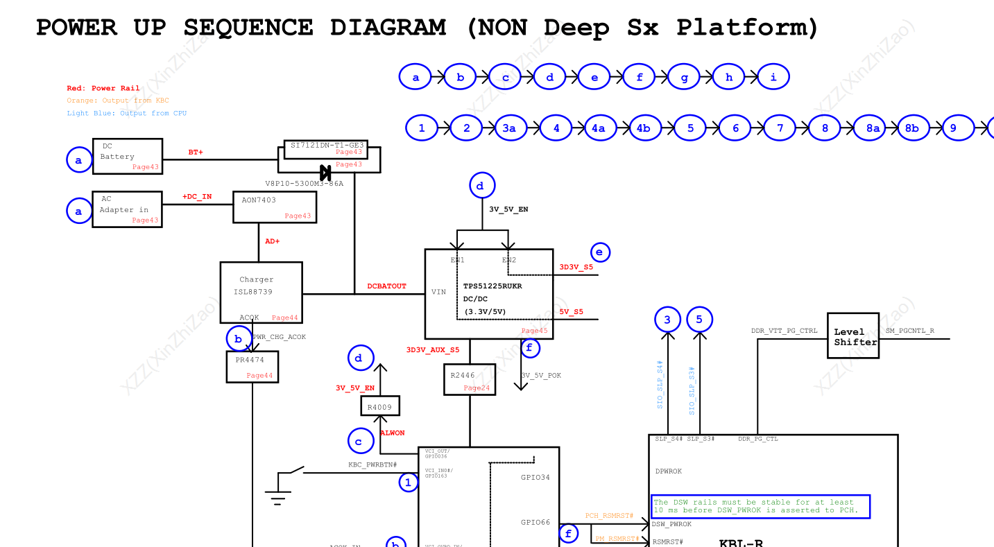

    Review the POWER UP SEQUENCE DIAGRAM on page 102 of the schematics and post where the first rail stops.

      This board is notorious for RTC issues. First check whether cmos battery is 3.3V and then check RTCRST#/SRTCRST#.
