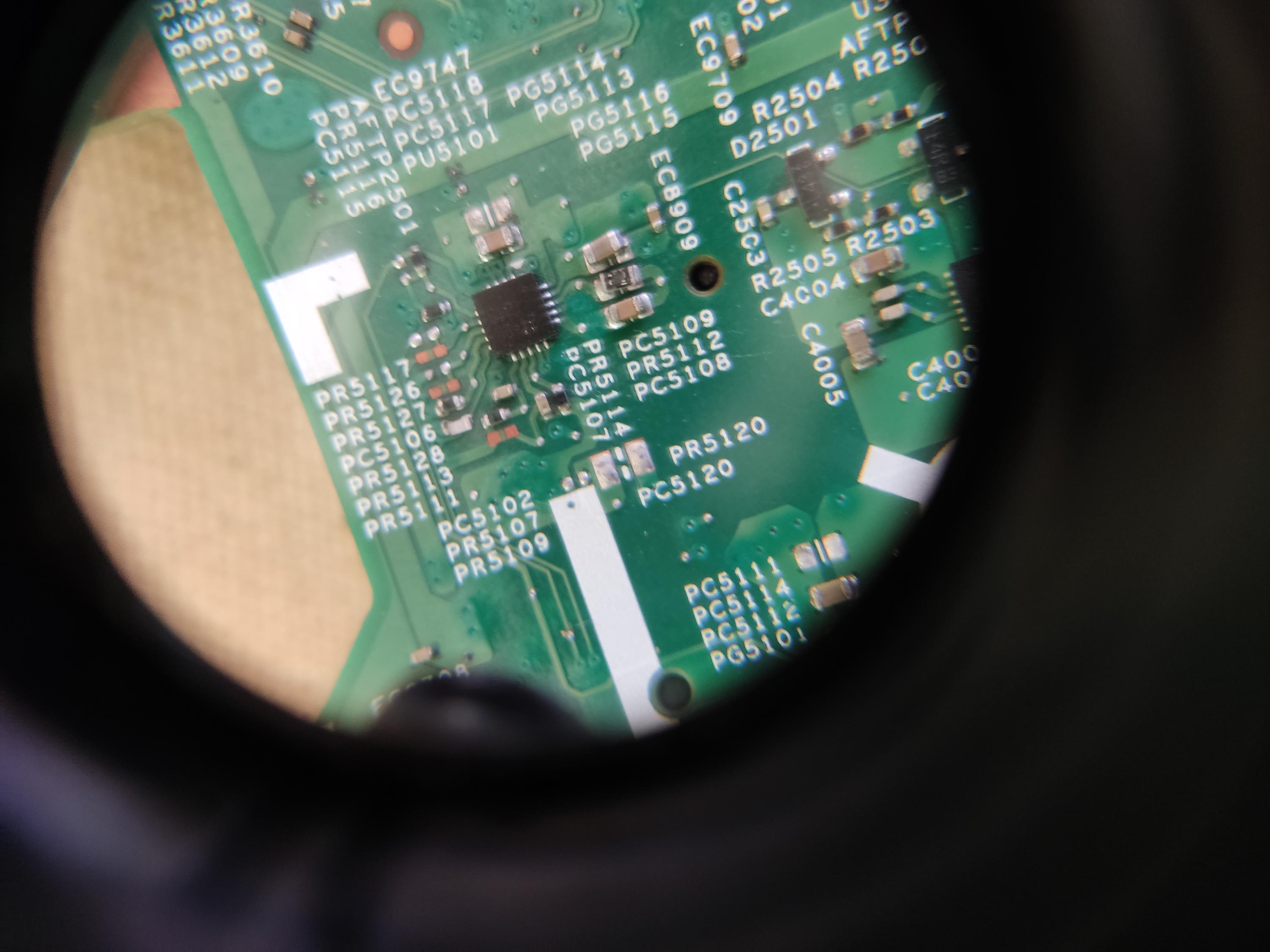

    Hello guys,
    I've got this motherboard with me that turns on when the charger is connected(without pressing the power button), the fan is fully spinning and it doesn't display anything. there is led flashing 3 amber 5 white. voltage readings are also weird, sorry I couldn't find the schematics for the board.
    Voltages are as follows,
    @ PL5301: 1.015V
    @ PL4401: NO voltage
    @ PL4501: 5.100V
    @ PL4502: 3.408V
    @ PL5101 near RTC: NO voltage
    @ PL5001, PL4801 PL4802, PL4701: NO Voltages
    Looking forward for your guidance on this.
    Ihave attached an image of the board
    PS: Consider me as a beginner to troubleshooting electronics

    Re: Dell Vegas/Turis MLK KBL-R 17841-1 WX2RR
    You can use 17831-1 schematics to troubleshoot as thats almost identical.
    PL5101 is for ram voltage and should be 1.2V. With no voltage on PL5101, you cant expect Vcore/gfxcore to come up. So the focus should be on PL5101 coil.
    What is the voltage on pin3-4 of PU5151/PU5401?? They are respectively for 2.5V and 1.8V.
    PU5101,pin7/8/9/11/12 Voltage??
    Measure resistance on all coils and post it here.

            Hey,
            I checked the PL5101 in both instances and the value is 0 ohms.
            I noticed that someone has already worked on the board and i think some components are missing around PU5101.I have attached an image.
            PC5109 connected to 19th pin of PU5101 is Shorted to ground. when removed and checked but the cap is not shorted.

                    • mon2
                      • Dec 2019
                      • 14476
                      Can you confirm how you are checking the short condition?
                      In resistance mode, select the lowest scale -> measure the resistance to ground. Post the reading.
                      In diode mode, RED meter probe - yes RED to GROUND. Black meter probe to the point to measure. What is the diode mode reading ?
                      If you are drawing this much current, there is a shorted part somewhere - is the CPU heatsinked ?
                      The cap you are referencing may be the silk screen for the EC controller IC. Can you post a picture ?
                      Do you have IPA (alcohol - pharamacy grade is what we use) - IPA will mist away with enough heat and that will be the part that is the issue.
                        Resistance to ground 0.002ohms
                        Diode mode 0.002v
                        Are these attached to 1.2v rail.? These are the EC caps I mentioned before.( Please see the attachment )
                        CPU is heat sinked. Removed the sink, CPU is not heating.

                            • mcplslg123
                              • Jun 2015
                              • 7262
                              • india
                              PL5101 consumer side(the side which is connected to cpu) is shorted and its a clear indication of shorted cpu part of SOC unless someone is lucky to find a shorted cap.

                                    • mcplslg123
                                      • Jun 2015
                                      • 7262
                                      • india
                                      Originally posted by Jmine
                                      Just want to clear this.
                                      Does the CPU always heat up when it is shorted? In this case it doesn't heat up.
                                      Theoritically yes it should heat up but keep in mind that the SOC is a large bga package and so wont heat up vigorously. It needs 1V/10A to even mildly heat up on this package.
