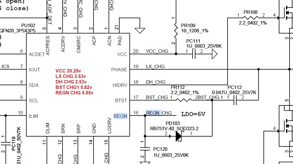

    Hi Guys, I hope someone can assist me me. I have a HP Probook G2. It came in for not charging. When charger plugged in power light on the charge port was flickering as well as the caps lock light. Not a pattern, but inconsistent. I found a faulty mosfet on the power input which I replaced. Problem I have is that it does not start up without a battery unless I use a 18.5v charger. It does however start with the 19.5v with the battery installed, but the battery charge voltage is 2.58v. The required charger for this unit is a 19.5v of which I have tried several. The battery is bad and have ordered another. I have stable voltage on the 3.3v as well as the 5v now, after replacing the mosfet. Any ideas?

Name:	Measured Voltages PU102.jpg
        Those are voltage measured on PU102

          ACPRES 3.38v
          ACDET 2.75v
          ACDRV is 7.45v
          Seems to be a BQ 736 Ti 471. A little difficult to read..

            Measure ACN, ACP, ACDET and ACPRES on the charger ic with both adapters. There must be a difference.
