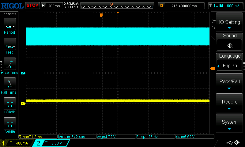

    Hello, I received this laptop with no power issue.
    Originally short on mosfets of 1D05V_PWR
    after removing mosfets I do not get the 3V LDO from TPS51225R(PU4502 3V/5V IC) (see on the attached image what I get in blue).
    I have replaced 2 times the TPS and same issue, the 19V line from the charger is steady, my undestand is that the TPS only needs the 19V to provide the LDO but I get that noisy voltage.
    I have cut the LDO trace coming out the TPS and same issue measuginr on the IC.
    Any help?
    thanks
  • piernov
    • Jan 2016
    • 4439
    • France
    Output capacitor is required for the LDO to work properly.
    Regardless, if there was a problem both on 3V LDO and 1.05V rails, PCH is probably damaged.
