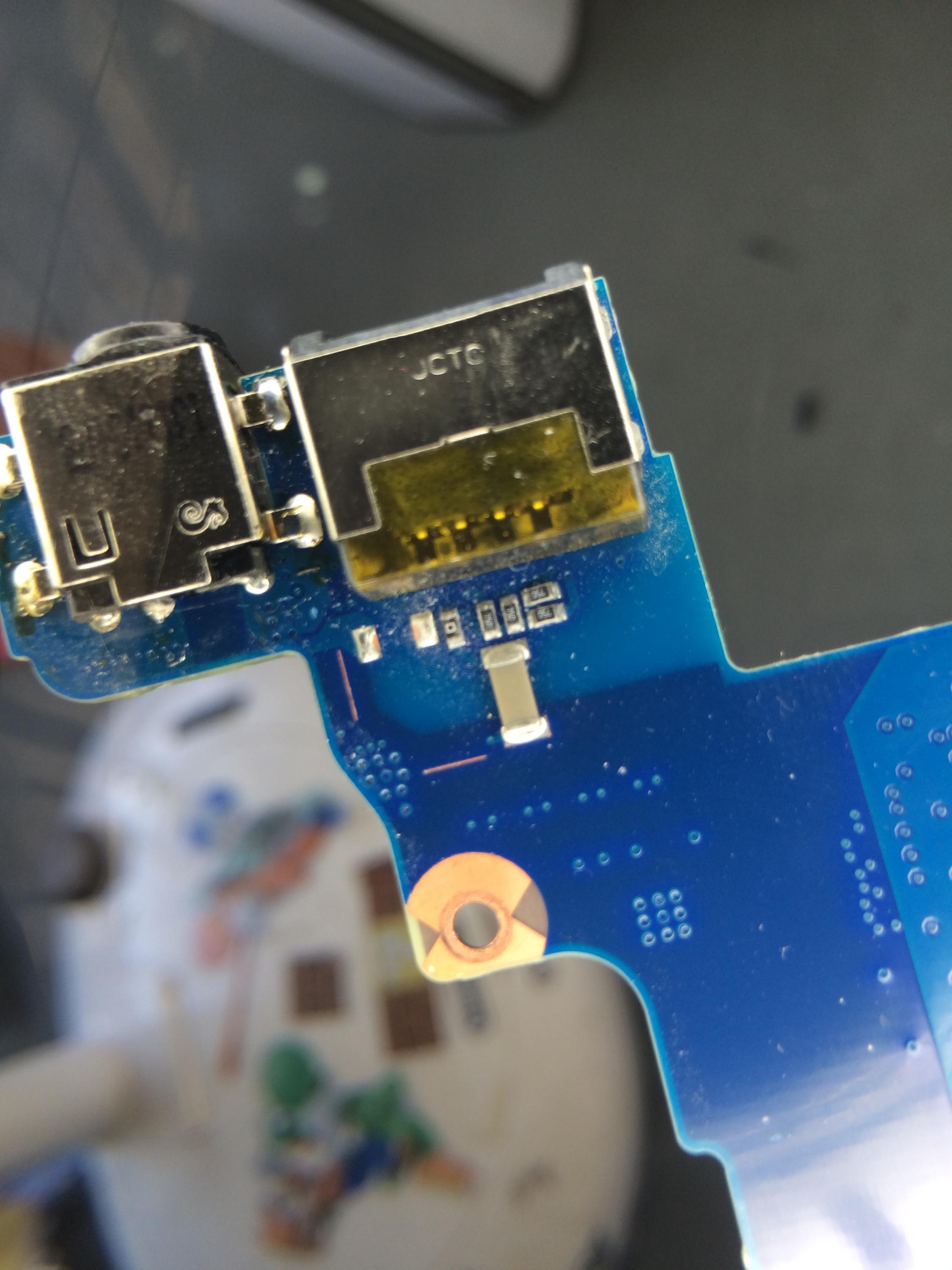

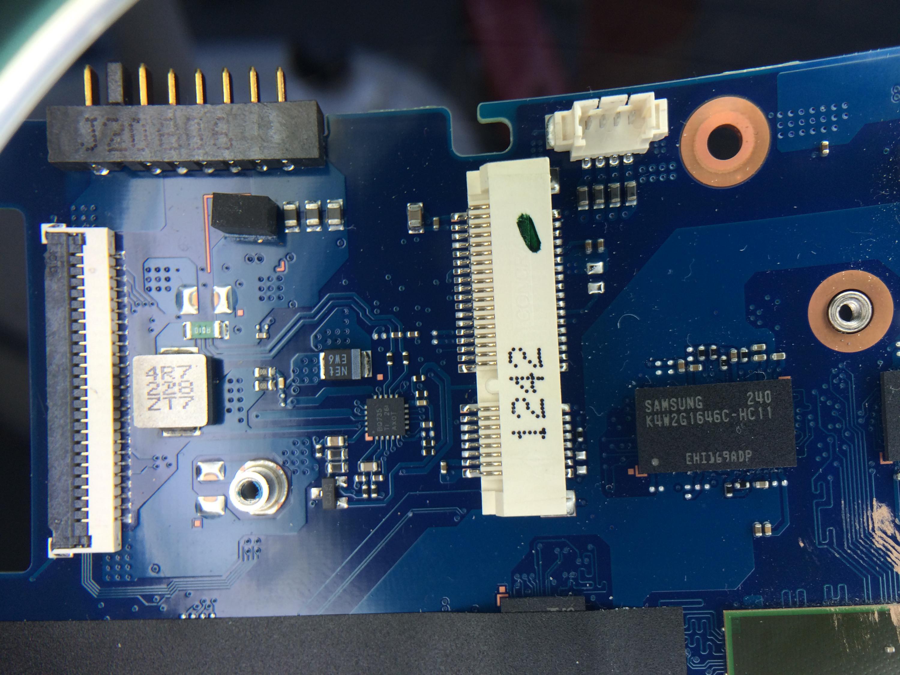

    Hi all I have a Np550 that I have in for repair with a faulty charging socket
    After replacing the socket, With charger in,the charging light will come on but the battery will not charge or turn the laptop on
    if I charge the battery on another laptop the laptop will power on !!!
    but if I insert the charger it will show it is charging but it doesn't it loses power until it go's off
    i will post a video as soon as i have uploaded to youtube

          post some pics( macro) of the board.
          find some chips like maxim; those makes the battery charge.

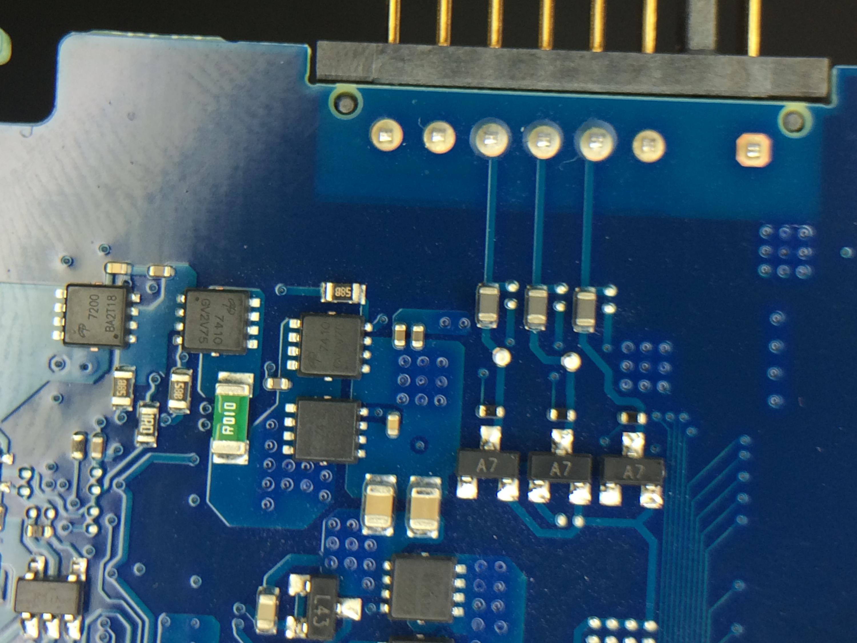

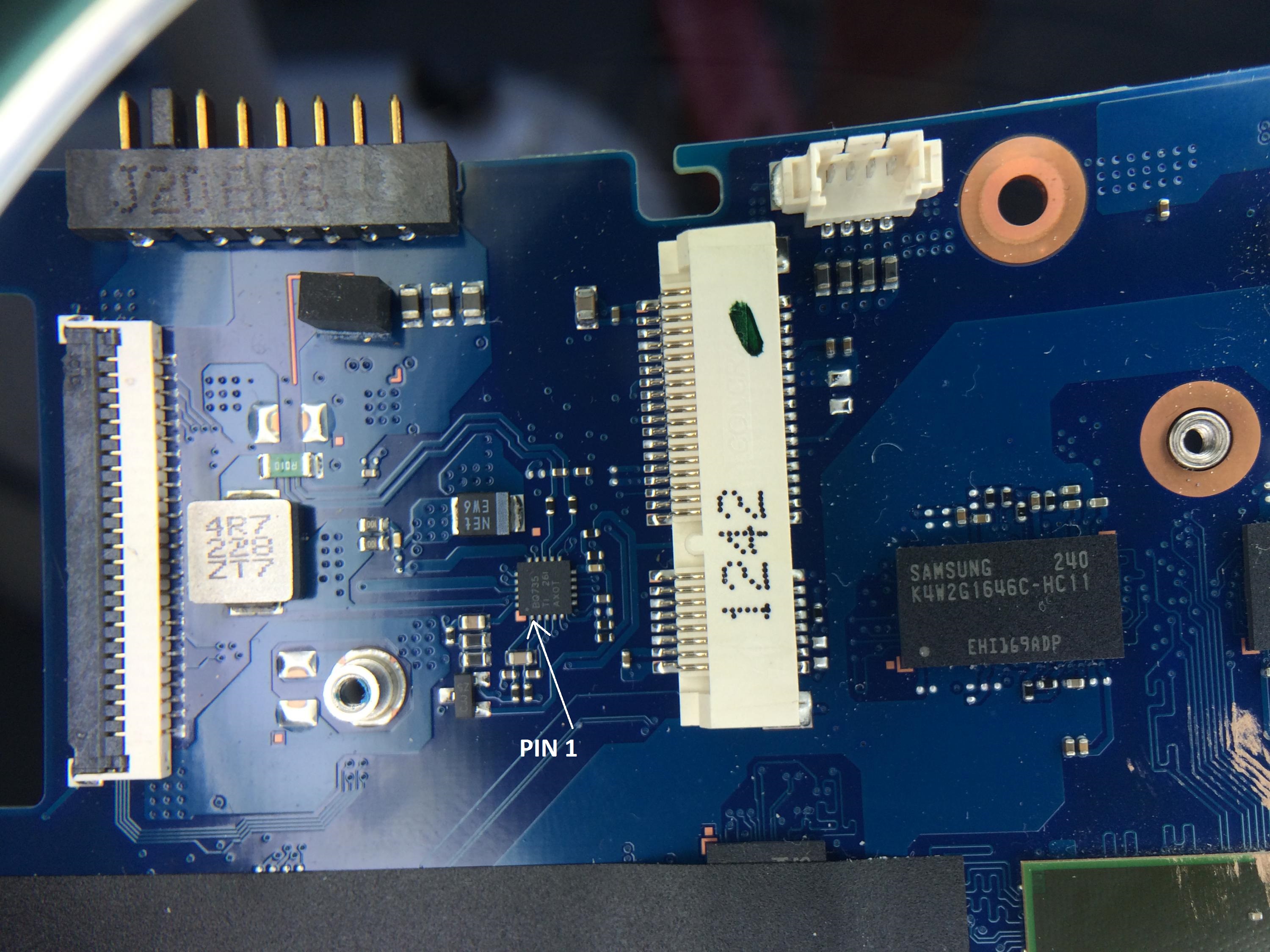

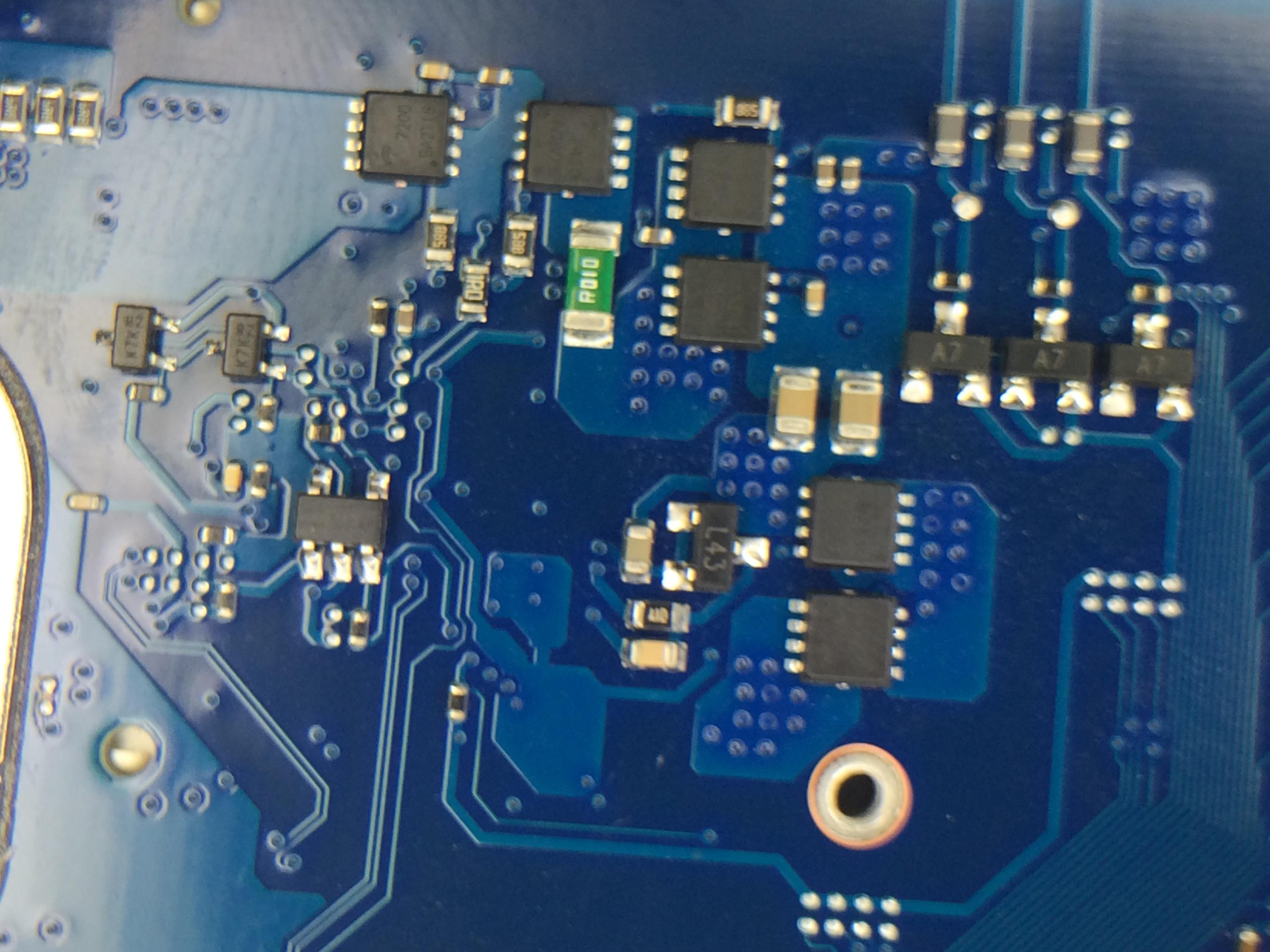

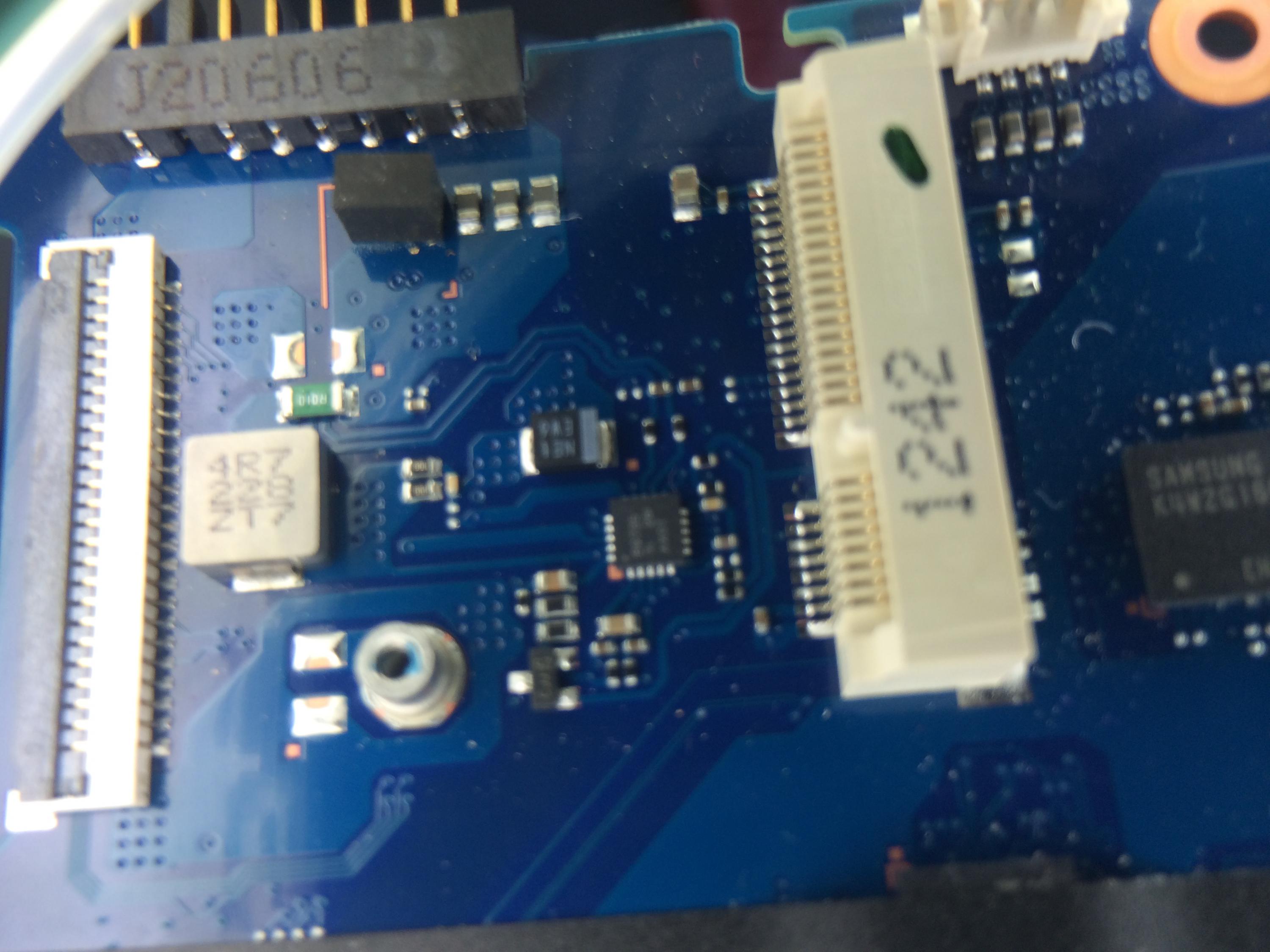

                Here are some photos sorry they are not the best

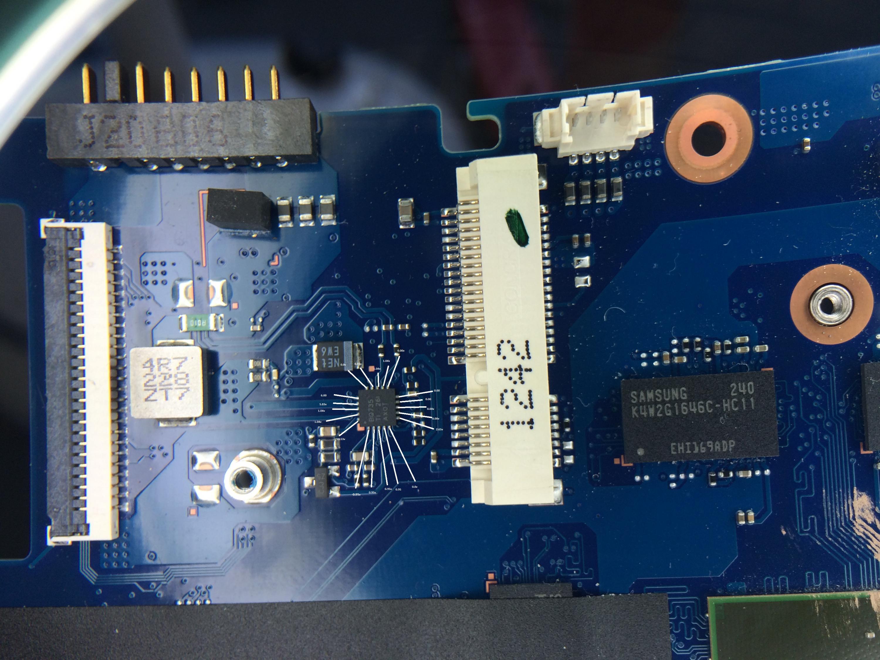

                  the pic nr 4 you see there BQ735 post the voltage from that chip.

                    Re: Samsung NP550 No Chaging
                    on pin 1 with battery & charger in but laptop off 11.81v
                    pin 1 no battery just charger and laptop off 1.08v
                    with battery in and charger removed laptop off 11.8v
                    thanks steve

                      measure all the pins plzzz
                        all with psu in and no battery
                        • ukdirtyboy
                          • Aug 2012
                          • 27
                          • uk
                          voltages on photo above

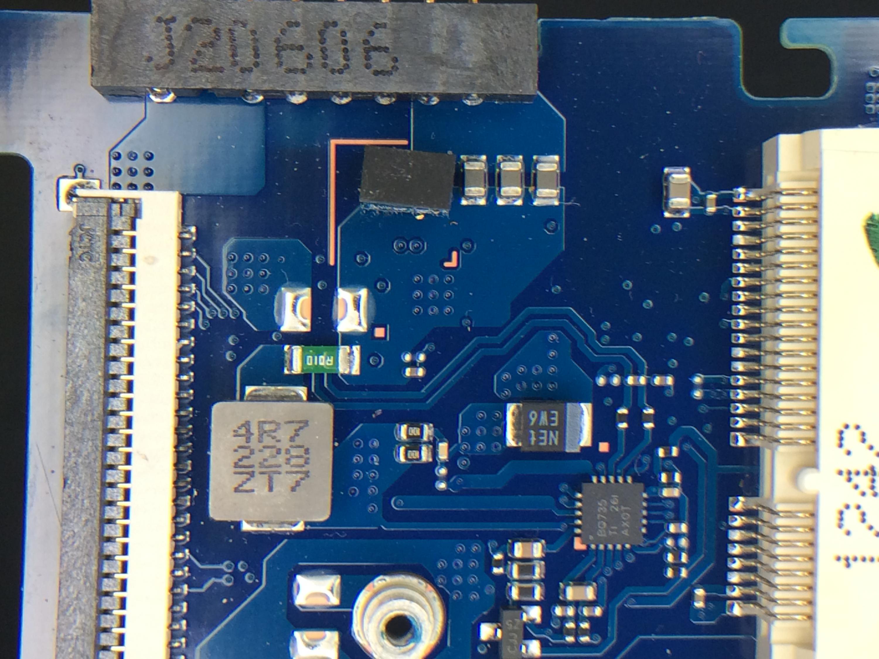

                            you need to trace from the power pin(V+) to this chip maybe something its culprit
                              the pin to the left of pin 1 is at 18.5volt and a resistances of only 590 ohms from the V= on the dc socket

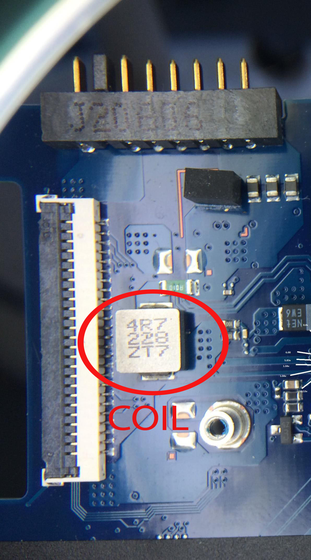

                                  If you could find a schematic that would help.
                                  Just for my curiosity could you measure the voltage at the coil. With Battery in/without AC, then plug in your AC and measure again.
