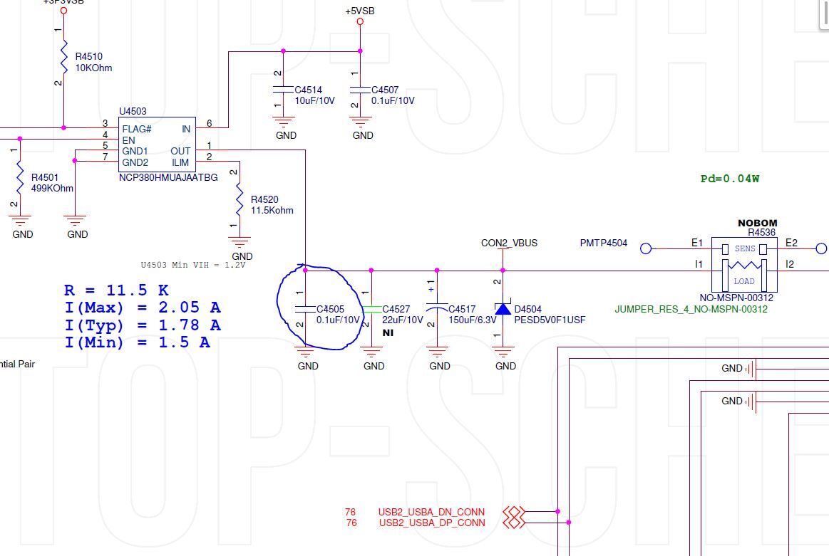

    After my Surface Laptop 4 was rejected by Microsoft repair due to an alleged water damage. As a result, I've decided to tackle the issue myself. Unfortunately, after a use involving a self-soldered USB board, the USB port (not USB-C, which still works) is no longer functioning.
    Now, I suspect that a short circuit may have damaged something on the motherboard. I've checked for any visible damage according to the schematics but couldn't find any. So, I decided to check if there's any voltage on the Vbus. Sadly, it's reading 0V. I've traced the supply and came across the NO-MSPN-00312 controller. Initially, it has a 3.3V input voltage, but there's no output voltage anywhere. Now, my question is: could a faulty ic be the cause? The IC has a 'SENS' circuit as well; what is this for? Could anyone provide a hint as to its purpose?

    If there is no short at the output and you have the input at +5v then the usb load switch at u4503 is defective. Review it but it should be replaced. You will need proper tools + flux + some experience on another board before attempting this replacement. Or ask your local phone repair shop that can handle board level repairs.

        on USB VBUS i have 0 Volts. so after the ic i havent any Voltage. Only on IC input.
        No short here. :/
        have to reverse my measurments.
        I have this chip: NCP380HMUAJAATBG
        https://www.mouser.at/datasheet/2/30..._D-2317053.pdf
        Its U4503 on Shematics.
        On Input PIN 5 i Have 5Volts.
        Output PIN 1 is 0V (No short to Ground),
        On En PIN 4 i have 1.8V
        on SIDE GRound Pin 5 I also have GND
        and on Flag PIN 3 i Have 3.3V
        SO i Have no Output.
        The 3.3V should say me that there must be a problem on putput right?
        • Vanillaboard
          • 15
          • Kärnten
          short to ground.
          Maybe this s the issue? i desoldered t but still have 3.3V on FLag Pin.
          The short on output is not present Anymore.

              i did have short. I was wrong in the first measurment.
              So i desoldered the Kapasitors first but no solve. after i disoldered u4503 and short is gone.
              as you said i need replace this.
              Thanks for all
