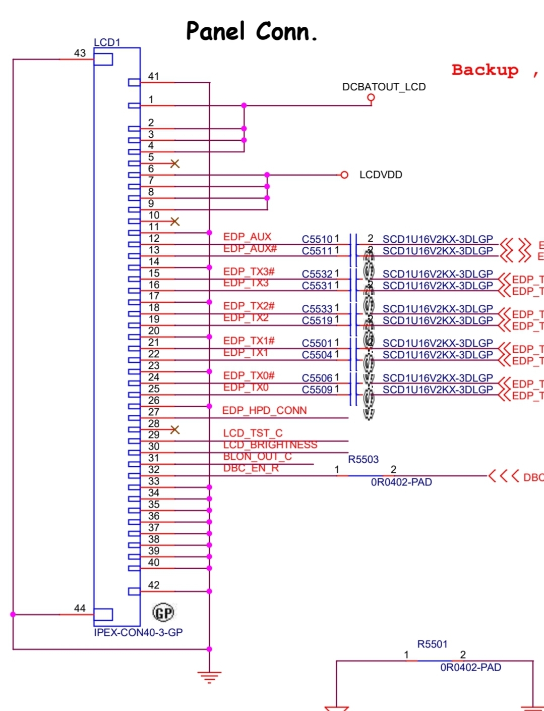

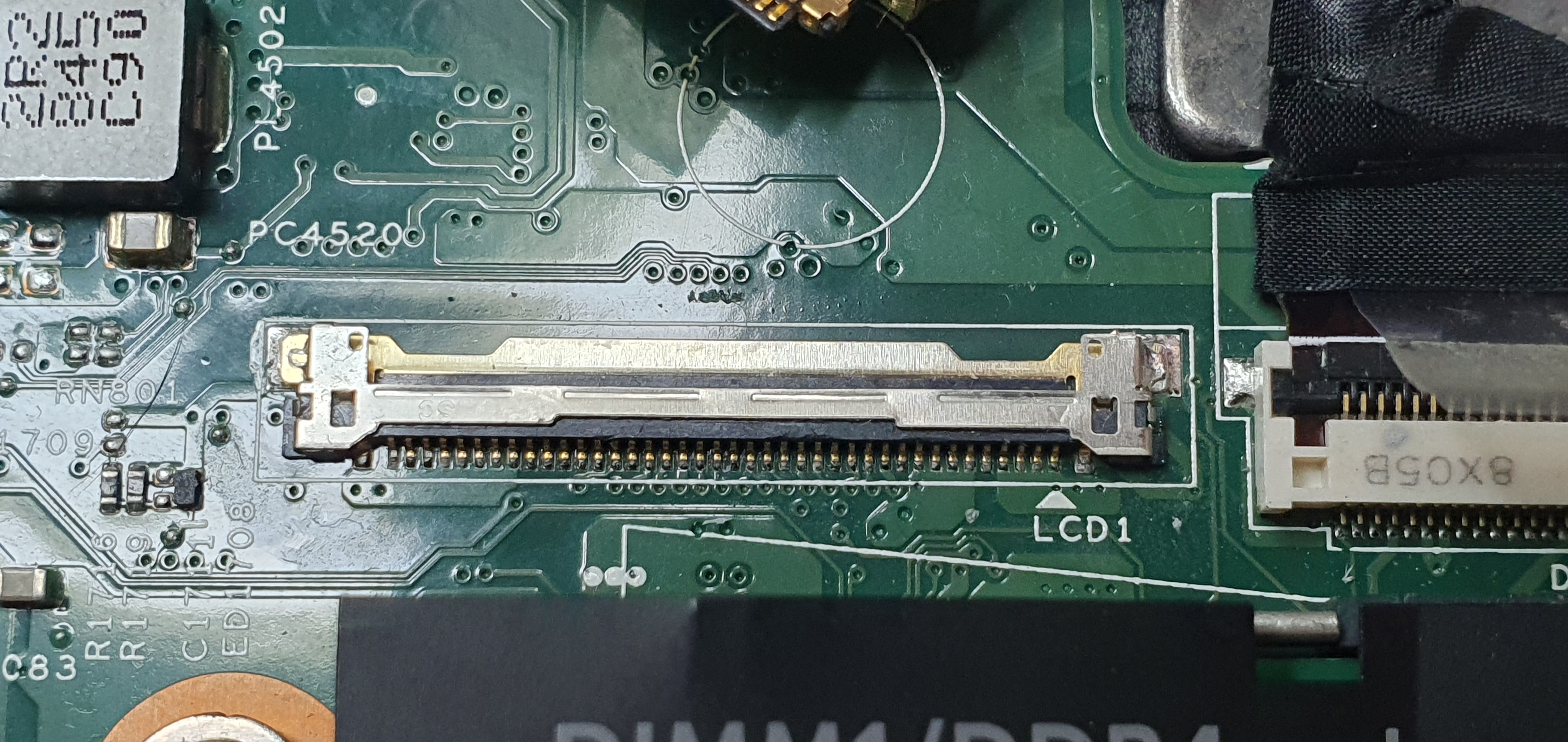

                Sounds like "Backlight: Yes, Picture: No". Which is neither a expected nor a good outcome.
                share a clear picture of the connector on the mainboard, without cable plugged. Don't forget to remove all power before unplugging the cable.
                Then connect the display cable again and look for voltages at DCBATOUT_LCD, LCDVDD, BLON_OUT_C and LCD_BRIGHTNESS

                  Hello!
                  DCBATTOUT_LCD 19v
                  LCDVDD 3.3v
                  BLON_OUT 0v (not sure if i measure the correct number 30 pin so i measure all around, all 0v)
                  LCD_BRIGTHNESS 0v too

                      #30
                      No BLON_OUT is likely the issue here. Make sure RN5501 is not internal shorted and that D5503 has not failed too. Clarify whether R5512 is present on the PCB and measure resistance to GND of RN5501 Pin 2 & 7 and of D5503 all pins.
                      Could be EC fault with some luck or something missed from visual observation.

                        #31
                        No shorts on RN5501 and D5503, checked all combinations.
                        R5512 not present.
                        RN5501
                        pin2 to GND 10KΩ
                        pin7 to GND 18.3ΚΩ
                        D5503 to GND attached

                                  Update for 3390 owners.
                                  After some months today i reveived a fully working 3390, i tried to trace the source of the problem and i swapped motherboards, in my surprise my mb was working great, so i decided to disassemble screen, then i noticed the LVDS cable on the screen was half way unpluged, probably due to the 360 rotation screen, i firmply plug it and now it's working great.
                                  Then i disassemble the customer's fully working 3390 and the LVDS was there unplugged too but was making contact and still working, i firmly plug it too.
                                  Verdict: LVDS screen cable from 3390 2 in 1 are getting unplugged on it's own, check it before order screen or motherboard.
