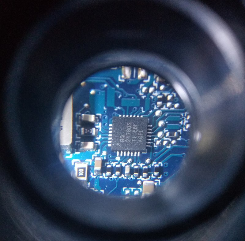

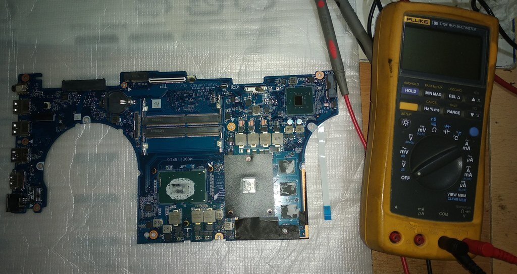

    I have ASUS FX504G not charging, it stoped after dead battery, bios battery dead also.
    same board DABKLGMB8D0 REV
    My checks following kind indications on this topic seems to indicate BQ24780S and PQ21 PQ22 need replacement,
    can you help me for diagnostics please ?

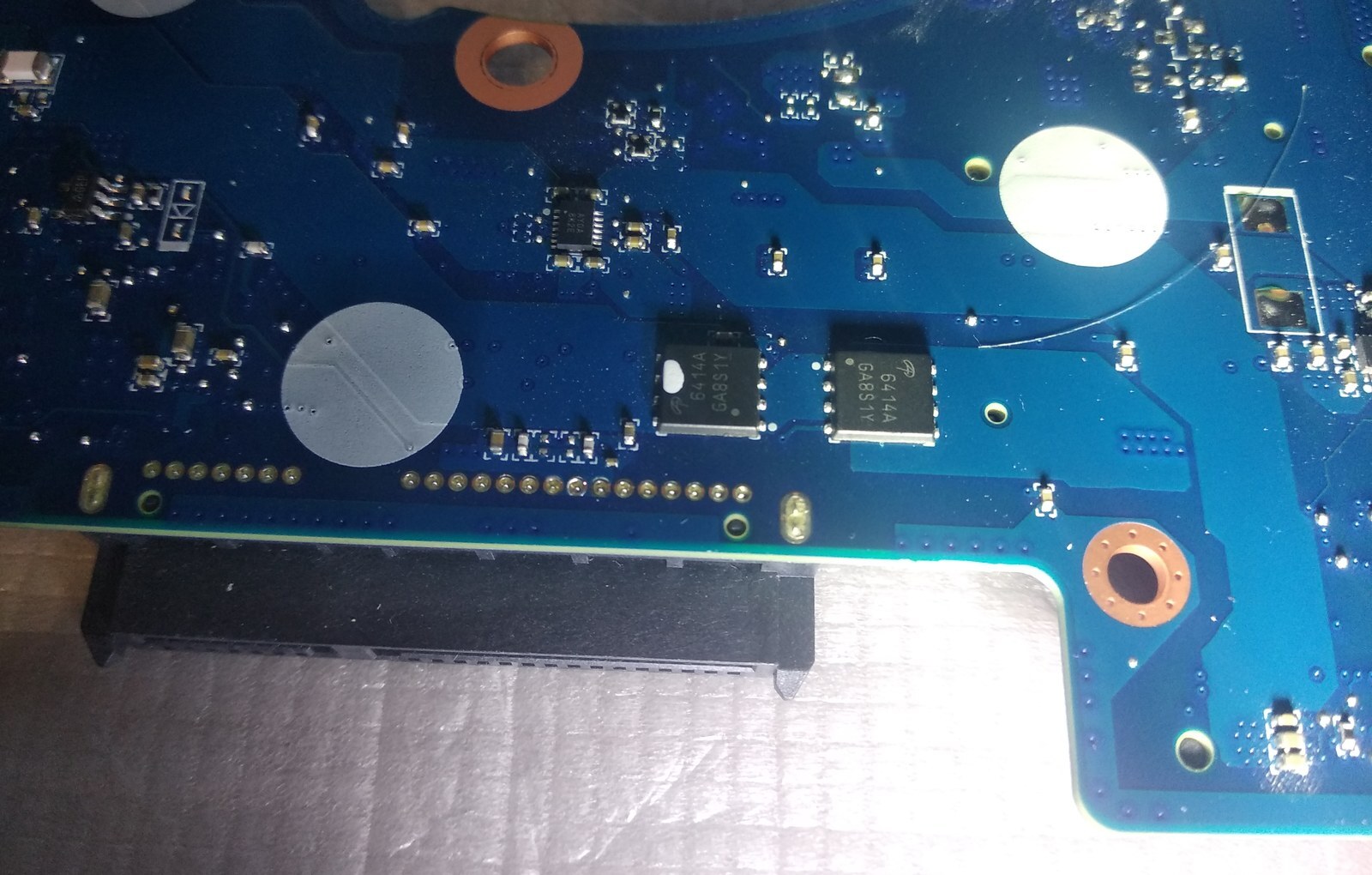

    Power supply rail entrance mosfet 6414A and the 2 others smaller mosfet near R010 shunt resistor have no short to GND
    R010 shunt resistor to GND is 180Kohms and climbing
    inductors arround CPU are steady about 4ohms to GND
    PQ22 has pins G to S shorted (0,4ohm) D to S = 544ohms
    PQ21 has pins G to D to S shorted (0,2 to 0.4ohm)
    P-CLK on PIN 4 battery connector to GND is 47Kohms
    REGN PIN to GND is 211Kohms, is this too high resistance ?
    ACDRV to GND is 114kohms, is this too high resistance ? > so charging IC BQ defective ?

    Hello. The resistance values are high and a good thing to confirm that these pins are not shorted to ground.
    Suggest to source another known good battery and test again. Amazon?
    Do update this thread.​

      what do you think about shorted gates of PQ21 and PQ22 ?
      • mon2
        • Dec 2019
        • 14199
        Agreed that these look incorrect for their resistance. Carefully flux and remove pq21 and check its resistance after it is cooled on your work table. Then check if pq22 resistance is high on the board. It is possible that one or both dcin mosfets are defective.

                      measurement out of circuit PQ21 (for eference: test leads shorted 0,2ohm)
                      D to S 0,34ohm
                      D to G 0,65ohm
                      G to S 0,54ohm
                      fautive
                      incircuit PQ22
                      D to S 3,1Megaohms or OL
                      D to G OL
                      G to S OL
                      after ohm test G to D, D to S switches ON with 0,26ohm
                      short circuiting G to S, block the mosfet again...
                      seems ok though very sensitive little thing
                      i ordered mosfet replacement CSD17578Q5A for PQ21 and PQ22,
                      seems to me better to replace both.

                        some bad news
                        fter soldering 2 new PQ21 PQ22 mosfets i checked and no more short circuit but no change.
                        At connection power supply goes immediatly in protection mode to 0V, i tried also without battery same result.
                        seems other compoent is defective, BQ24780S ?
